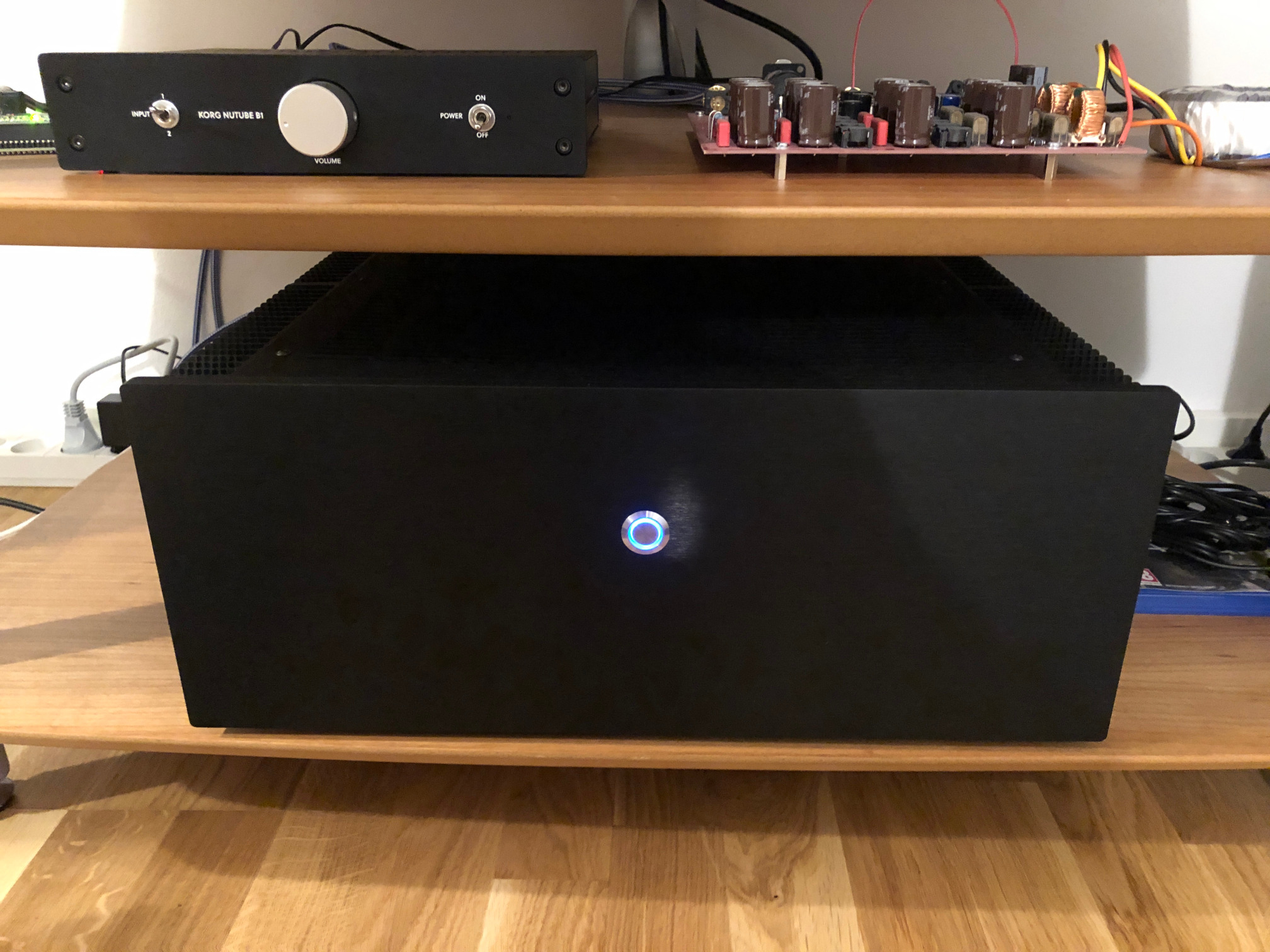

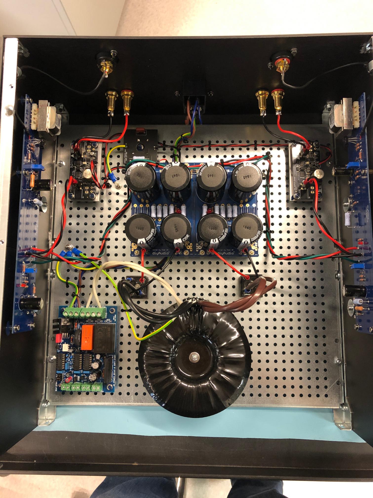

Built with 6.0 V Zener and R7/8 = 3k32, R11/12 = 110R and IRFP150 in the output.
In a 4U 400 chassis.
Mark Johnsons softstart and XRK DC protection in the output.
It sounds absolutely wonderful paired with the B1 Korg - it has been playing for 1 and half week and it is just... wow...
A few photos are attached 😀

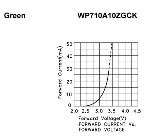

Using Green LEDs with higher voltage drop...
2 picoDumbs,
Looks like there are "Pure Green" LEDs with 3.2V voltage drop?
https://sg.element14.com/cree/c503b-gcn-cy0c0791/led-green-t-1-3-4-5mm-12-5cd-535nm/dp/1855512
If that is the case, I can do with 2x of these vs 3x of standard Green LEDs with 2.1V forward voltage? I ask because the Tea-Bag boards have space on the PCB for 2 LEDs; of course a third unit can be accommodated by DIY.
Any experience with these Green LEDs with 3.2V forward voltage?
Anything over 5.5V should be adequate to bias up the mosfets.
You can change the resistor values - anything between 3mA and 8mA will be certainly functional.
You will get better performance with higher currents though eg 7mA.
You will see I recommend using 3 green leds but you could also use 3 red leds

Looks like 3.2 V at 20mA.
Check the data sheet for 5 mA to 8 mA operation.
I have never used them so can't comment.
The ones I recommended are guaranteed to be extremely low noise.

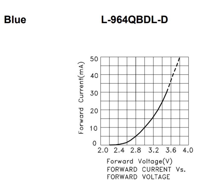

Pico,
Thanks for the guidance. Even with the Blue LEDs I have in place, looks like I am having less than 3.2V drop as I am operating at lower MA.
Let me check if I can find a similar graph for Green LEDs.
p.s. Found the datasheet for a suitable green model - this actually shows steeper drop with increasing mA, so possibly better choice in this application.
Missed this one earlier - not sure if you have recommended any specific type of LEDs. If not, would welcome your inputs.
