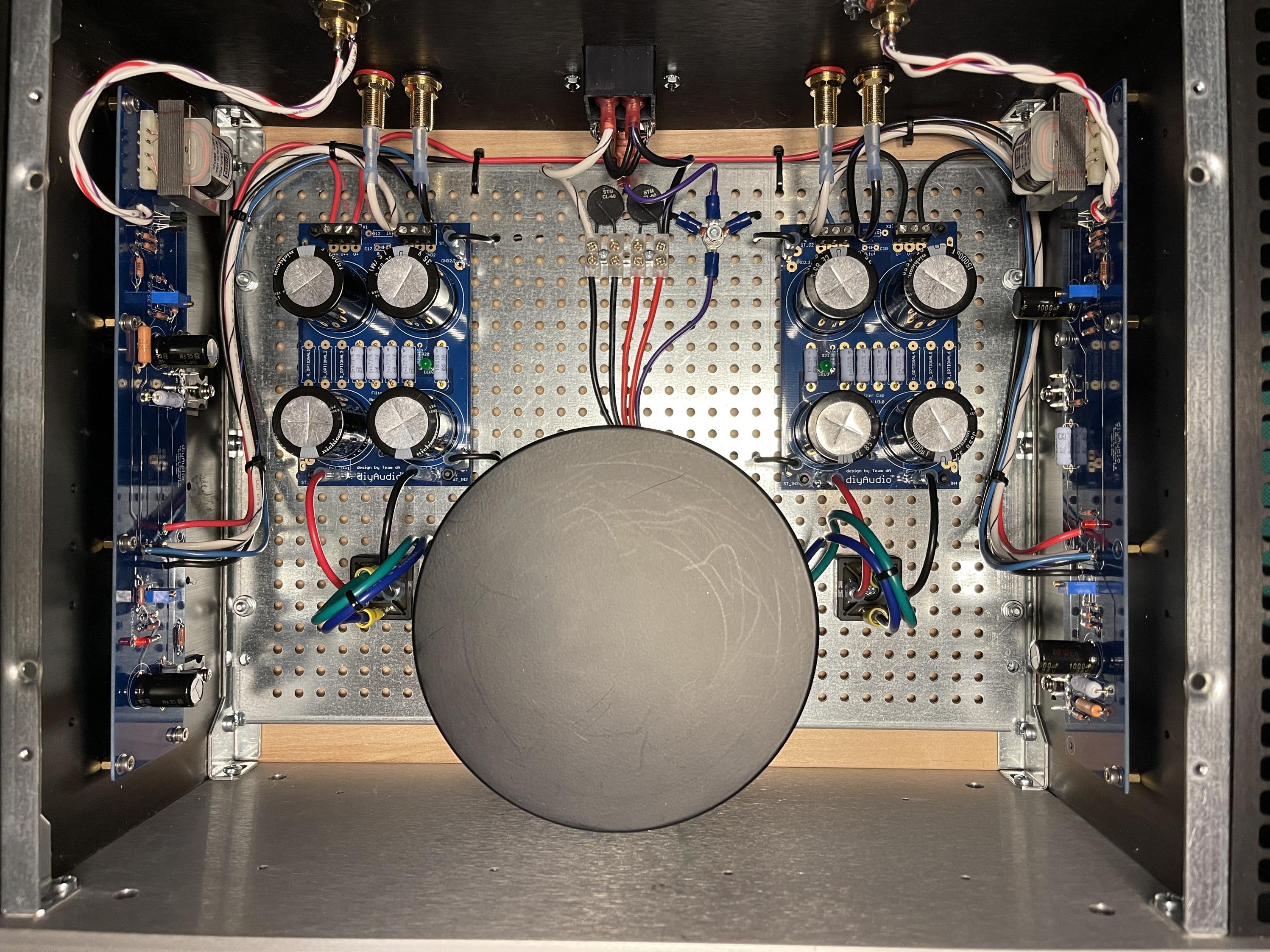

@bbm3 - Hang on! I rarely chime in with my lack of knowledge, but I assume you've checked your PSU voltages. If not, do that before changing anything. The wiring specifically related to the CL-60s and primaries looks OK to me based on a standard dual primary Antek transformer and 120VAC mains, but I may have missed something. Looks like your CL-60s are wired between the two hot and two neutral per the schematic for 120VAC mains. That doesn't rule out everything, but again, I assume you checked your PSU. If you have, then move on, if not stop and wait if you're not 100% sure of what to do next based on mine and previous comments.

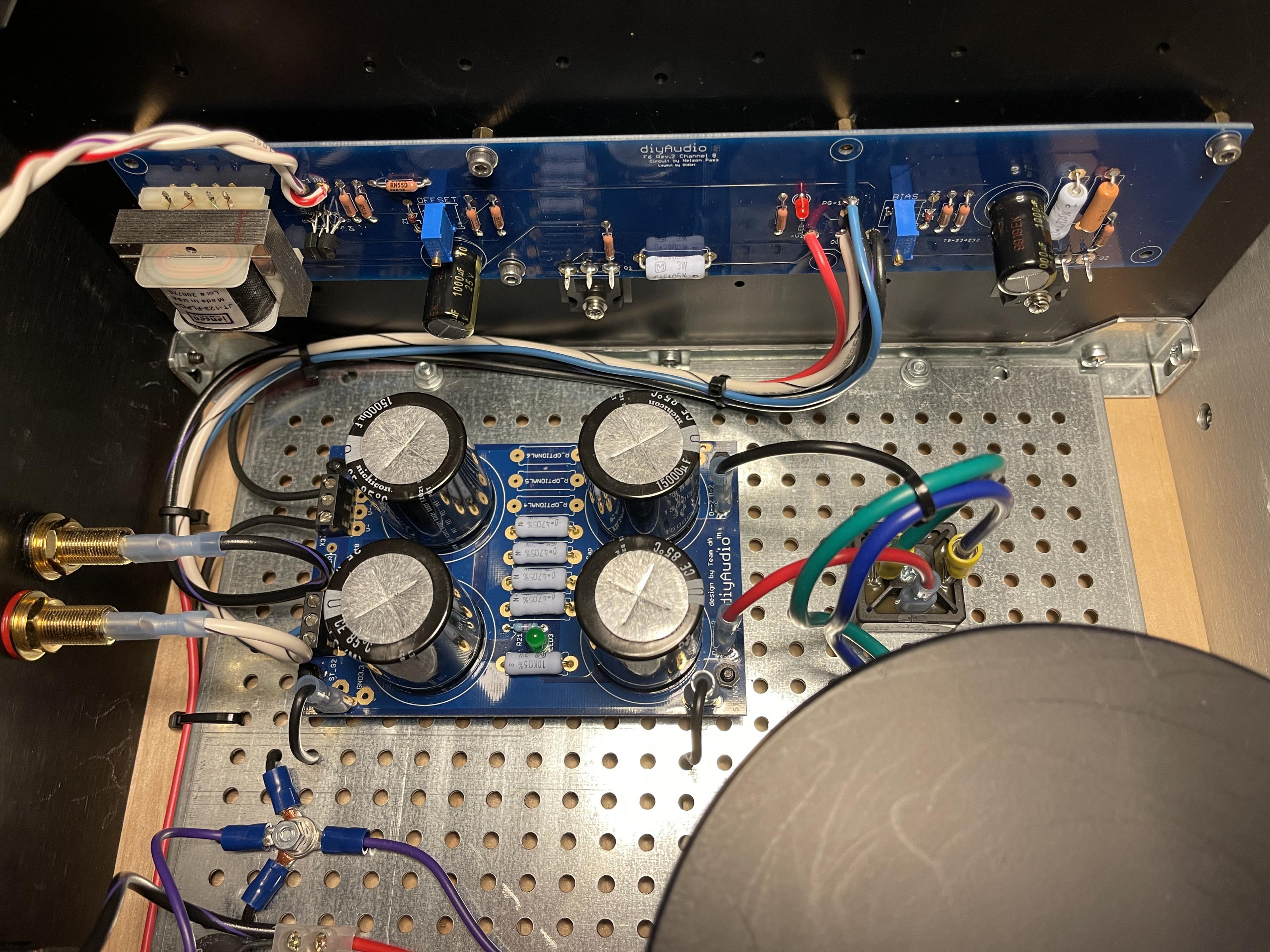

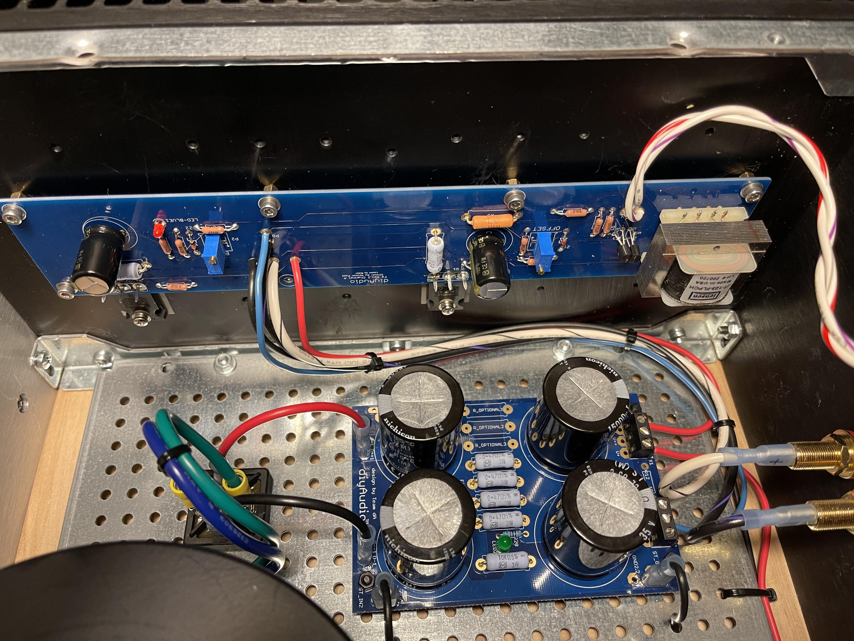

I don't see any stuffing errors on the amp boards, but some areas are not clear in the pics, and my eyesight is not wonderful.
Have you turned P2? Did you intentionally turn P2 all the way or partially one direction before installation b/c of the notes in the build guide that bias may be too high at P2 mid-point?
I'd wait for others to chime in, but if my PSU was working properly, and if I had checked my amp boards for obvious stuffing errors and used a DBT to check for shorts; I would turn P2 until Q2 turns on indicated by seeing voltage across R2. I'd start with clockwise. If I didn't see it turn on when I turned P2 in one direction, then I'd turn it the other. If the pot went to max turns in both directions without any current (or not enough) through R2, I'd report back. Depending on the level of success, zeners and/or values for for R11, R12 may come up.

It did work the way I had it but the CL-60 was only limiting one input. I tied Both red leads together and both black leads together and removed the CL-60 on the neutral side much neater and how it should have been.
The real problem is I had to turn P2 way more than I expected in order to begin seeing voltage across R2. Now I have P2 turned to the limit and I am only seeing 2.45V. I will move on to offset and watch what happens to the bias.
