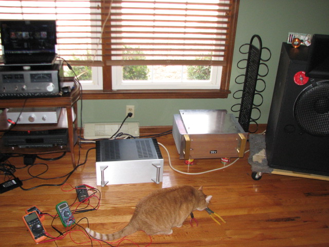

Note to self...not discharging hefty power supply after testing will cause large flash when cutting V- & V+ leads.....😛 Stop building as tiredness sets in is the rule for me, along with cut one lead at the time......Good thing I wasnt disarming a bomb. No damage done. Should be doing final wiring and biasing up this evening.
Russellc
And your cutter is gone I guess...
My favorite exolite now has a small notch in it that must be avoided to clip wires. Time for a new set...I really liked those.

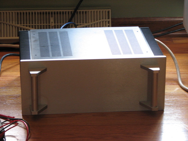

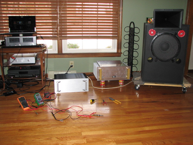

Oh well, F-6 is all wired up now. since I assembled the boards way back when they and the transformers were first in the store, they have the old specified zener and resistors. Bias set to .530 both channels, 3 mV offset steady as a rock.
Tried them briefly with computer speakers and B-1, played music with no noise or hum. only odd note thus far is the LEDs, one just bearly has a glow in there, and the other is hardly any brighter.
Deluxe 4U case only slightly warm at .530 bias, mosfets measuring right at or just over 40 degrees cent. (according to my laser temp gauge).
Be checking it out in the am.
Russellc
Playing nicely now in living room setup, silent as can be, no noise, hiss hum, nothing. Letting it break in for a while. Transformer is a 500 VA 18 + 18 Antek.
