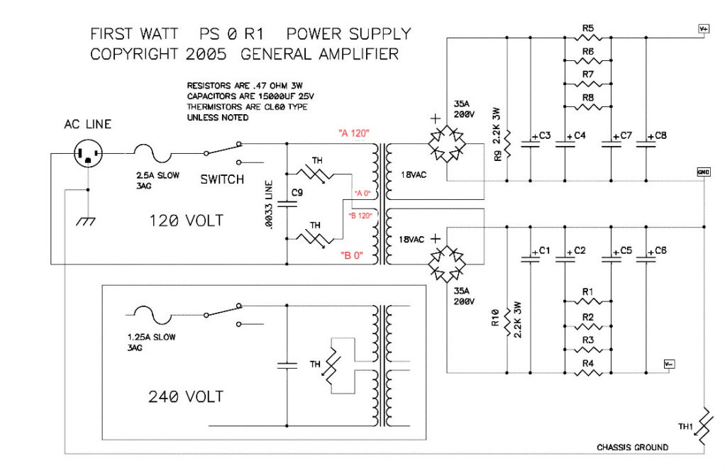

So these cl60 's are the soft start?
Bare,
Look at the bottom of the page linked below:
Design Notes and Efficiencies | Plitron
The section called Inrush Current explains the need for the soft start. This type of technical note is available from many transformer manufacturers. Here is another example.
http://www.avellindberg.com/transformers/tech_notes/tech_notes13.htm
I put a soft start circuit on my Aleph J, and it seemed appropriate since I upsized the transformer to 400 VA. (this is consistent with the Plitron writing)
Considering staying with 300VA for the upcoming F6 build. (using the Nelson Pass circuit as drawn) The momentary switch circuit PCB I obtained has the soft start on it, and I will probably use it too, although a couple of thermistors sure looks simpler and cheaper.
