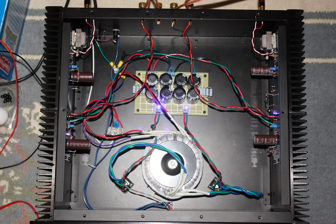

I decided to try a PSU without a PCB this go round. I got some capacitors with screws, and plan to stand them up after the bridge rectifiers. Gets harder if you want to put a snubber in. Adding a bleeder resistor and LED+resistor is a must IMO.

I'll use the Schematic and fit it onto cheapish perf board.

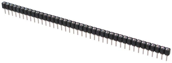

Desoldering is difficult, yes. Put some pins with female openings in that position and swap zener until you find your right value, like this -Removing soldered in bits always seems to mess the thru plated holes (in the least)

I haven't seen the sockets Jim used, but you should be able to find machine
pin sockets like the ones in the attached picture.
