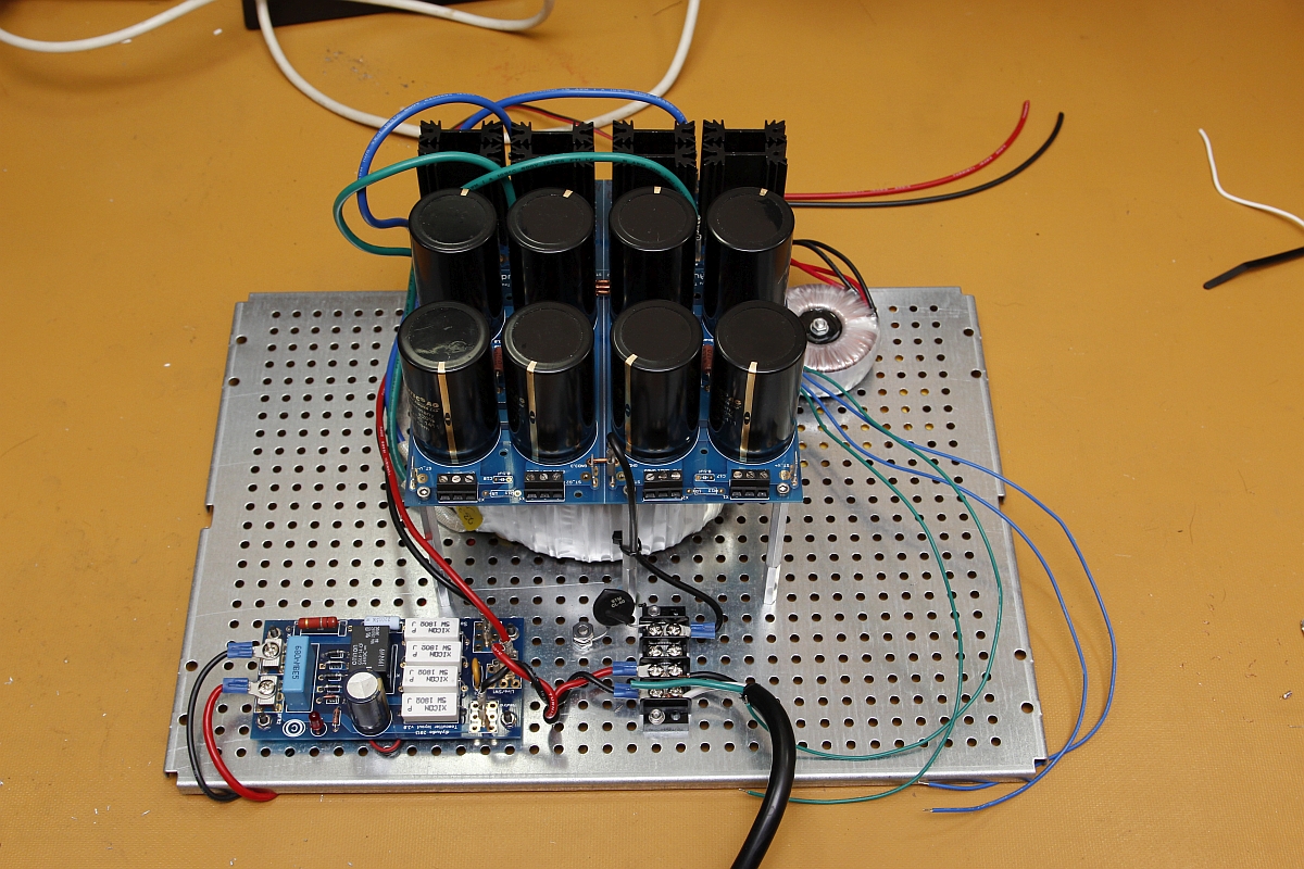

Transformer ? to order.. 400va is adequate to needs? (18v part I understand)
I have 93db speakers, not too many watts needed for my usage.

Yes that's fine. (The standard transformer in the First Watt amps
is a 300VA 2x18VAC Plitron.)

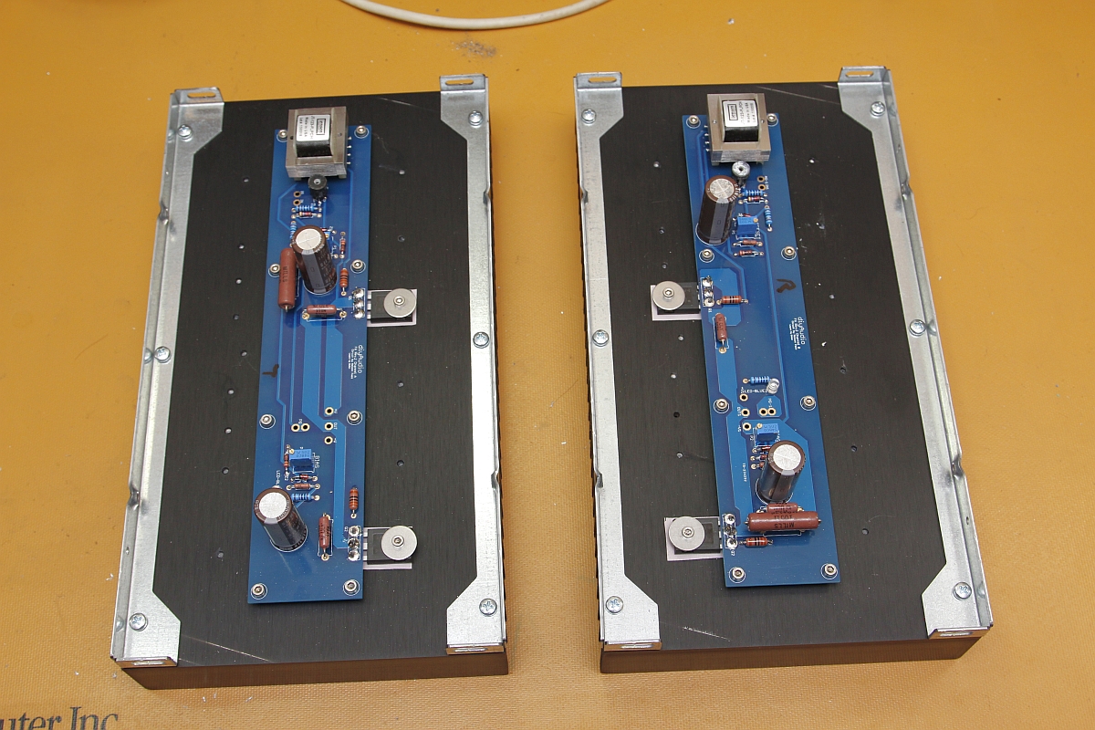

Another F6 build coming together. The various subsystems are completed, power system has been tested and solid at 26.5vdc. Taking a small break then let the final wiring begin!!
Followed by amazement and enjoyement!

Completed the basic wiring to check the boards and yes I had the dreaded LED on one channel install backwards. Those late night builds!
Bias at .5 with 0 offset and supply steady at 26.2vdc for both channels.
Gonna let it cook for a bit.

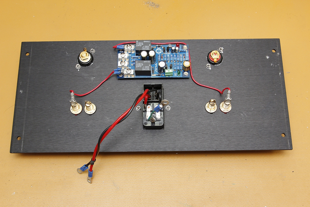

OK so now I realize that I 'should' have ordered more (all ) PCB's from the DIY audio shoppe.
Not a full complement of Newbie help info in there.
Will the soft turn on prevent the dreaded 'Turn on Thump' which I dislike
Or just make life easier on my PS caps? which isn't a huge worry for me TBH.
What about speaker protection?
How likely/real is the possibility of the Amp failing and dumping DC?
No opinions, just asking as I forgot to order all the boards at one go 😱
Although I do have perf board on hand as possible workaround..
Wondering if SGK's soft start is a good path to follow?

I guess I am just anal. I like the extra protection added from the two boards. Probably adds 50usd to the build. I also come from the old Heathkit era and enjoy building, so that is part of my motivation.
