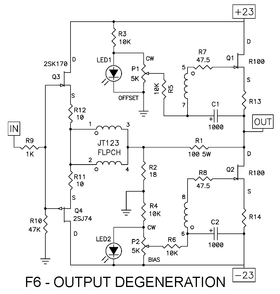

Hello,
I've collected the pcbs, transformers and so on and now I'd like to start to build my F6 amp with R100 output devices.
I need only some informations:
Thanks a lot for your help.
Guglielmo
- I've fooud different schematics with R100,(Buffered, Variable 2nd armonic and Output degeneration) which is the right one?
- Which kind of leds (LED1, LED2) are better to use?
- I've a 400VA power transformer and big heathsinks, wihich is the better bias current setting?
Guglielmo
1. build that one pictured as "output degeneration" (enclosed down)
2. say green , two in series per position , vulgar 5mm dia , giving you around 2x1V9 or so across , or just use Blue ones as papa (so 2V7)
3.read article on 6moons ( also attached few times here , if I remember OK) ; say that 75-80W dissipation per channel is nice area

Only two questions left:
- which is the correct value for R13 and R14?
- as indicate I can suppose that 1,5A is a good bias current?
