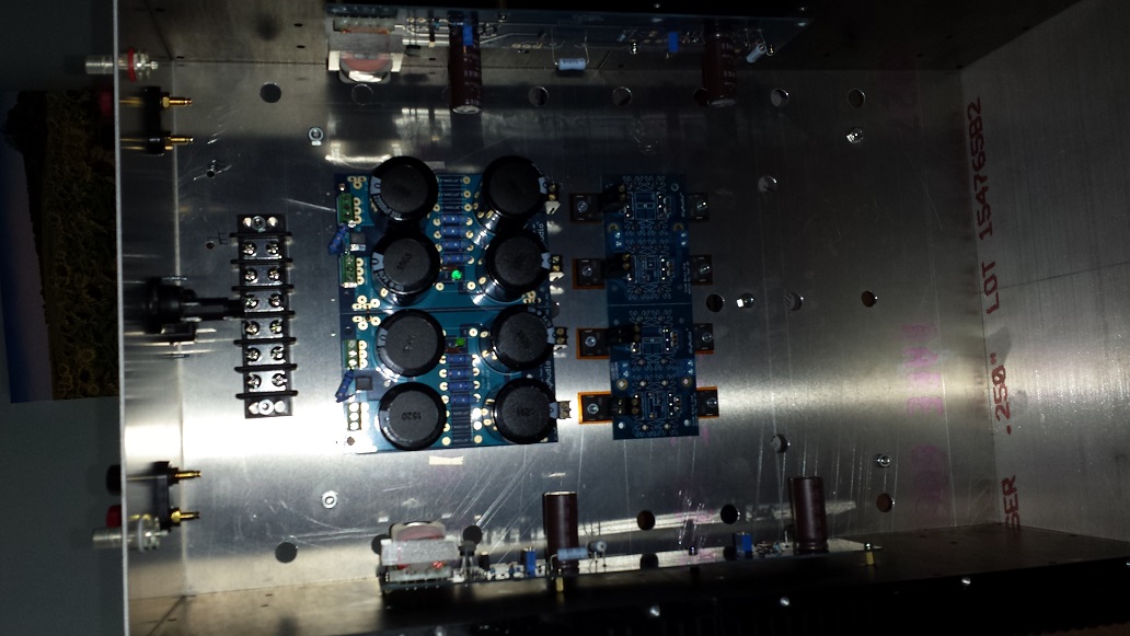

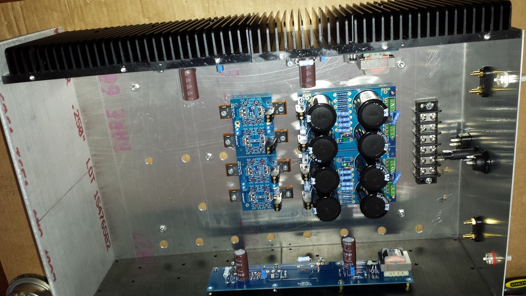

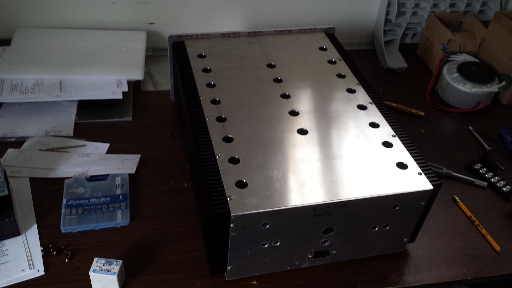

Heatsinks in hand finally .. 7+ lbs of Ali. That should work.

Russell do you use your store's chassis without the bottom panel? I've been thinking of doing so because all the necessary stuff attaches to the metal bottom plate and this way maximize airflow.
Now that I have it on, I can tell you that BA-3 in 5U with 32 volt rails and 3 pairs per side, WITH the bottom cover on and a cat sleeping on top, temps are fine.😀
Also, F-6 in 4U is fine temp wise with bottom cover attached...WITH or without the Cat on top.
