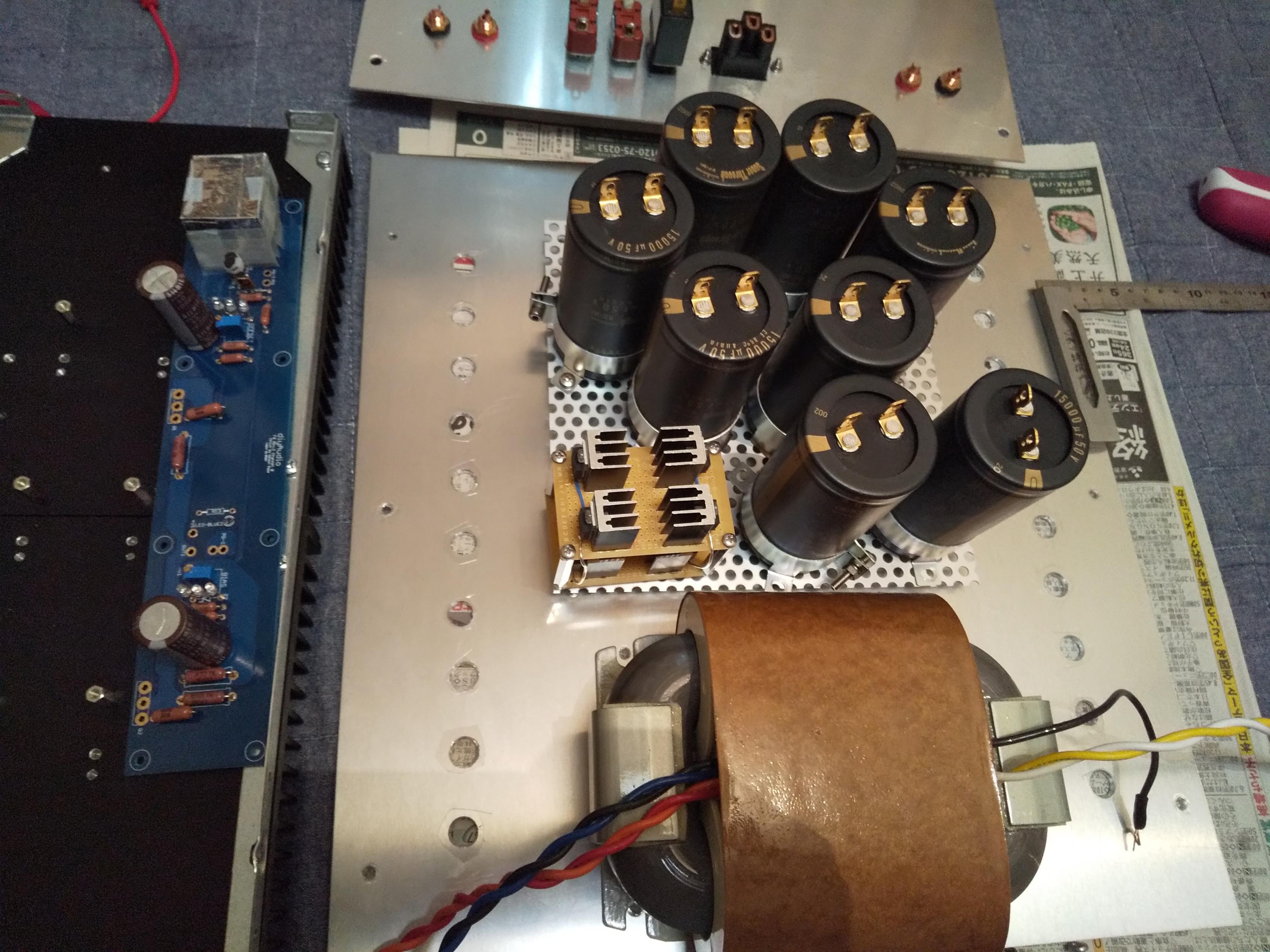

Just to be sure - I am probbaly over cautious - I have a light bulb wired into my chord from the socket - the picture shows my multimeter clips on positive and negative on the power supply - I followed the picture in the build guide with the "safety" cap across the two line inputs -- It showed the CL-60 as basically tying the two transformer leads, parallel inputs, together this seems strange to me since it is bridging two parallel circuits but I guess it works.
I saw the post about Audio ground v chassis ground -- not sure how clear the picture is but I have ground from the IE Socket connected to a bolt on the chassis as well as the ground wire from the transformer - I also have a CL-60 between the ground in the center on power supplly (the same ground point as goes to each channel) I am concerned about this last ground I may be mixing chassis and audio Ground. Isn't this a star ground?
Not clear from the pic, is the Transformer hanging from one side or it is locked from both ends???

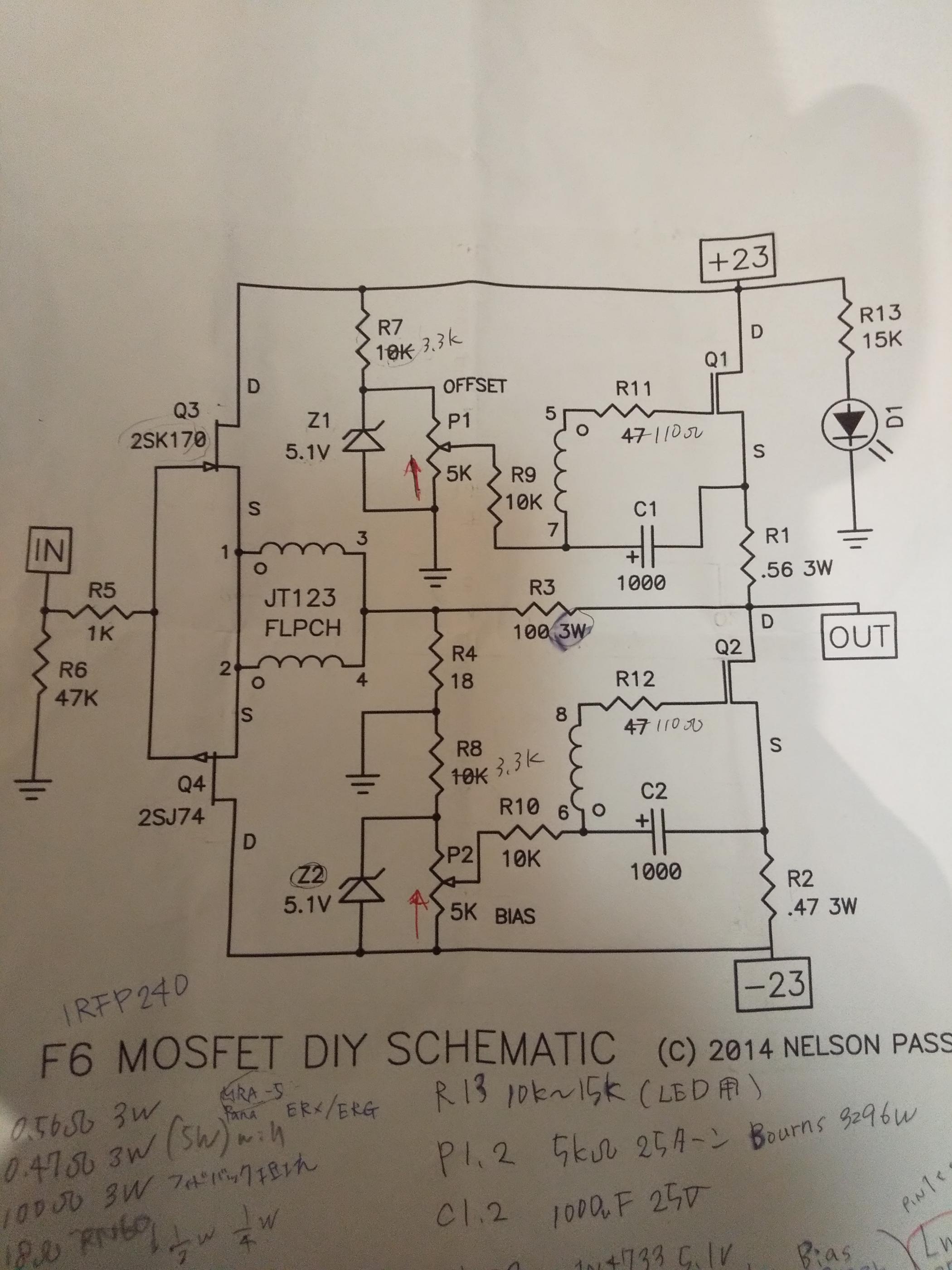

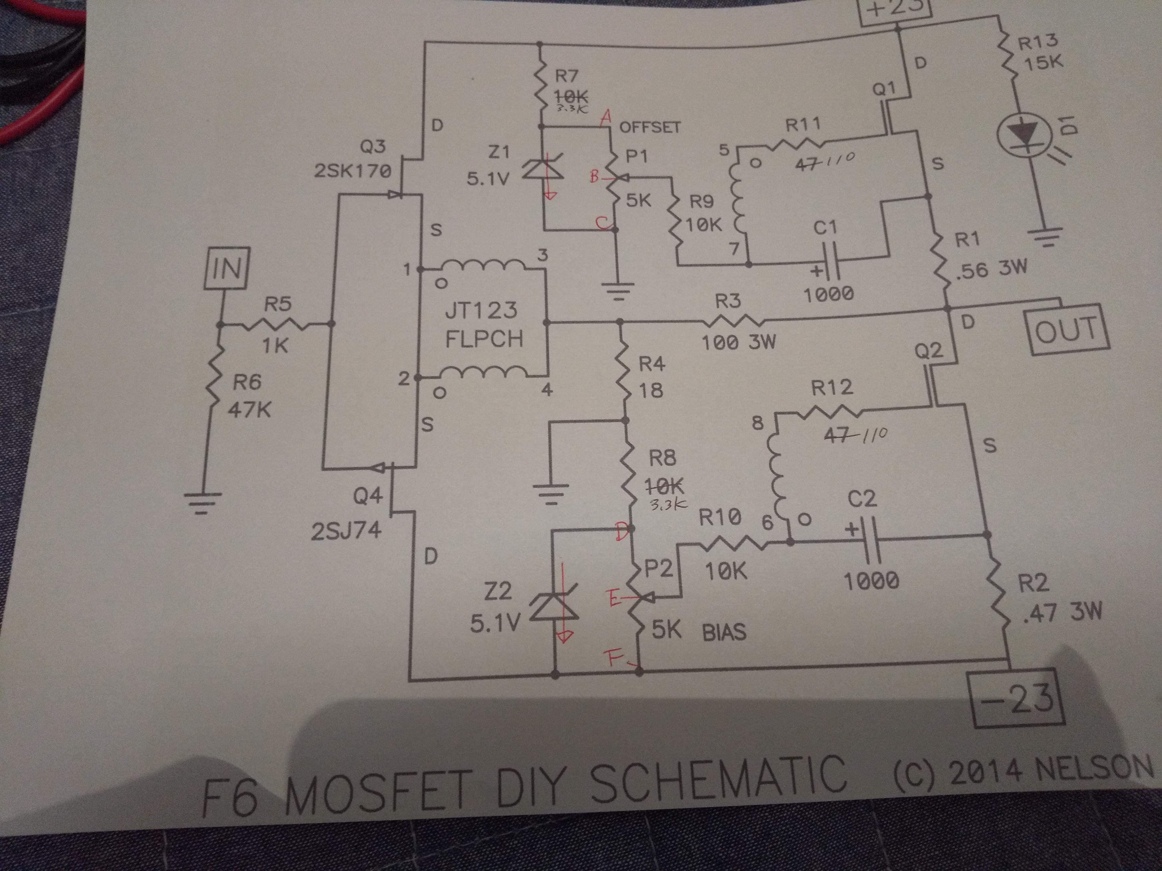

Hello.I have got every f6 parts and soldered PCB.
I need help to understanding biasing and DC off set.
I wrote red arrow which electric current goes.
So zero ohm between red arrow is beginning point to test Bias current and offset?
I am sorry for my bad English on advance.

When i rebuild my F6 recently, i turn the Bias 5K pot to zero, checking with a multimeter.
And Offset pot somewhere between 25~50% of the 5K pot range.
When i first power-up, there is no current flow through the 0.47R resistor, then i start turning up the Bias pot, and current creeps up slowly.
Bias and offset are somehow interrelated during adjustments, so i suggest you use 2 multimeter at the same time during adjustments.
Good luck with your F6!
After experiment with different bias level, i settled for 1.65A @55DegC.
I did try 1.8A but the heatsinks temp went above 60DegC, personally i feel uncomfortable, not that it will fail, just too hot for me to feel safe in a home environment.
