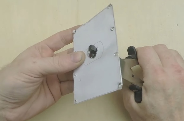

How about this one (seen here)?
Haven't tried it myself, though, it might work on the back panel and is only $13 in the US. See here.
Joined 2003
Nibblers, they work for metal and ceramic tile, or that's what I've used them for. Some drill a bunch of holes along the entire cut line, then file used to "straighten" them. Too much work and mess for me. I want to punch it out, or drill round hole. but, nibblers would work if you are stuck and that's the tool you have on hand.
