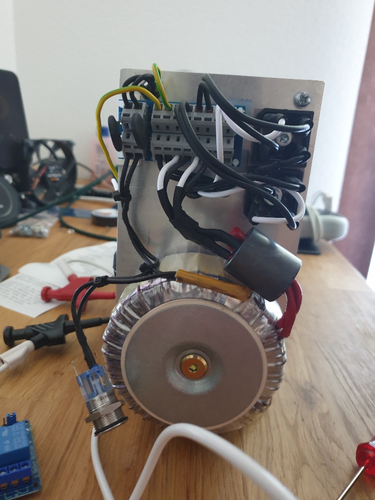

Have you tried rotating the transfomer around its axis or between vertical and horizontal orientation ?
Maybe in your temporary chassis its orientation was different in relation to the Jensen than now. Toroids have radiation "lobes" and radiate more in certain directions than others.
Regards, Claas
Regards, Claas

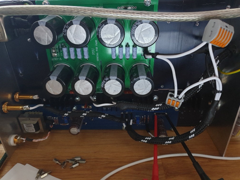

Success!!! 😀
The hum is gone.
Even with removed input leads it was still humming.
So i decided to throw everything unneccessary out.
That included my speaker protection and the wires to the Front LED.
Then it was silent.
I Think the board picked up the hum through the led wires... crazy.
The Wiring was exactly the same as in my second channel, so i thought that should not be the problem.
I was wrong 😱
Now i have to rethink some Wiring...
But i will sein this opportunity to put in my new speaker protection, that i designed 😀
The hum is gone.
Then it was silent.
I was wrong 😱

That was a bit of a strange one but great to hear its all OK.
You will just have to build it up one step at a time and see where the hum is introduced.

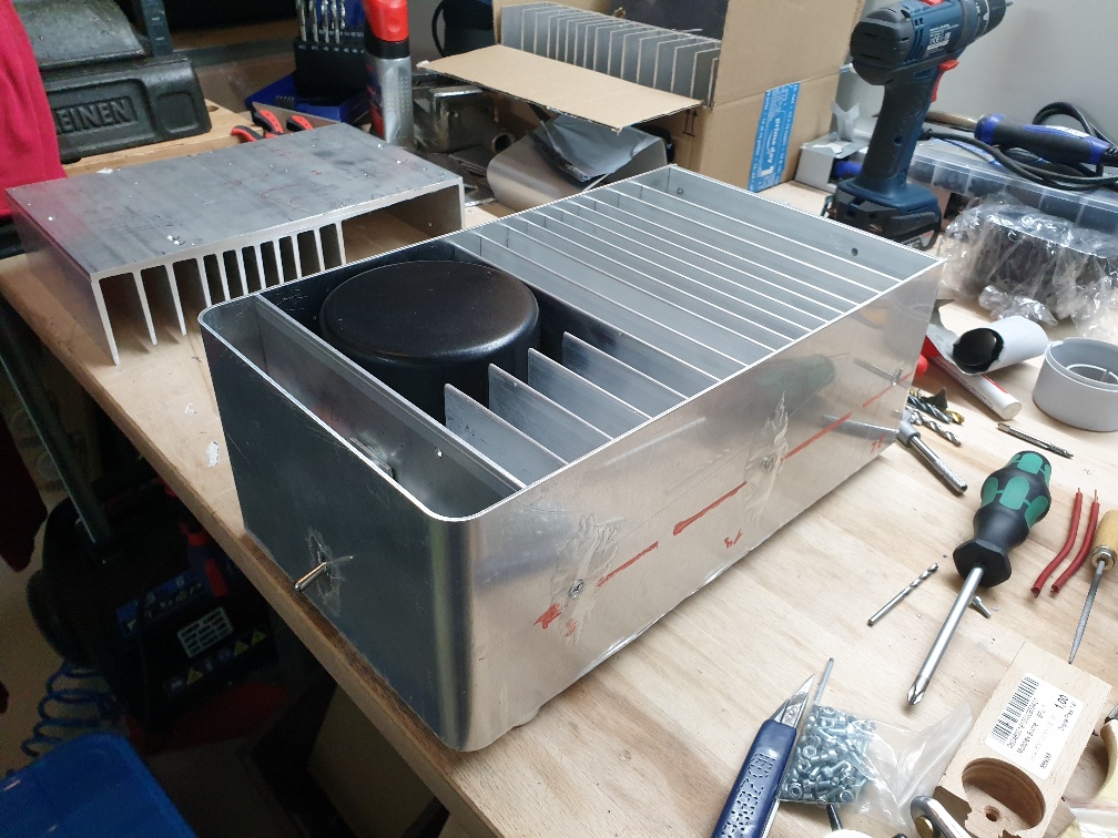

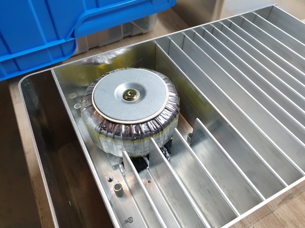

Good thing you solved the humming issues. Time to enjoy the amp.
Really like your chassis design, where the trafo is housed in its own chamber.
Thanks @ meanie.
In my first version of the chassis, the transformer was on top.
But I had a bit thermal problems with this solution 😀
But now its in the front and the chassis is even a bit smaller now 🙂
