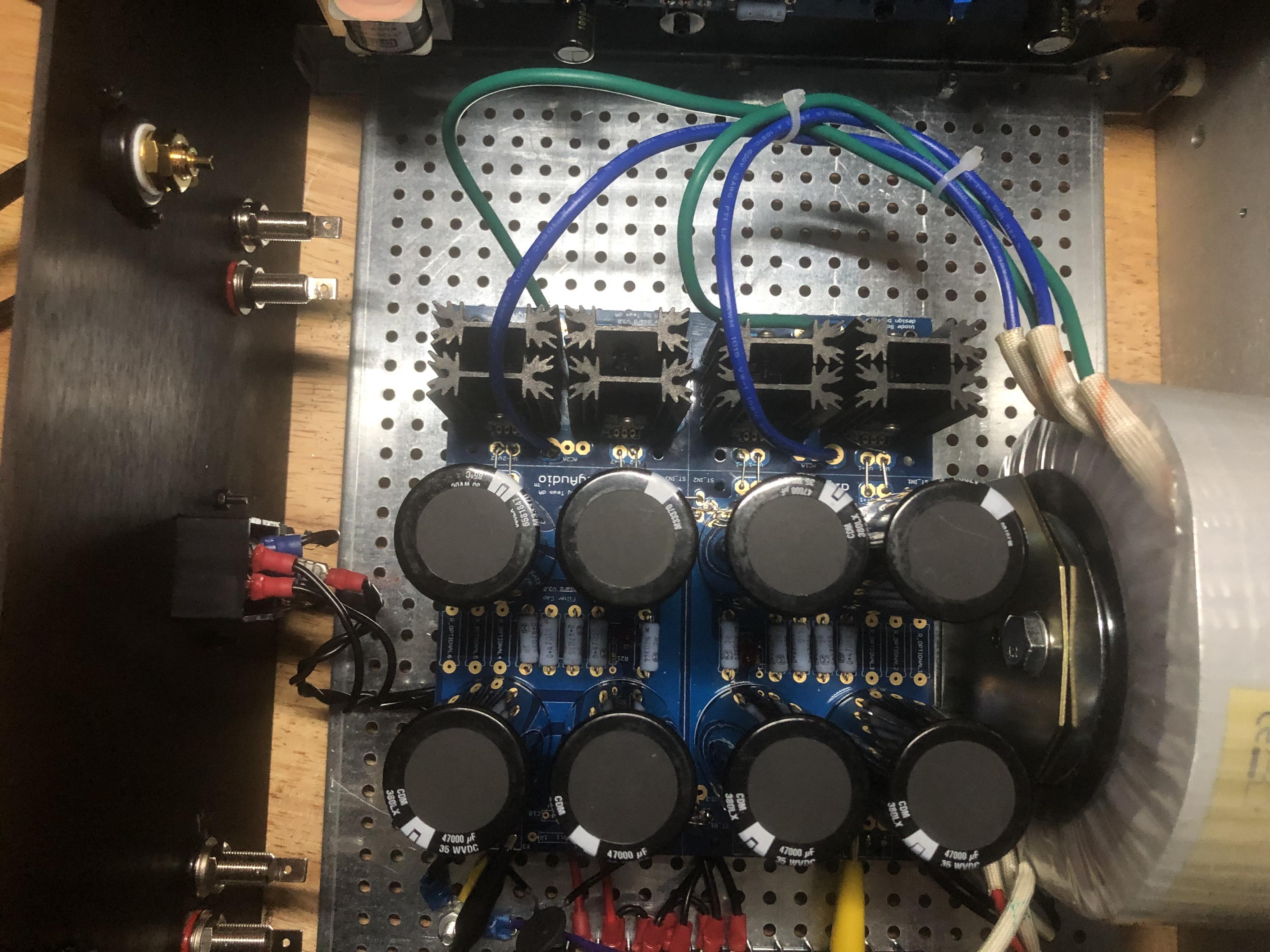

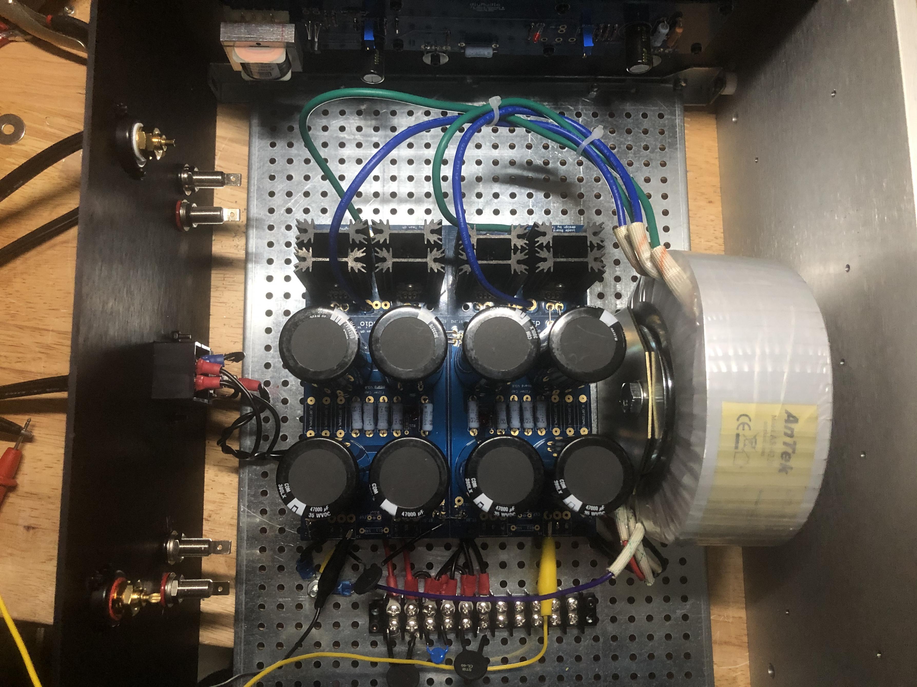

Just to be sure - I am probbaly over cautious - I have a light bulb wired into my chord from the socket - the picture shows my multimeter clips on positive and negative on the power supply - I followed the picture in the build guide with the "safety" cap across the two line inputs -- It showed the CL-60 as basically tying the two transformer leads, parallel inputs, together this seems strange to me since it is bridging two parallel circuits but I guess it works.
I saw the post about Audio ground v chassis ground -- not sure how clear the picture is but I have ground from the IE Socket connected to a bolt on the chassis as well as the ground wire from the transformer - I also have a CL-60 between the ground in the center on power supplly (the same ground point as goes to each channel) I am concerned about this last ground I may be mixing chassis and audio Ground. Isn't this a star ground?

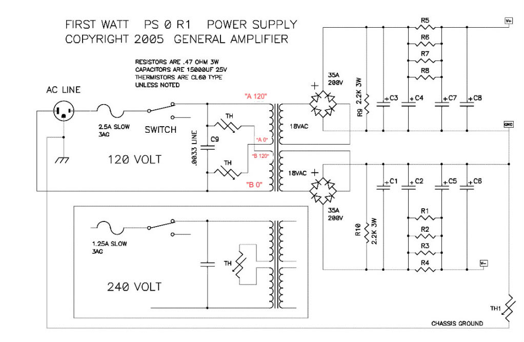

So far so good. The CL-60 between audio and chassis ground is known as a loop breaker. It does make a DC connection, but keeps the two grounds somewhat isolated. The audio ground at the center of your PSU is now the point for a star grounding scheme. Best to attach the speaker negative terminals to this star ground.
It will make things easier if you power up one channel at time. Use two multimeters – one to measure Iq (as voltage across one of the source resistors), and the other to measure DC offset across the speaker terminals. Do not hook up a load to the speaker terminals yet.
For 120VAC, there should be one CL-60 in series with one primary, another CL-60 in series with the other primary and the two primaries wired in parallel. A third CL-60 ties the chassis AC line ground to power supply ground.
I'm still confused about my power supply, it is the Universal Power Supply board - I plugged it in with the light bulb and the light bulb glowed and faded out - My LED's lit up -- seems good to me
The build guide says put the multimeter across the .47 ohm source resistor
I have 4 .47 ohm rsistors on each side and an LED drop resistor - I tried the multimeter on first and then the last resistor on each side it ends up abou t.001
I tried different resistors and there is minimal voltage. The light bulb quit working after the first time but I assume this is because the capacitors are still charged since the LEDs remain on. After a longer wait the light bulb lights and fades
It seems to me that since I should be putting out 18- 20 volts to my amp boards I should get 18-20 colts on v++ and ground - but again I get almost nothing.
I must be missing something. I want to be sure my power supply is OK before I start connceting and powering up my amp boards
tbrooke,
When you test the power supply only, the only load present is the bleed resistor and the LED on the board. If you are using the standard diyAudio power supply, the bleed resistor is typically 2.2K which will only draw about 10mA or so. So if the dim bulb tester glows bright and then fades out, that is a good sign as the 10mA current is not enough to light the bulb. So your power supply is not shorting.
Next you can test the amplifier board. Important - test only one board at a time!!
Follow 6L6's instructions on page 1.
