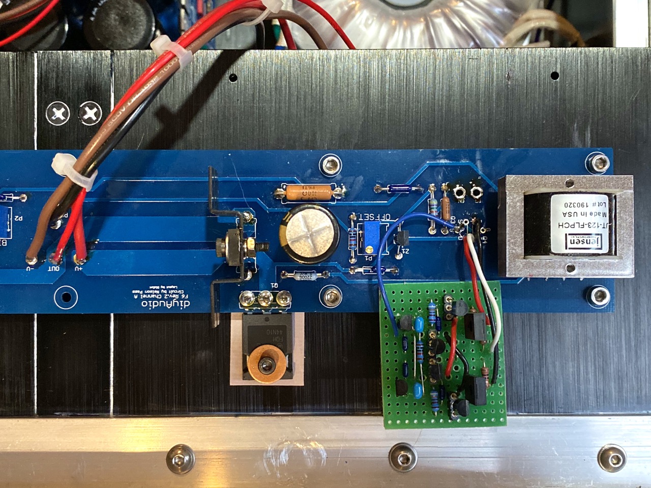

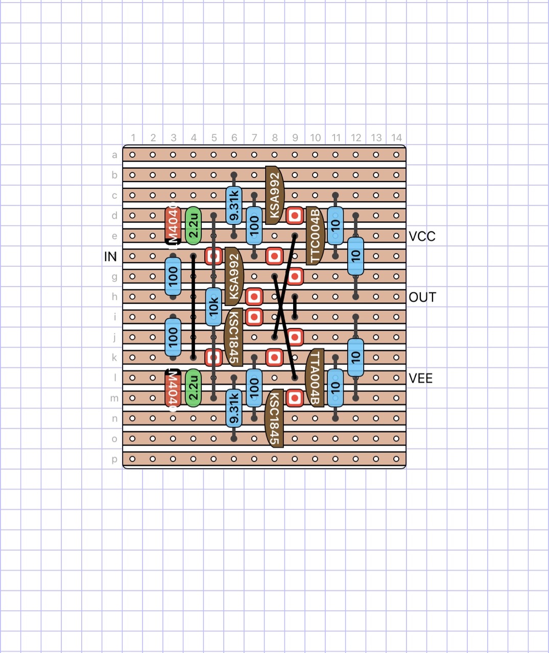

I built my F6 front end cards on Veroboard, aka strip board. I don't have a schematic, as I got used to reading the strip layout as such. It mainly substitutes Toshiba TTC004B and TTA004B for the output devices. I also used 10 Ohm base stopper and emitter degeneration resistors instead of the RC network across the bases of the output devices. Works quite well.
I tweaked the SLB components a little to use lower VceSat bipolar transistors, and got good stability in the CFP. Here is a list of the changes that were made to the SLB, referenced to the SLB-APRIL-11-2019 schematic:
R1, R2: 18 Ohm
C7, C8, C13, C14: SLPX183M050H9P3 (18,000 uF, 50V)
Q9, Q11: KSC2690AYSTU, KSA1220AYS
Q10, Q12: MJW1302AG, MJW3281A
R17, R18: 1.8 Ohm
The transformers I used were the Antek AS-3222, which gave me +/– 26V power rails with 1.85A bias current.

Thanks. I am comparing and contrasting Mark's Austin schematic to what you have shown me. It also looks like you omitted the output 220uf capacitor (C1) and also a small bypass cap (2.2uf) across the V+ rail. R8 and C4, the RC network across the bases of the output devices were omitted as well. IC1 and IC3 are 10V voltage references, and I take it that you used an LM4040?
Very nice! Is the omitting the 220uf/C1 output capacitor okay as long as we don't have any dc on the input of the amplifier? I am asking since there is the Jensen input phase splitter transformer.
Thank you for sharing your experiments. The Verocard is a cool idea and now that I think about it, one can design a multitude of input buffer/small gain cards for the F6 as long as it has a low output impedance as Nelson recommends in his F6 article from 2012. Heck, I am surprised that the M2 morphed into an M2x platform but the F6 didn't. And the F6 even has options for the output MOSFETS where you can use Semisouth R100's. The F6x platform? Hmmm...something to think about.

Yes, your summary of the changes is accurate. I used LM4040-10 for the references; they are depicted as diodes in the strip board diagram. The R8 & C4 network was intended to control something called "minority carrier injection," a somewhat rare phenomenon that may or may not affect the larger Toshiba output devices used here. Mark J. was no doubt following due diligence in the original design.
There is certainly a question of whether and where to install DC blocking caps in the front end. Before the buffer? Before the transformer? Mine is doing Ok without, but there are certainly scenarios where a DC blocking cap could alleviate issues. I'm unsure of the impedance present at the input to the Jensen transformer. Any DC blocking cap needs to take this into account.
I have considered doing an F6 PCB layout that either incorporates the diamond buffer or even allows for swapping alternate front ends. That might be the project that I use to learn KiCad. Other project are keeping me busy for now.

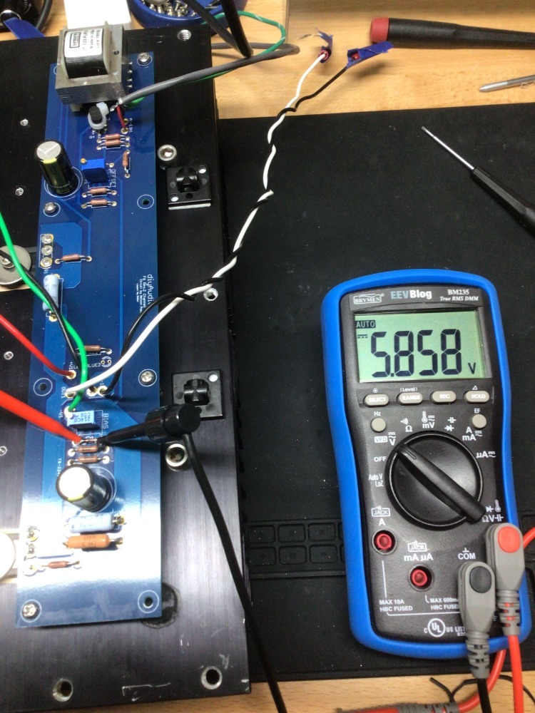

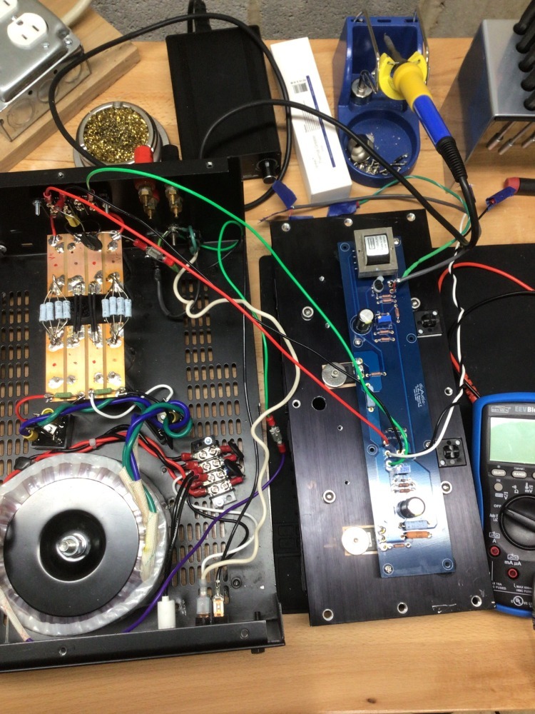

I have my F6 right channel pcb powered up with +/-25 VDC but I have zero bias across the 0.47 ohm resister at R2. I'm using a 6.1 V zener. All other components are per 6L6 's Build Guide. I thought I read somewhere that one of the 10k ohm resistors might need to be changed to a lower value. Could this be my problem? Or should I change the zeners to 5.2 or 5.6 V? Any help would be greatly appreciated.
John
If the voltage across the 6.1v Zener is lower than around 6.1v, R7 and R8 aren't allowing enough current to go through the Zener to reach the 6.1v. The 10k ohm resistors need to be changed with something like a 3.3k. Leave the 6.1v Zener in place. it shouldn't cause any issues.
Also, don't forget to turn the pots for the bias back down before you start it up in case you change the resistors out.

pics, and measure voltage across zeners, both up and down
write here
VDC across Bias zener with positive lead on cathode = +5.855. VDC across Bias zener with negative lead on cathode = -5.855.
VDC across Offset zener with positive lead on cathode = +5.909. VDC across Offsset zener with negative lead on cathode = +5.910.
RCA input wires are not connected and taped off. Speaker output wires are not connected and taped off.
Thanks Mike,
I suspected those 10k resisters are preventing the zeners from turning on. I don't have any 3.3k resistors, but I could parallet resistors that are approximately 5k ohms to reduce the resistance to approximately 3.3k.

Correction: VDC across Offset zener with negative lead on cathode = -5.910 (not +5.910).
