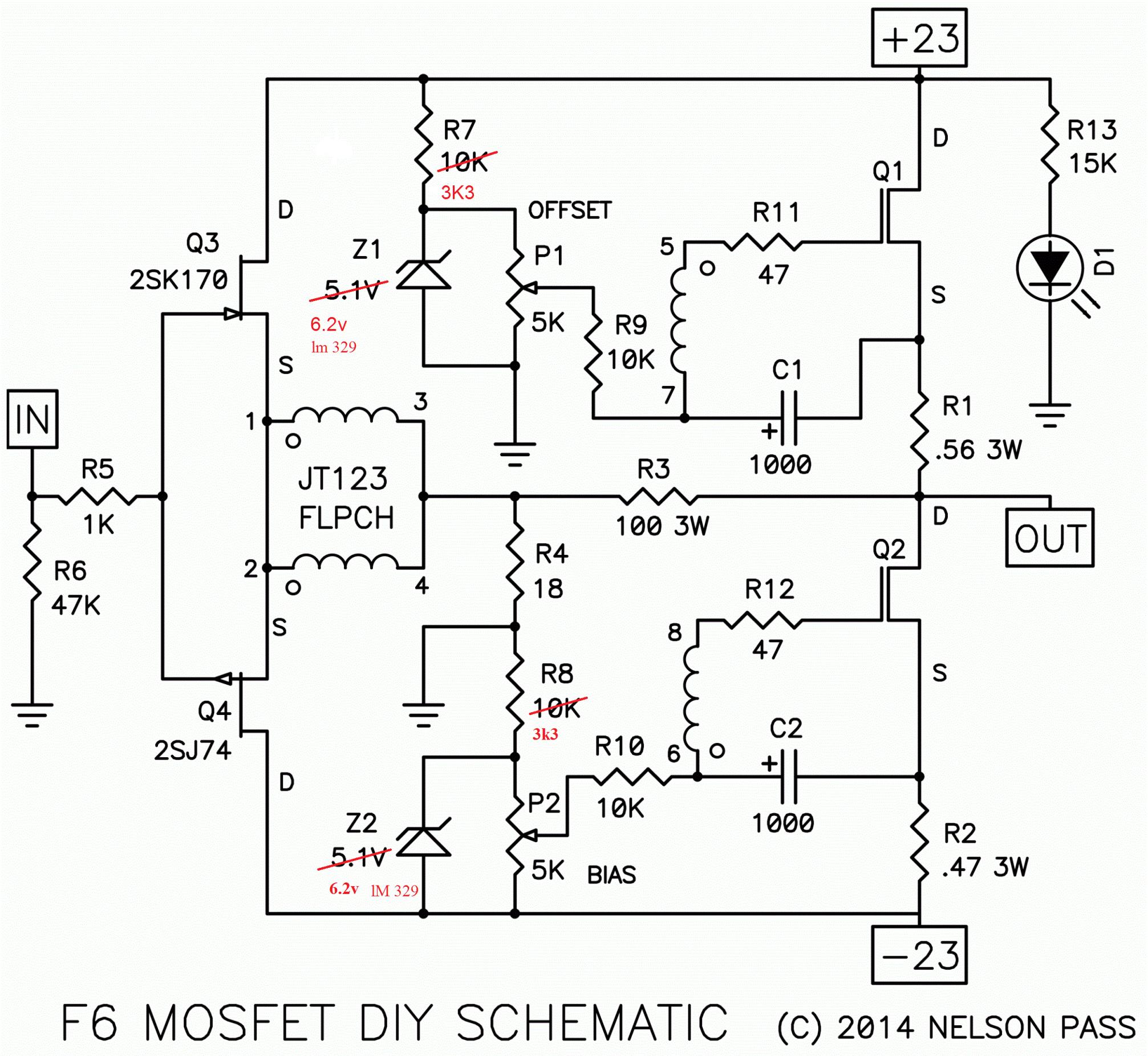

I am curious as to what some of the experienced builders used for Z1 and Z2. I believe the kit shipped with 5.1v, but it looks like most increased that to at least 5.6v.

Thank you @ColinA123 and @TungstenAudio for that info. I noticed my kit from diyaudio included 8 zeners, and although the markings on 4 indicated 5.1v but the other markings didn't show up in a digikey search. Once I looked at the old BOM they were indeed 6.0v, so I'm all set there. Unfortunately I had soldered the 10kOhm resisters into R7and R8 before I saw that, so I'll desolder that and order the 3k3 for those spaces. Glad I bought that solder sucker.

Regarding changes to power supply bom for F6:
Built with 6.0 V Zener and R7/8 = 3k32, R11/12 = 110R and IRFP150 in the output.
I’m unclear about these parts. Is R7&R8 3000 ohm 3watt?
R11 & R12 is 110 ohm? And what is IRFP150?
And why were these changes made?

@intojazz -
Looks like you're well on your way.
You've gotten some excellent suggestions re: tweaks / mods. What I'd do were I in your shoes (and what I did)... is... build it using the parts supplied in the kit and then mod later or with a different build.
The mods suggested will not (OK one of them maaaaaay) alter the sonic signature of the amp much at all. I think even in your original post you asked how close the circuit was to the "original" First Watt design. The mods don't make it "not" an F6, but they're not as "true" to the original if that matters to you. You asked why the mods were suggested...
I'll guess... They are in-fact "good" mods... this is DIY, and there are some insanely brilliant people out there that love to modify and tweak. That's one of Nelson's gifts also... he not only "gives" these circuits to the community, I think he genuinely loves it when we fiddle with them.
What do the mods do:
Changing the Zener / R values - Can make it easier to bias. I've never had an issue using the 6V zener and the R values provided in the kit. YMMV.
"Dumb" (I think it's brilliant) biasing mod (changing zener to 3 LEDs and changing R values) - allows the amp to reach a stable bias more quickly. It's neat, but not necessary.
IRFP150 - A different output device. Neat mod for maybe a tad more power / and tweaking. Again... is it neat... yes. Is it necessary, no.
Again... if you're unsure re: the build... I'd build it exactly using the parts in the kit and using the parts designations on the store site. You really can't go wrong that way, and I think your probability of success is higher. One guy's opinion.
