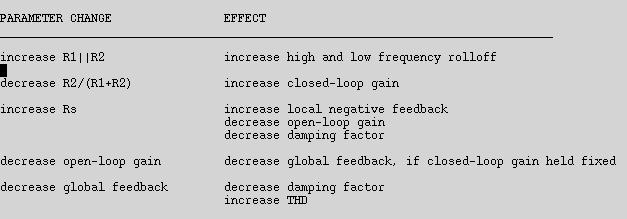

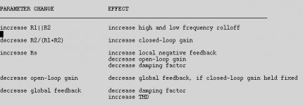

Teaser-6 "tweakable" parameters
The "F6 Concept Schematic" and the LHQUAM Teaser-6 schematic create an amplifier containing some parameters that can be "tweaked". This note discusses those parameters and their implications for the resulting sound of the amplifier.
To limit the parameter set, I will start by assuming a single pair of output FETs and a target output of 25 watts into a nominal 8 ohm speaker. This implies roughly 24 volt rails and 1.3 amp idle current for class A operation. However, the following discussion doesn't really depend on the top level choise of wattage and number of FET pairs.
The remaining parameters that might affect the sonic signature of the amplifier are:
Feedback network resistors R2, R1, where R1 is from output to feedback node and R2 is from feedback node to ground.
Output FET source degeneration resistors Rs.
There are not really any other "tweakable parameters", unless some other components are added to the schematic.
See the image below for the effects cause by changes to these parameters. (Can someone tell me how to get a table into the body of the a post without using attachments? White space formatting gets removed, screwing up the columns).
This amplifier is very different from the F5 because of the transformer. The transformer adds a phase delay of about 2.5us. Thus, global feedback will likely have a different sonic signature vs. local feedback, or no feedback.
EXPERIMENT WITH A VARIETY OF PARAMETER VALUES:
The source degeneration resistors Rs can be different for the upper and lower FETs. Small differences might be used to null the 2nd harmonic at a particular frequency. Large differences can be used to deliberately increase the 2nd harmonics.
As you can see, there are a relatively small number of adjustable parameters that can change the sonic signature of the F6. I suggest setting R1=50R and using a 2 watt, 10R or 20R potentiometer for R2 to "tweak" the closed-loop gain. My Teaser-6 PCB has provisions for a .1" spacing terminal block for the source resistors, enabling easy experimentation with different values of the source resistors.

lhquam: I am glad you are connecting the subjective "sonic signature" of the amp to its objective and measureable parameters. So, your reference loudspeaker will sing with a different voice which is discernible to you with each substantial [and maybe not] tweak. Clearly one "sweet" voice [to your hearing] will eventually stand out and be adopted.
Please reconfirm in your table of parameters the following. Will increasing Rs increase or decrease damping factor? Thank you.
