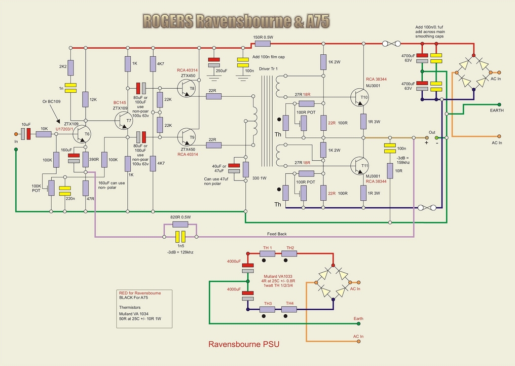

Many amplifiers designs did use an interstage transformer, for example the Rogers Ravensbourne, if am I correct an amplifier of the late 60s.
Enclosed the circuit. This amp is using 2x NPN power transistor in the output stage. Specs of this amp are rather good.

Thank you again wimdehaan. buzzforb: the primary winding of the transformer is driven in a differential manner by two bjts of low output impedance; because they are operating in the common collector configuration. One could even consider this front end a modest Op Amp.
some xformer based gadgets are made exactly for that ;
but , every other xformer based gadget (or part of bigger gadget,mix console for instance) is made with some other primary purpose and , depending how xformer is wired , can bring that virtue , or not .
so , in case of MJ schematic ...... it's not (real) gnd-breaker , because you have same gnd connected in circ on both sides of xformer
ZM: I fully agree with you that the transformer in the Tango schematic is not a ground loop isolator per the underlined. By contrast, the Jensen in Conceptual F6 will operate like a ground loop isolator because the CD player [could be battey operated] or other input source [that of Rush] and the power amp have independent grounds. And there is no reason [electrical, performance] to join these grounds either.

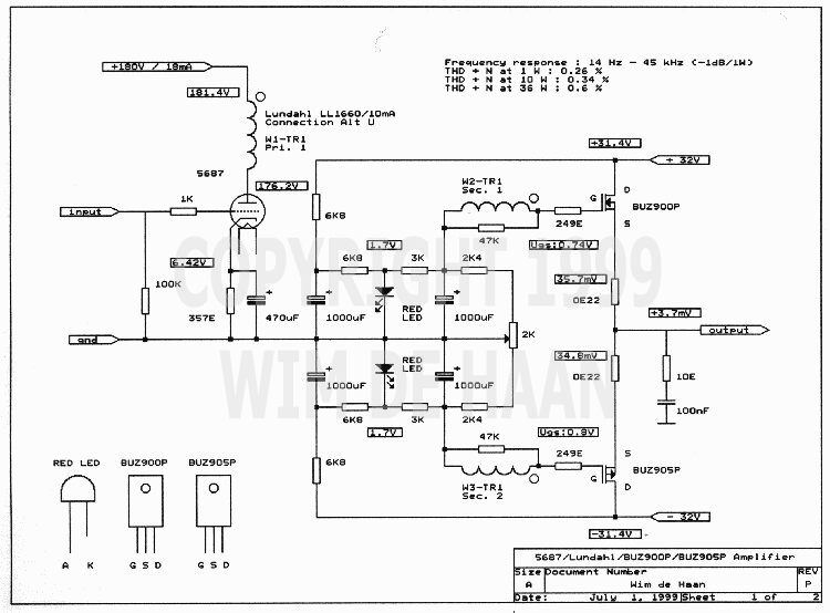

Guido Tent only put it on paper, he never build it. For this reason it was not noticed that the circuit had some minor (but essential) mistakes. I build and tested the 'real' thing using a 5687 tube and an Lundahl interstage transformer.

This one?
wimdehaan: Is he still alive? Where is his famous paper,
If I am still alive? I guess I am, otherswise someone else is using the same name 😀
I am not aware of any famous paper, on my website it was mentioned it was after an idea of Guido Tent, and realization by me. It was me who choose for the 5687 tube, the Lundahl LL1660 and Magnated power mosfets, the corrections came also from me. FLG did upload the circuit, this is a very early one, the 'real' drawing is a little different, the gray text was deleted.
The underlined suggests a name for the general Classic design which Mr. Pass wrote about in the early posts of the F6 Amplifier thread. It is the "wimdehaan-Tent Circuit". The family name of diyAudio member wimdehaan [like Tent] is not on record.
