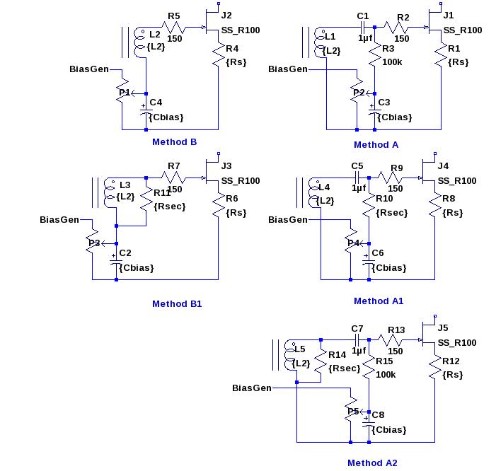

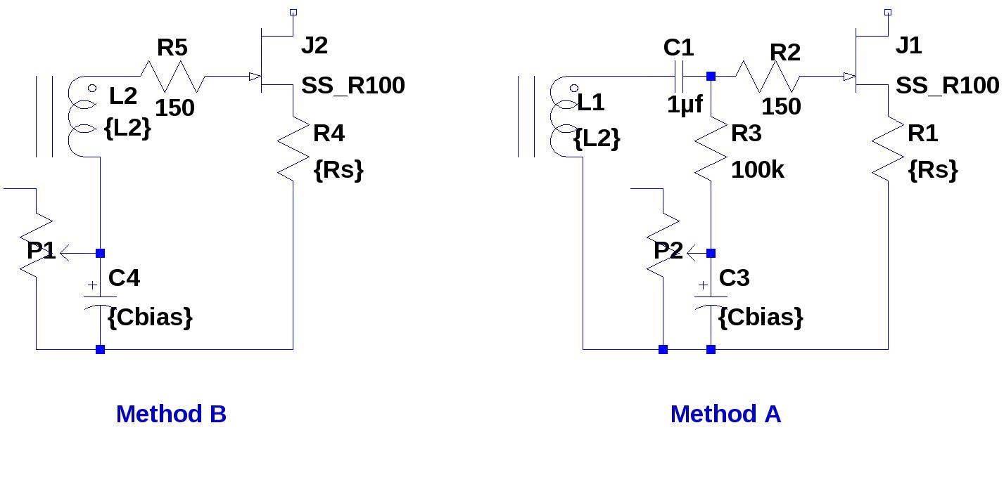

looking at pic from #742 (attached )
in case B AC path for modulation is through C4 , which serve also as bias voltage blocking/maintaining/smoothing cap
in case A AC path for modulation is through C1 ; in that case C3 is just bias voltage blocking/maintaining/smoothing cap
Secondary loading alternatives
In the following drawing, methods B1, A1, and A2 show some alternatives for loading secondary winding and biasing the output FET. In all cases, Rsec is the secondary load resistance.
if you ask me - any of A derivatives
which one suits you most ......
I don't like caps in the signal path. They make me want to buy $100 each or more caps and worry why I was too cheap to buy Audionote $1000 silver foil caps. So my 1st preference is "B".
Then it occurred to me that sometimes we do things that make the output device exhale the smoke within. Does this trick of letting the smoke out ever short the gate to a rail and possibly burn out a winding on the secondary?
That would be bad, making me reconsider "A". But I don't know the likely hood of that. I have not let the smoke out yet.:Ouch:
Rush
there is no non-signal side
even in case of B1 case (post #774) , where you have proper loading resistor across secondary , value of C2 must be sized accordingly to wiper-lower end section of trimpot , calculated as bypass cap , or it will not serve prescribed duty
in that case - it's AC impedance is low , so trimpot value is of no importance , AC wise
conclusion - cap is in AC signal path ...... as it must be , because Jfet likes to see signal between S and G
