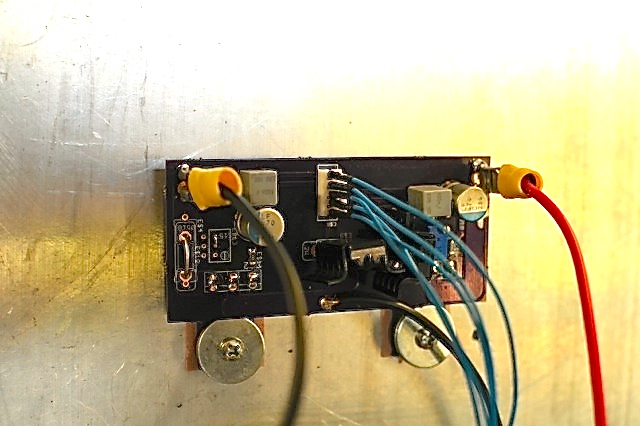

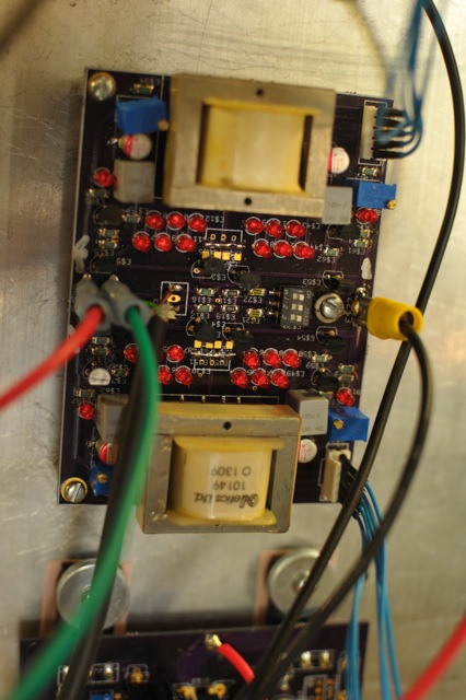

Thanks Nelson
I did get inspired at Burning Amp
but credit goes to buzzforb !!!!
He did such a great job with the boards 😀😀
