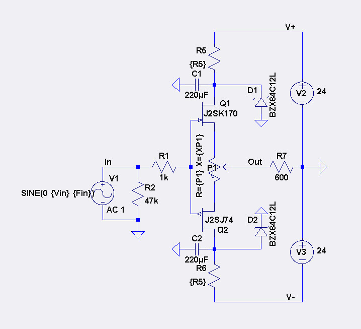

The pot I was describing is 10 ohms between the source pins of the input JFETs, with the wiper connected to ground, shown below. Its purpose is to balance the operating points of the input JFETs in order to minimize H2.

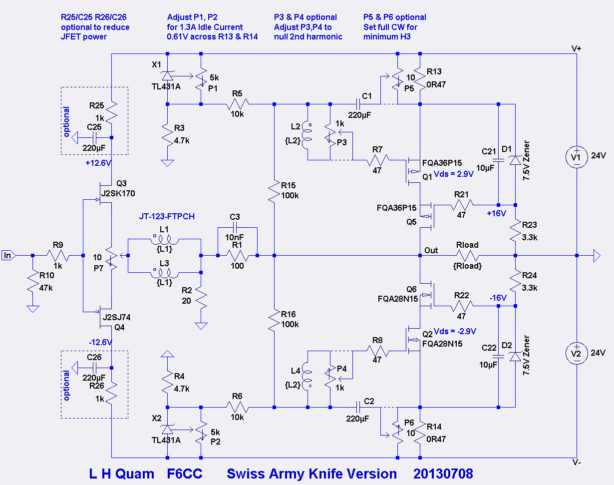

I can adjust the H2 level by adjusting pots on the transformer secondary windinging with wipers connected to the output FET gate stopper. I can adjust H3&H2 with "Zen pots" across the source resisotrs of the output FETs, with wipers connected to the caps at the bottom of the secondary windings. Need a picture?

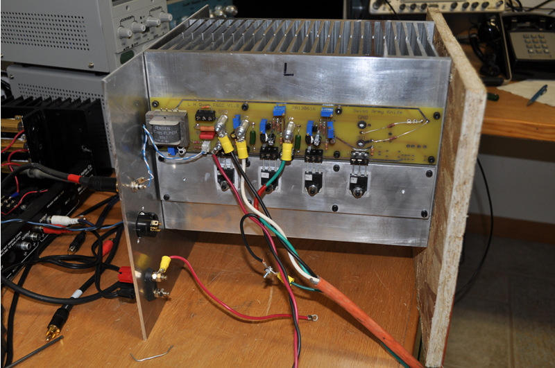

Yesterday I finished assembly of a pair of F6CC channels. So far I have only performed bench tests. I ran it overnight to verify voltage and thermal stability. Today I will start listening tests.
The chassis shown below was designed to ease the testing of experimental amplifier designs. It accepts PC boards with the Universal Mounting Specification. Output FETs can be easily switched using Molex connectors. The heatsinks are mounted fin-to-fin and can be used with convection cooling or forced-air with a pair of PC fans mounted on the bottom. I have not yet built a power supply for this chassis setup and I am temporarily using the power supply from an F5 build connected with rather long #16 wire cables. The power supply will be designed for a 10" x 12" footprint and will attach where the wooden panel is, making the overall package approximately 12" wide, 10" high, and 14" deep.

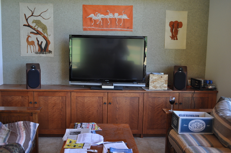

I finally started listening tests of the F6CC. Both channels were tuned for minimum H2 and H3 at 1 kHz, 1 Watt.
Absolutely no audible hum or noise with ear directly against the speakers. This is with an underwhelming power supply from my first F5 build with considerable rail ripple.
My initial listening tests were based on various acoustic guitar selections from Charlie Byrd, "Sketches of Spain" by Miles Davis, "Blues and the Abstract Truth" by Oliver Nelson, and others. I must qualify all of these subjective impressions on aging ears that were never the best and not getting better.
It sounds different from the balanced F5 I have been listening to for several years. My first impressions were differences in the high frequencies. I do not know if it is H2/H3 related, or related to high frequency rolloff, which I doubt. I heard something about the pluck of the string of an acoustic guitar. I need to modify my listening setup for A/B testing.
I have no doubt that different speakers, different rooms, and different ears would lead to different judgments.
I also suspect that Nelson the Magician could make tweaks to make this amplifier better.

Are you saying that you did not like the F6CC as much as balanced F5?
I haven't listened 'nuff to know. 😕 Various people have argued about "burn-in" vs. sensory-adaption when listening to a different audio component. Maybe more red wine would help.
BTW: It doesn't sound at all like my F6 builds. I find that speech intelligibility is fine with the F6CC, unlike my F6 builds.

Thanks to an offline suggestion from Buzz, I reduced the compensation capacitors across the feedback resistors from 10nF to 4.7nF and the F6CC now sounds much better. The high frequency problems I noticed have largely gone away. I need to "tweak" either side of the 4.7nF cap value a little before I will be happy. I think that this amp might be a keeper. 🙂
