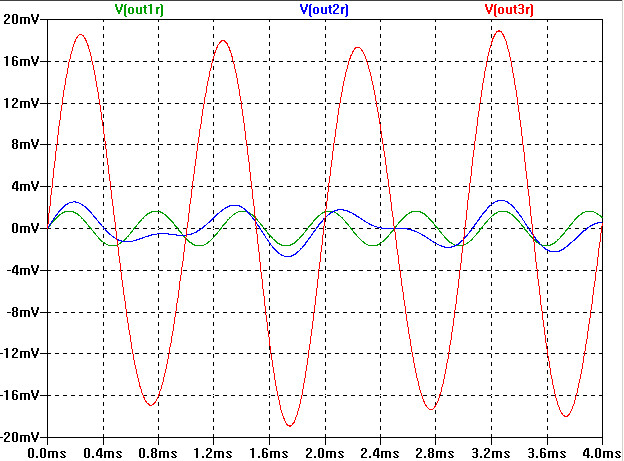

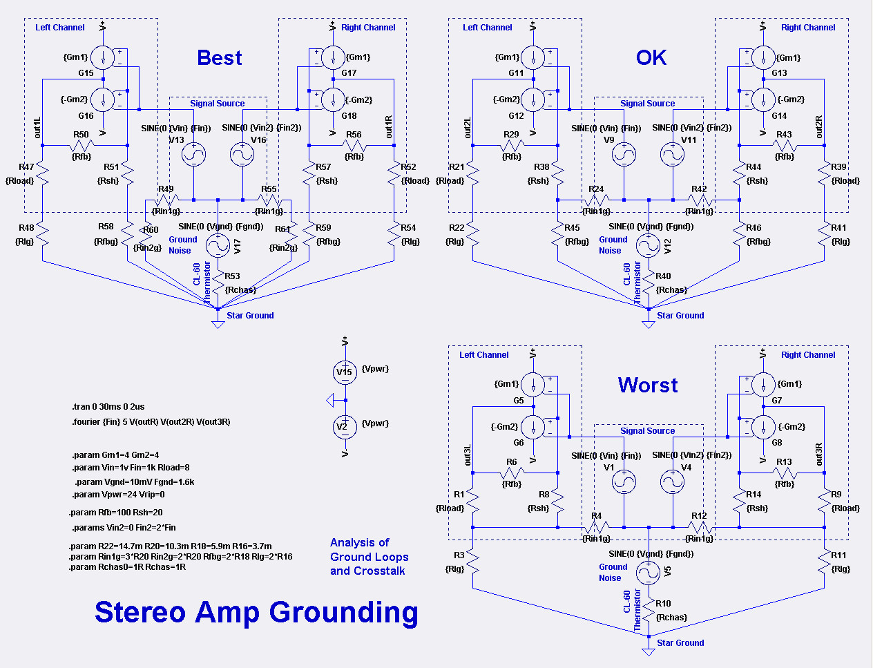

I have done some analysis of alternative star grounding schemes for F5, F6, ... type amplifiers. Since this is a rather generic issue, to what thread does it belong? Without explanation here is an LTSpice schematic and some crosstalk + ground noise waveforms.
