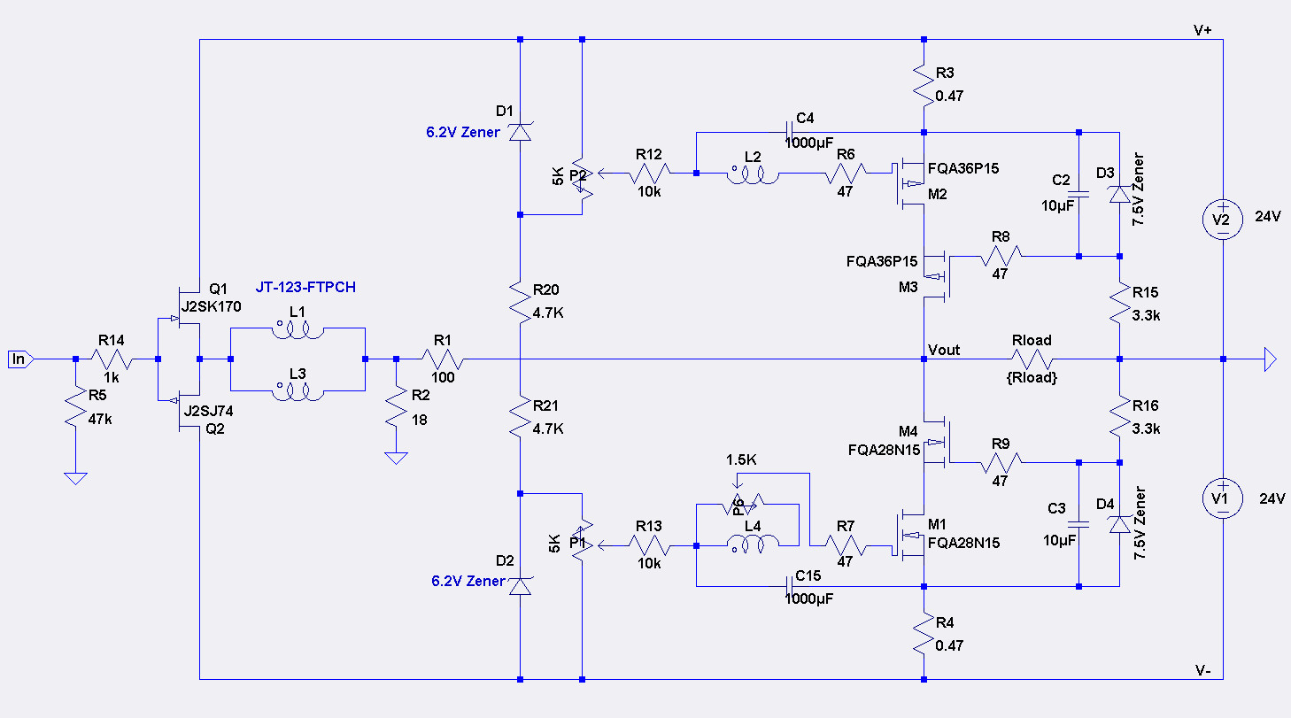

I have been experimenting (both Spice and actual testing) with amplifier circuits using NO AC degeneration and cascoding to see if I can significantly reduce the 3rd harmonic (and 2nd also). The problem is to achieve DC bias stability without having AC degeneration. One approach is to use very large capacitors (0.5Farad or larger) across the source resistors. That appears to work fine except at frequencies below about 100 Hz.
Here is a circuit using the Jensen transformer and F6 style bias, but using both NMOS and PMOS output FETs and cascoded outputs. A similar design using only NMOS outputs has much higher 2nd harmonic due to the interwinding capacitances and the large AC swing on the upper transformer secondary.
Spice simulations looks good. The next step is to build it and test.

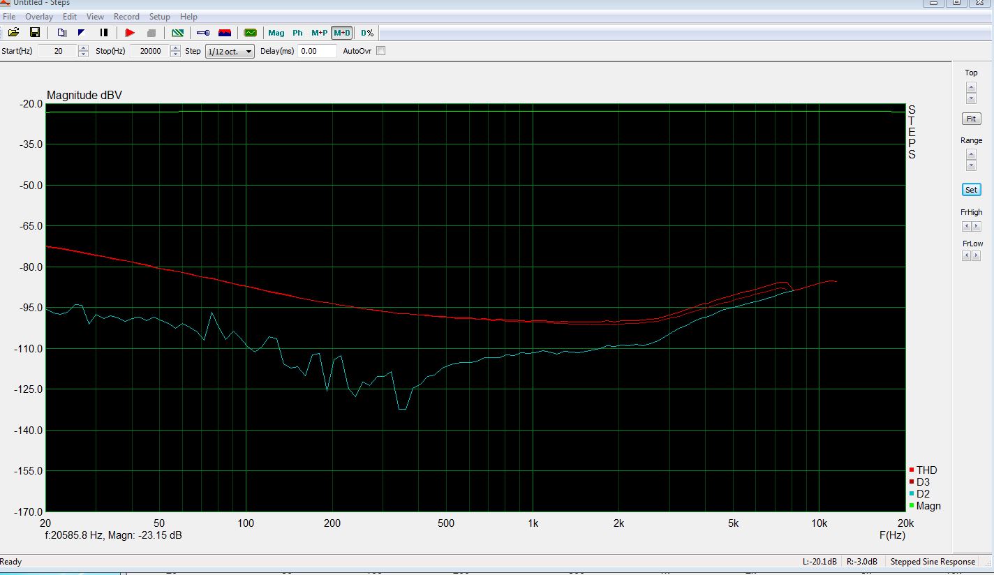

- BA-3 inputstage adjusted with P3 so that k2 is at minimum at 1kHz at 8R/1W... but this is only true for the range from 30Hz to 3KHz. From this point on k2 surpasses k3.
- the BA-3 input stage adjusted for k2 around 6db higher than k3 at 1KHz/8R/1W, you see the two curves keep parallel a long time...
- last picture shows M2 clones distortion
may be old stuff for many of you...
Sorry I offer here the data of BA-3 inputstage and M2 clonetry but I hope other people will do the same with F6 and I am interested to see the similarities or differences. I must dig for Ihquams old measurements.
F6 is just out of the case and poor boy has only one case....😀
And it was Nelsons F6 gift that lead my attention finally to this point playing...the distortion tango....🙂
k2 blue, k3 red...

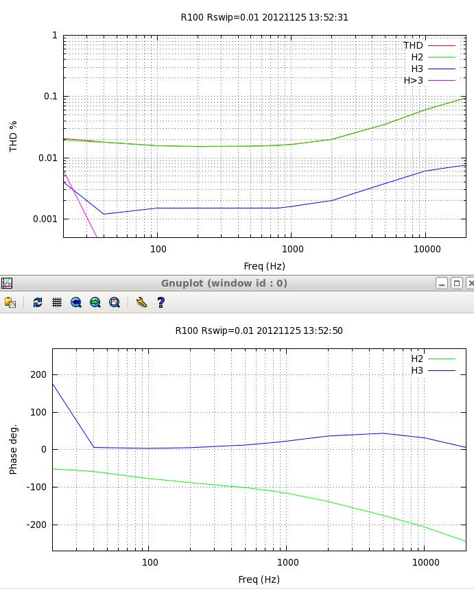

I just found one of lhquams old measurements of the F6 and you can see that k2 is very high above k3....I estimate around 20db higher...
http://www.diyaudio.com/forums/pass-labs/216616-f6-amplifier-311.html#post3256422
from my present knowledge I would say this will sound too dull, heay and masked..
so I understand fully that lhquam preferred the F5 much....
k2 maximum over k3 is for my ears around 12dB... of course very amp circuit dependent.
