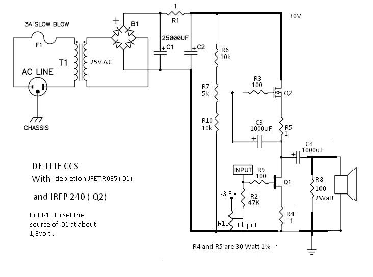

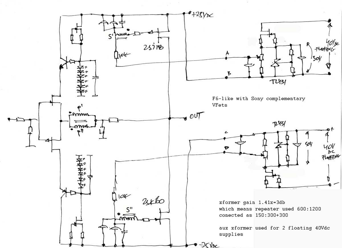

@vdienna,
R085 can be used with slightly more complexity. it will woprk inbelow schematic

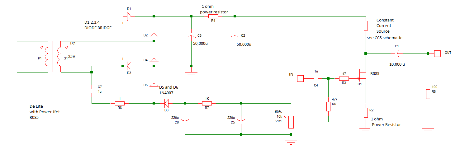

Last year, a DIYer suggested using an adjustable positive voltage regulator [LM317] in lieu of a depletion-style N-JFET. Its Adjust port [akin to Gate] is ~1.25V lower in magnitude than that of its Output port [like the source]. May try Zen Mod's schematic first with the cheap and available LM317 to undestand its operation. I'll find the original post. Back then, R100A was flying high, and this idea [LM317] was shelved.
Thanks Antoinel. I have these schematics, but it's not quite the F6. 😀
