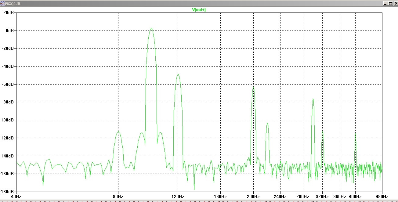

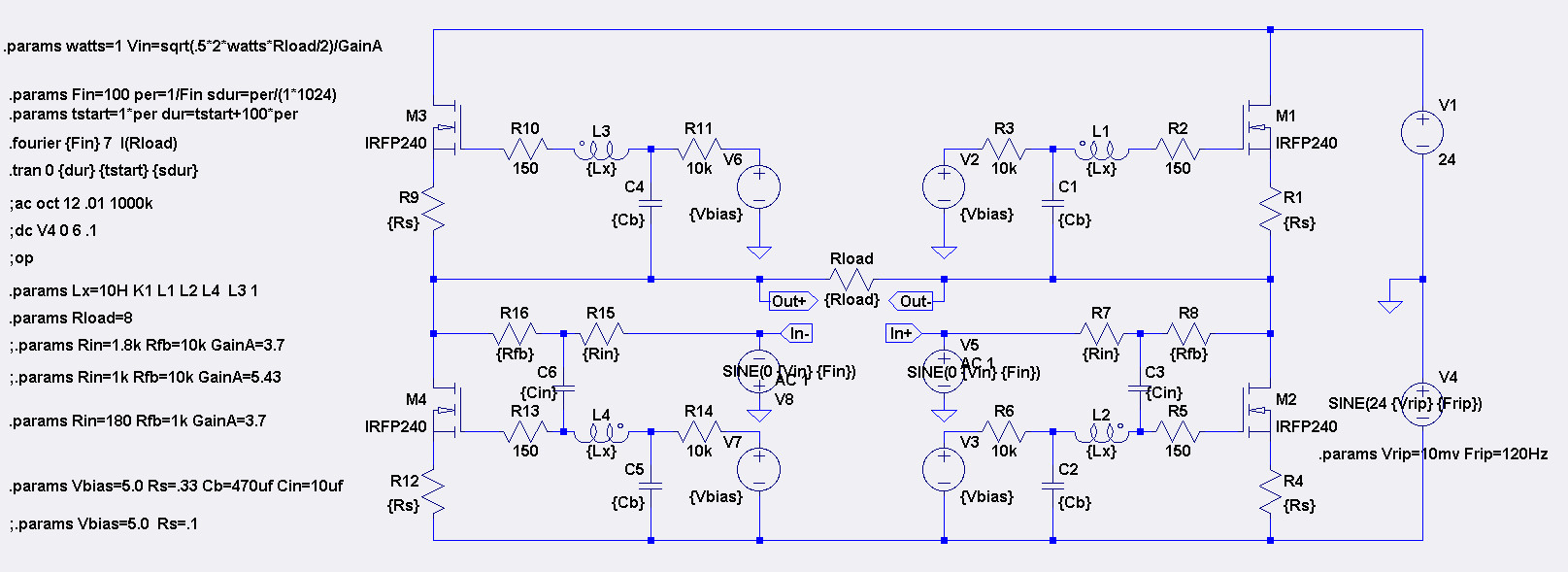

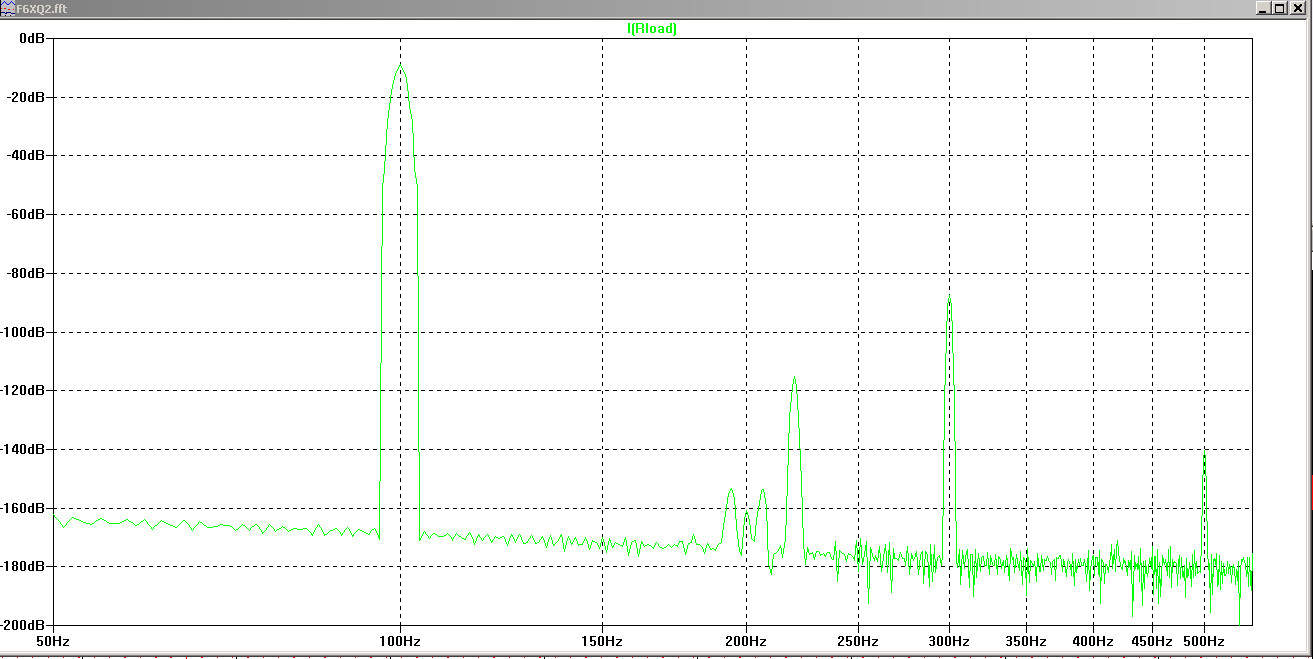

I have done a "1st-order" simulation of Buzz's circuit from post #4062. By 1st-order I mean that transformer inter-winding capacitances are not modeled. The simulation also assumes exactly matched IRFP240 FETs and other components.
The FFT plots are a follows:
  • Balanced output: I(Rload) 100Hz, 1 watt across an 8 ohm load.
  • Unbalanced output: V(Out+) 100Hz, 1 watt across an 8 ohm load.
The simulation includes 10mV of 120Hz ripple in the negative rail power supply.
As the plots show, the balanced output successfully rejectes the ripple on the negative rail, but the unbalanced output does not.

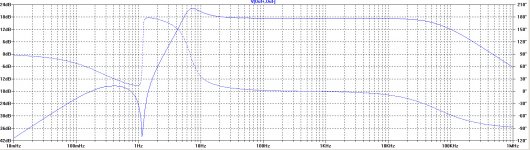

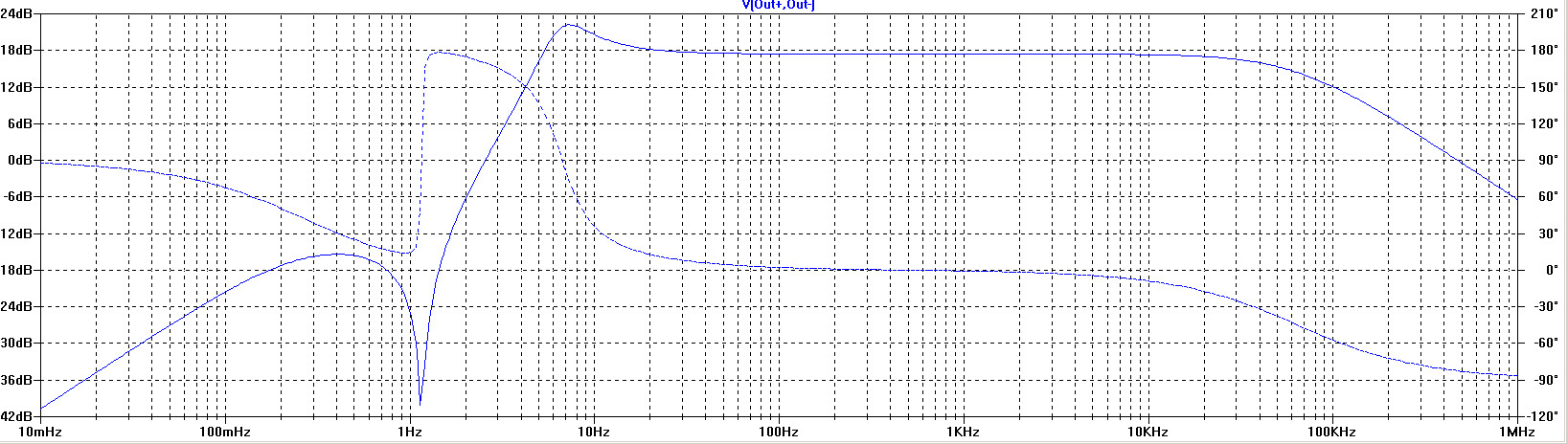

The AC analysis shows a serious potential to moterboat, ie. the phase margin below about 5Hz is poor.

I tried adding resistors valued from 10R to 30R from Out+ and Out- to ground. It did not make a significant difference in the AC analysis. I didn't expect that it would.
I found that increasing the Cin caps from 10uf to 100uf eliminates the phase margin problem in the simulation.

I am trying to understand the evolution of this thread to talking about a Balanced F6. If we return to Papa's original F6 posting it discusses the highly symmetric nature of driving the output NFETs using transformer coupling. In principle (and reality), this can greatly reduce the 2nd harmonic. In practice, getting (now unobtainium) SemiSouth JFETs that are well matched and dealing with the transformer interwinding capacitances has resulted in underwhelming F6 performance.
Now some are pursuing balanced-F6 configurations. If we wish to go balanced, then everything changes regarding to 2nd harmonic cancellation. There is absolutely no need that the positive rail output fets and their drivers be matched to those on the negative rail. What is needed for 2nd harmonic cancellation is that positive rail fets and drivers be matched on each side and negative rail fets and drivers be matched on each side. But there is no need for matching between positive and negative rail fets and drivers, other than quiescent bias current.
I have some some drawings, math, and simulations to demonstrate this.

I do not understand how the first fft plot could have THD+N = .048%. Something weird is going on there. The 2nd and 3rd plots seem to show THD+N correctly, but the 3rd harmonic seems to be unusually low, visibly absent. That would be great for in balanced amp, which could cancel the 2nd harmonics.

Might've wrong. What I did was increase output of soundcard until I had 1W across 8R dummy load I then disconnected the amp and looped backed that same signal level into the soundcard with nothing attached. I assumed this would show hat the native distortion mod the soundcard was at that output level. I then hooked up the amp again, double checked power through load, and measured distortion at 1W for each channel. It looked reasonable, with biggest concern being 7k blip on both. One showed higher 4k.
When I get my new boards, ill happily run all test again I you are willing to direct me in how to do so.
I might have been wrong about the THD+N figure being implausible. You have 60 Hz harmonic problems, probably due to grounding issues. I see big components at 180 Hz and 240 Hz.
