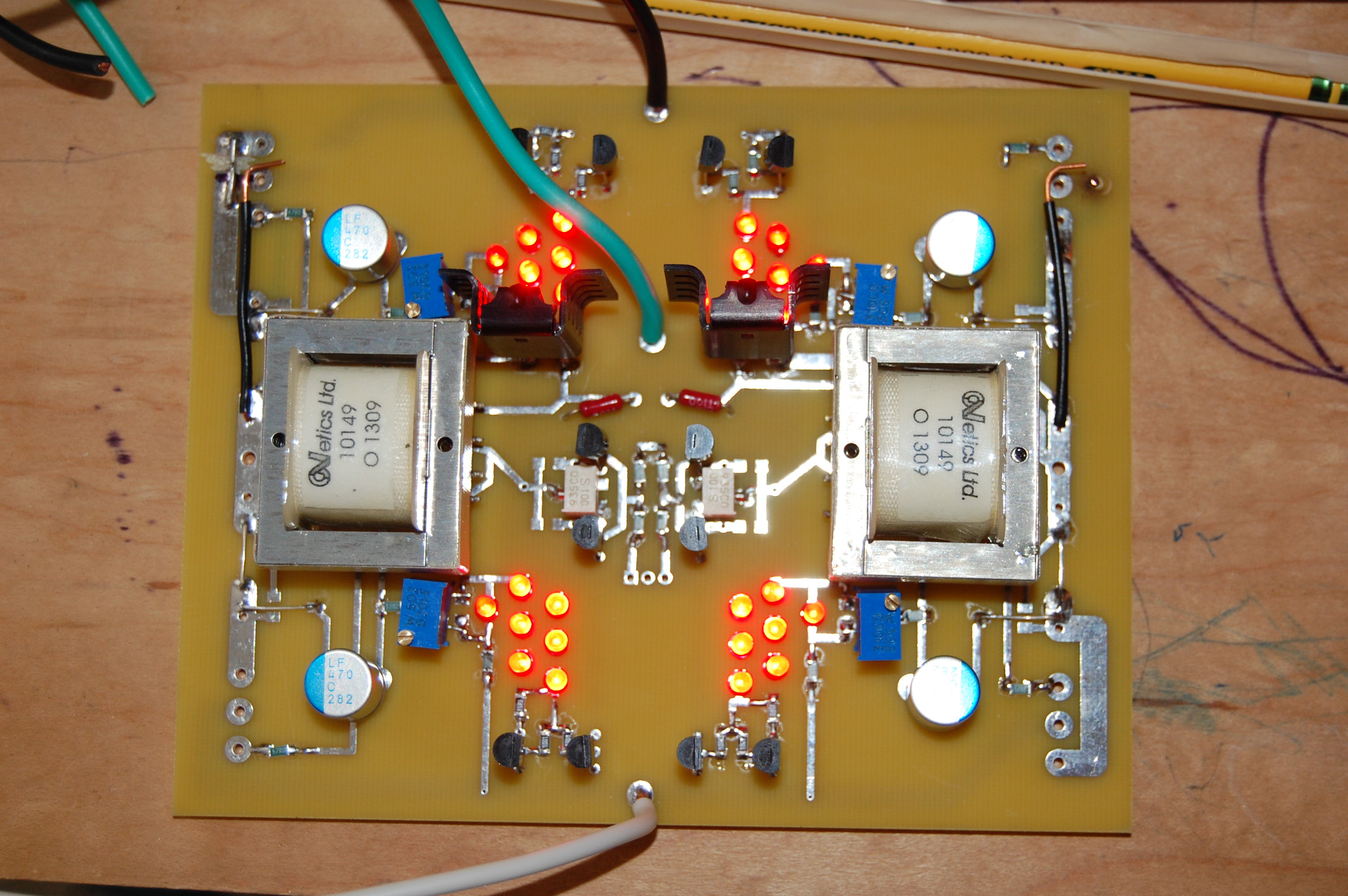

@kiven chen
you need fatter traces - for power (both + and - ) , and for loudspeaker output
besides that - I hate checking even my own pcbs ....... so no help in that , from me .
Thank you for your help, the power and speakers I will add copper on the PCB.
Because I was set on the radiator, the radiator is only 120 mm high, so I use 35 mm PCB

The new schedule, PCB has been completed.
Go for throttle up.Kiven,
Be careful of pinout😀
Glas I decided to fire up bias arrangement first. Hadnt noticed board layout issue. All corrected now and will soon be moving forward, after lunch.

Kiven,
Thank you for your remind:
I think, the output near the feedback sampling resistance is better, the power near MOSFIT is also better. Isn't it?

May be a wiring problem,one channel 20MHz Self-excited, negative feedback 100 Ohm resistor in parallel with a 100P small ceramic capacitors are normal. Another channel is fine.
