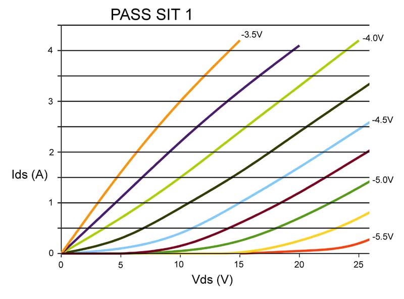

Here are some transfer curves for the SS I have.They are done at 24V
then there is teaser ......... what's possible with same technology
as common and proper Greedy Boy , I'm salivating to see something as that on free market ......... while as eternal Pa's orphan I wish all exclusivity to stay at FW and PL stable .....
just look how is laid 22/4 line , across Ugs curves .......
they're made exactly for common FW PSU !!
edit : you can also see what's proper way for drawing triode curves , needed for proper graphical construction of stage ....... as in yore
