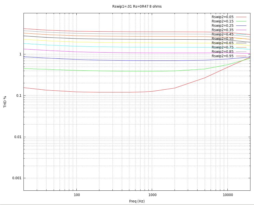

Here is a simulation of the Zen Pot with Rs=0R47, and the top-cap connected to the source pin of the top FET. Rswip2 is the wiper position of the Zen Pot which is across the bottom source resistor. As you can see, the distortion levels go above 1% with Rswip2>0.35.
(non)degeneration , while having Zen Amount pot on lower one
then put pot on front plate , and write SIT 1 wannabe
😉[/QUOTE]

btw - if one is keen to have Zen Amount pot , it's better to have it in form of switch(ing attenuator)
resistor net is more than easy to calculate ,even in case of congesting it in some central area of setting
that way symmetry between channels is easier to mantain
say that 2-section/12-position Lorlin is good for 2 channels in same case
or whatever combination
