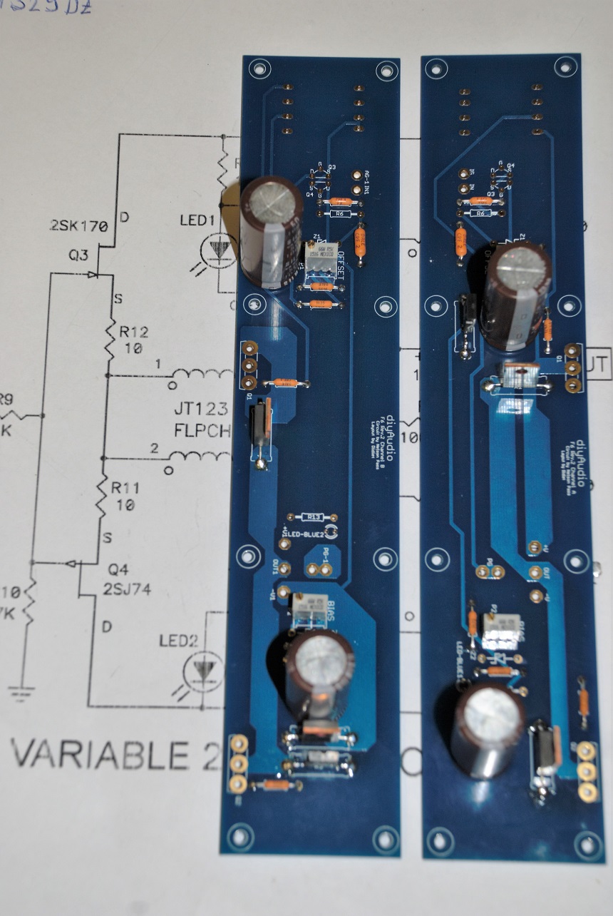

Am I right, that lm329 has reversed polarity compared to LED?
No more questions now.
Yes.
Was this an inside joke? or should one point the arrow the other way when using the regulator instead of an LED?
Or just follow the schematic and the datasheet for the LM329?
Please note, I am a complete idiot to electronics. (And for everything else, but that's not important right now.)
As I understand it, the LED forward voltage is giving you about 1.8-2.5 Volt across it.
LM329 a zener-like device, with reverse breakdown voltage about 6.9 Volt, with better characteristics.
So you have with it a broader setting window.
If I missed something, there are smarter ones, who can correct me.

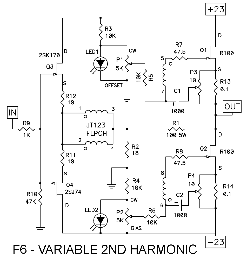

Hello Gyuri,
thanks for you patience and help.
I've one last question, do you mount P3 and P4 or only P4 and how do you trim them?
Ciao
Guglielmo
