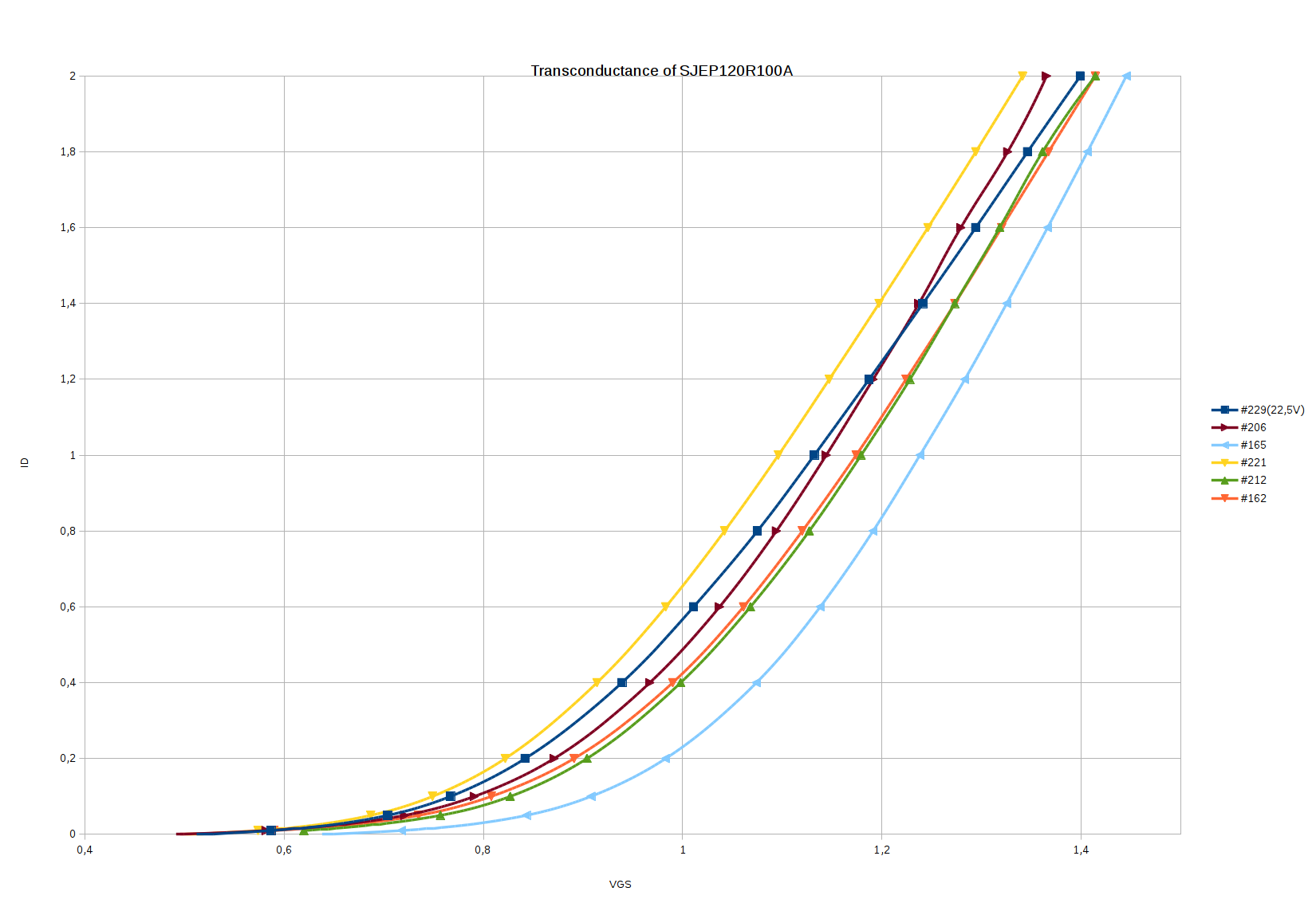

Hi Gyuri,
I don't want to capture your thread, I hope you don't mind!
Here the guys said "just show us the transconductance curves of your JFets, and we say where to mount so it sounds best!"
@all
This is what I did, and I learned that even if you use quality measurement cables, check their connectors for even slightly corrosion. (I measured them really more than 4 times, this is no fun, until I realized the contacts were my bug in my setup.)
So, I have 6 JFets, which 4 to use and in which position? Many thanks!
@all
Nobody here with an educated opinion? Perhaps I'm just impatient, but I'll just to add the Semisouth JFets and pull cables...
You have a couple Jfets that have odd curves. My tendency is to mistrust the measurement, but assuming that they are correct, you don't have two good pairs, so you are gonna have to select two sets with similar curves and tweak once in circuit, using measuemts.
Dear Buzz,
I really have done at least four times the measurement of all devices. very strange is, that they vary all a lot. I let the heatsink settle at 2 amps, then dialled in the Vgs for the corresponding Id points.
These curves are the smoothest I've got.
Temperature variation is of cause there, but all measurements were taken in "short" time, as quickly as possible.
I read that it's good to put the one with higher transconductance on top, but how much would be optimal? Just because I've two pairs with the same distance in the curves.
I appreciate your comments and thoughts a lot, thanks.
Matthias

Pick the 4 with the closest curve shapes. Because they are biased by a voltage reference, it will not matter that they may operate at slightly different VGS values. By having fets that are more similar, you will have an easier time tweaking a circuit through other means, I.e. Source resistor variation and point of feedback.
