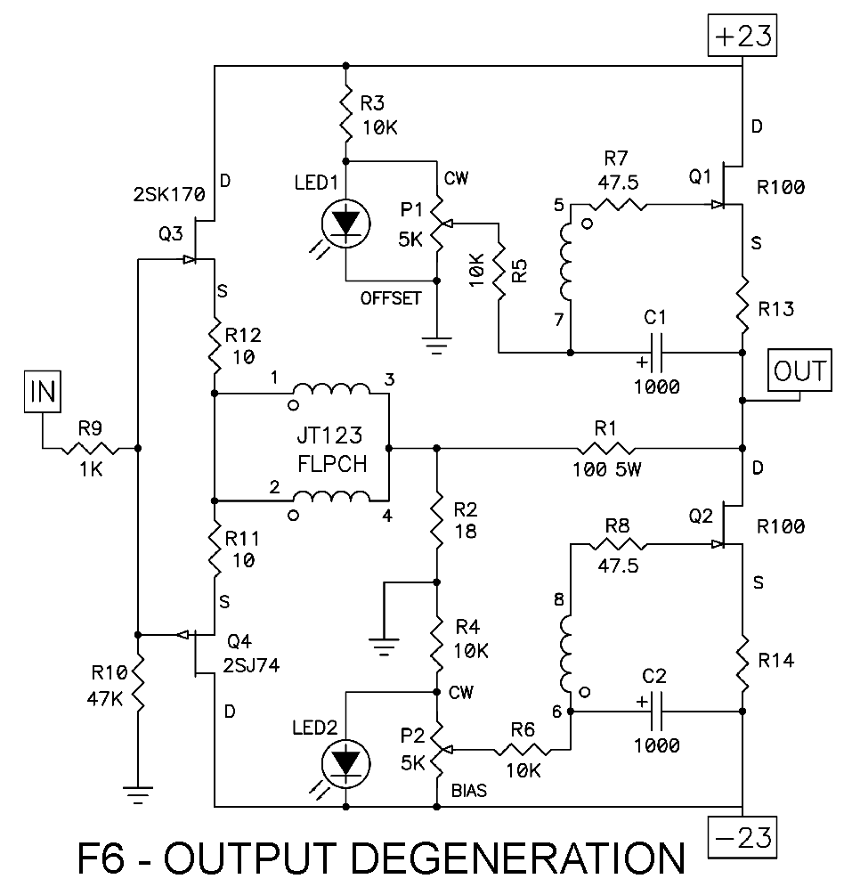

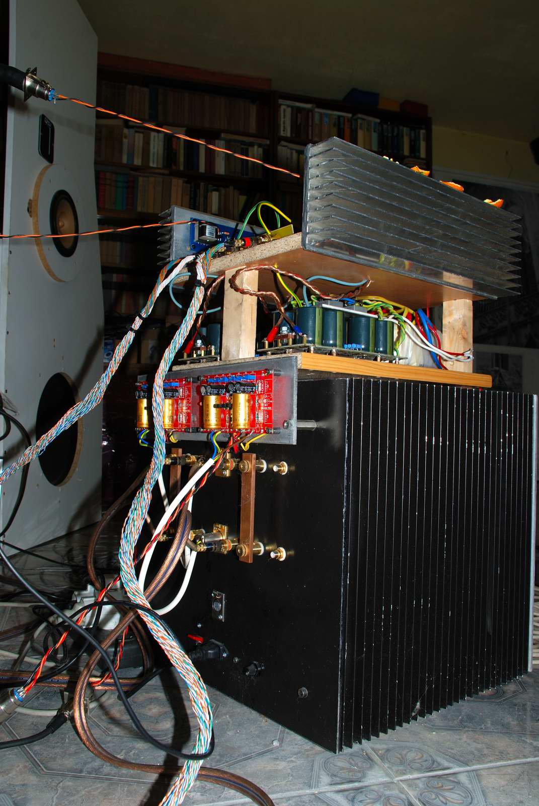

IRFPs has shorter legs, although screw was secured, but it wasn't connected to source leg.
It is now settled down at 1.82A, with minimal drift.
DC offset changing between -15 +10mV as amplifier is playing.
It has a marveolus sound.
I didn't play with 10Ohm pots yet.
If one hasn't have SemiSouth parts, regardles of it, it is a must have to build piece.
And you do not have to constantly scared, what if...

Unwittingly, I developed the amplifier, which needed for preheating, to reach proper quiescent current. It can be done with heat gun.
I should build in SemiSouth fets.
Before it I would like to make some measurements with IRFP250s.

Would you be willing to do an experiment on my behalf?
Start with both pot wipers at source pin.
Assuming your pot is a single turn pot, then turn pot on bottom mosfet 1/4 of a turn, so it looks like this.
You may as well repeat the same experiment for the top mosfet..
Start there then just keep turning till something sounds good.
Then tell us what values you have across pot and wiper.

Sweetness is back!
SemiSouth JFETs are in place..
They sings me, like angels in heaven, for greater glory of Pass and SemiSouth.
If we can be considered Steve Strauss as an angel.
But why not?
