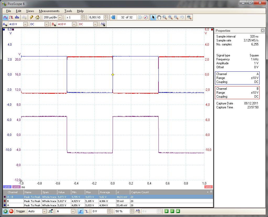

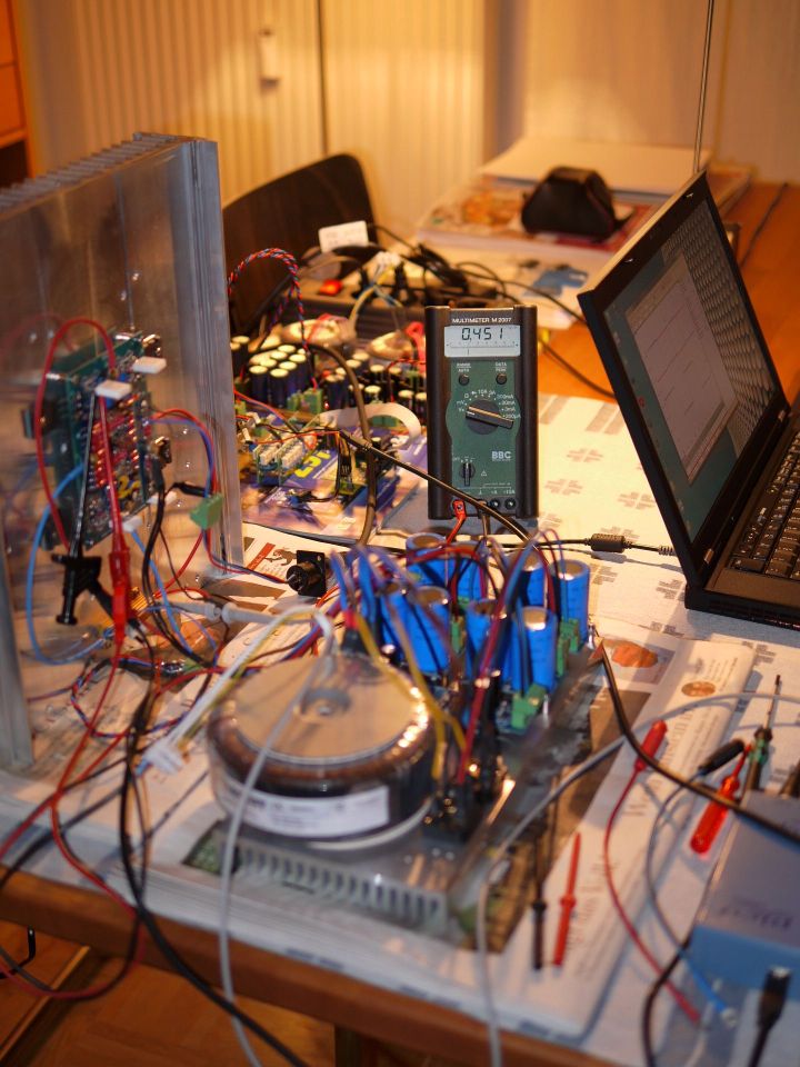

Attached a picture from my "kitchen table" 😀 and an additional scope plot. For this I've used my UGS-based preamp as a single to differential converter to get a balanced input voltage. The cheap USB-scope with build-in waveform generator doesn't give such a voltage. Now the results are much better than the former one, even without the cascode devices.

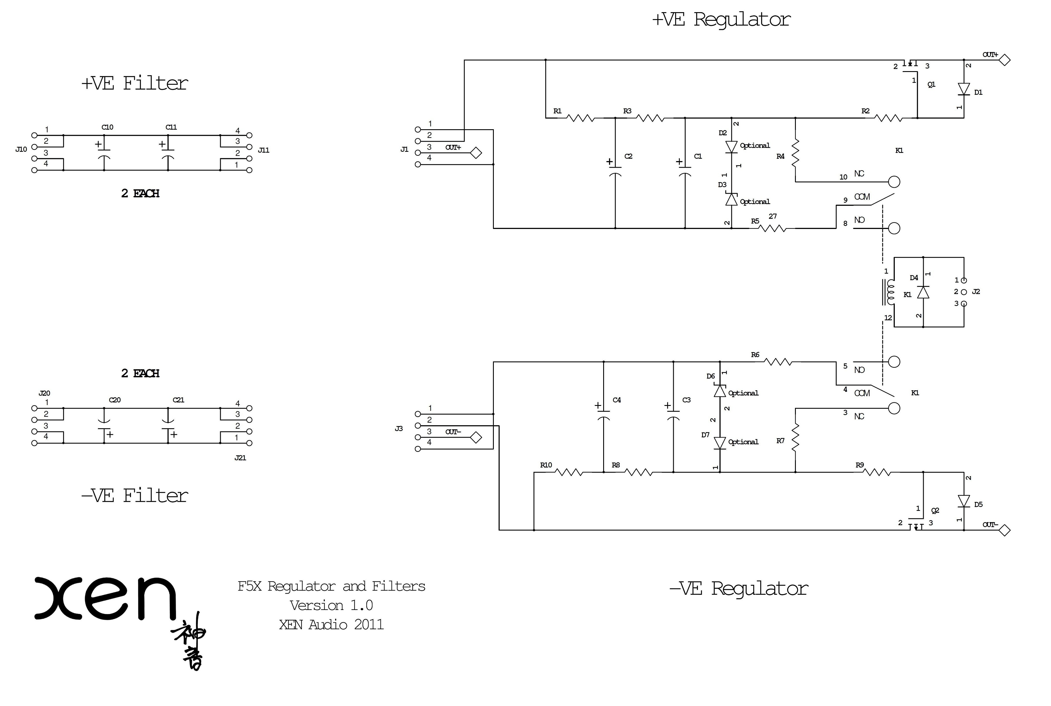

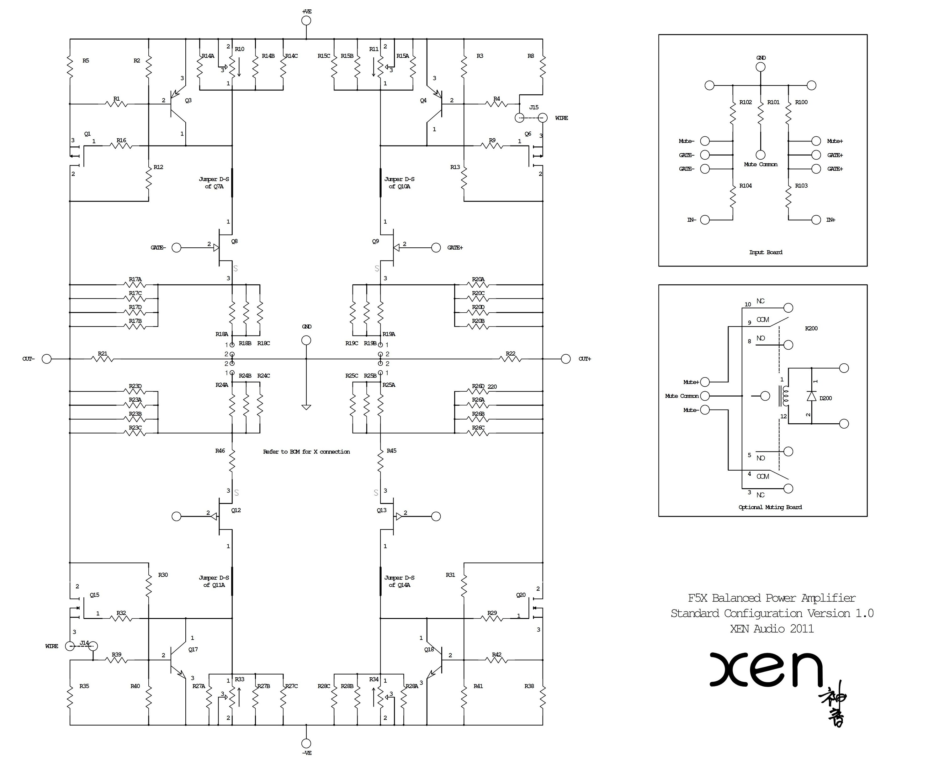

I know everyone has been waiting on technical details. The release schematics and the bills of materials for EUVL's F5X are here-
The build thread is in progress and will be posted as soon as the rest of the performance testing is complete, just a short few weeks away. We should also have some additional quotes for the PCBs back in the next week so that Patrick can make decisions about the PCBs for the case groupbuy participants.
Enjoy!
Dave
(file size limitations required splitting the amplifier BOM into three pieces)
"Edit : To avoid confusion BOMs are now only available here : F5X -- the EUVL Approach - The Build Thread"
http://www.diyaudio.com/forums/pass-labs/208880-f5x-euvl-approach-build-thread.html
