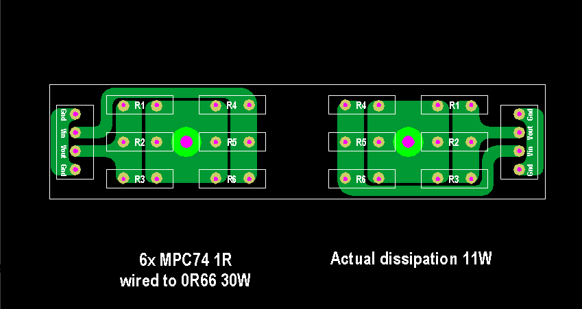

looks good, man those are some serious output PTH!!! what are you looking to solder the output wiring with an arc welder? what awg is that? 1|0?
I specified 4mm holes.
For the middle hole, I recommend using a M4 brass standoff plus brass screws and nuts to connect the main PCB, daughter PCB and Gnd wiring to the regulators and input XLR.
For the speaker outputs, you may use the same, or consider using 4mm copper tubes as output connectors.
As to soldering, according to my experience, there is no problem if you have a hot iron say 100W, even using lead free solder. Preheating the PCB in an oven to 80°C would also help, but not essential.

aaah yes ok that makes more sense. i wonder if anyone makes copper standoffs? brass hmm i'm silly like that; i'd probably just use it like that till tweaked and replace with copper soldered. it wasn't so much the gauge that worried me, but the combination of gauge and being the centre of a pretty chunky ground plane and output ...ermm..trenches (trace just doesn't quite say it) that can suck the heat out of the iron as quick as you can give it. preheating the pcb would help.
looking good though; it takes 'low impedance ground node' to a whole other level

For those who might be interested, I did a CRC PCB for the F5X case as alternative to the regulator.
It has about the same voltage drop (2.7V) and hence dissipation, and uses 12x MPC74 1R per channel.
Board size is same as the regulator PCB (134x30). Same mounting, same wiring and connectors.
So direct replacement.
When there is sufficient interest, you can get the PCBs from us via a GB.
Patrick

Eventually yes, but we have a couple of minor issue to sort out first.
Do bear in mind the regulator is only one option.
There are people who swear by passive power supplies (e.g. THEL in Germany).
And NP is also using passive (CRC if I am not wrong) in his production F5's.
Especially in a balanced Class A amp, where the current draw is constant.
It is something worth trying out, IMHO.
Patrick

Don't forget Patrick that I will be testing a single transformer/dual CRC supply board version for comparison as well. If it works well, it will provide another, lower cost option for power supplies...
Similarly this testing will be a follow on to the full version with the regulators, so it will be a bit more time...
Dave
PS - bench supplies are here 🙂 and repaired... 🙁 more testing this weekend.
