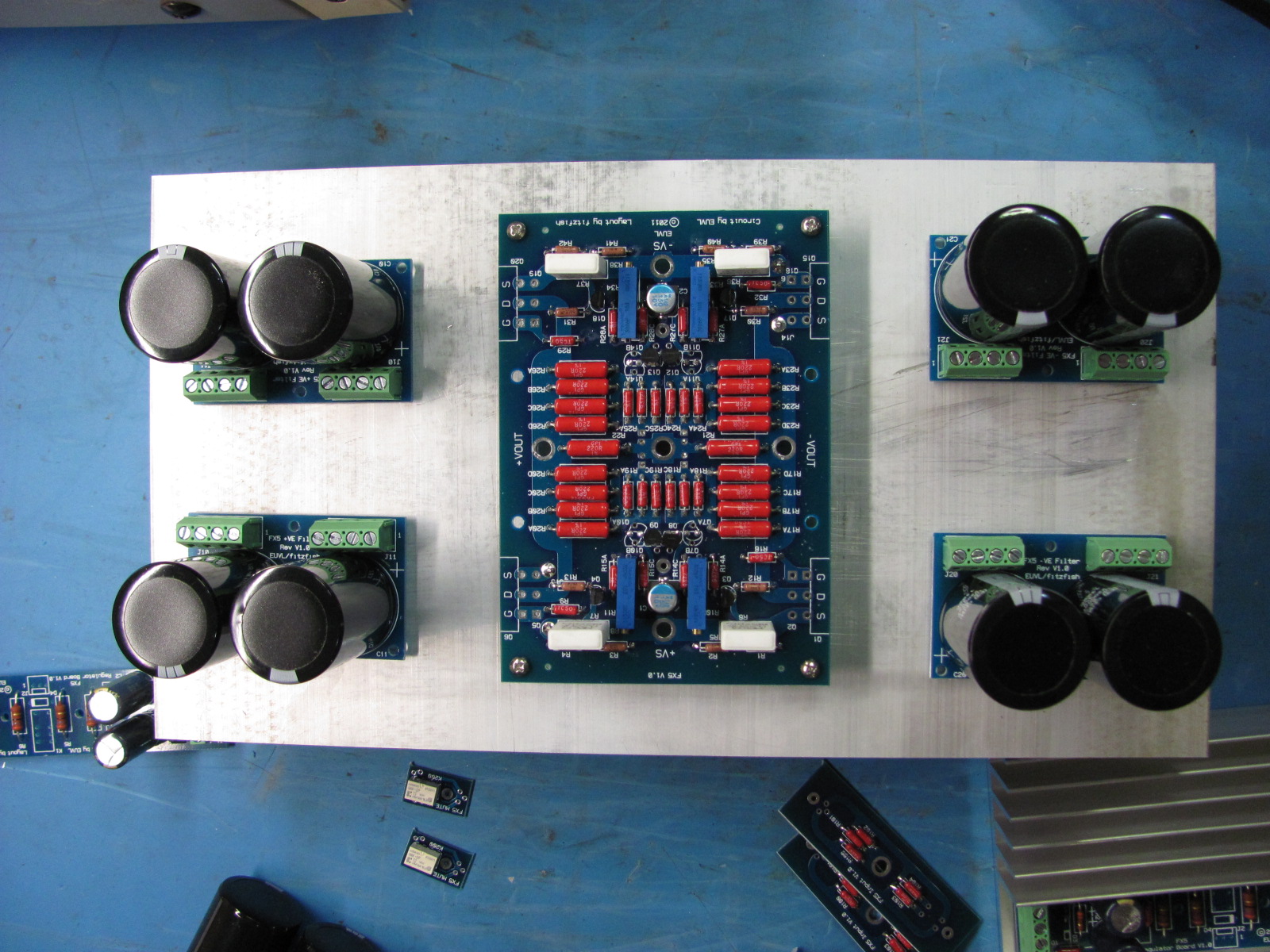

Another test team photo from today ...
Patrick

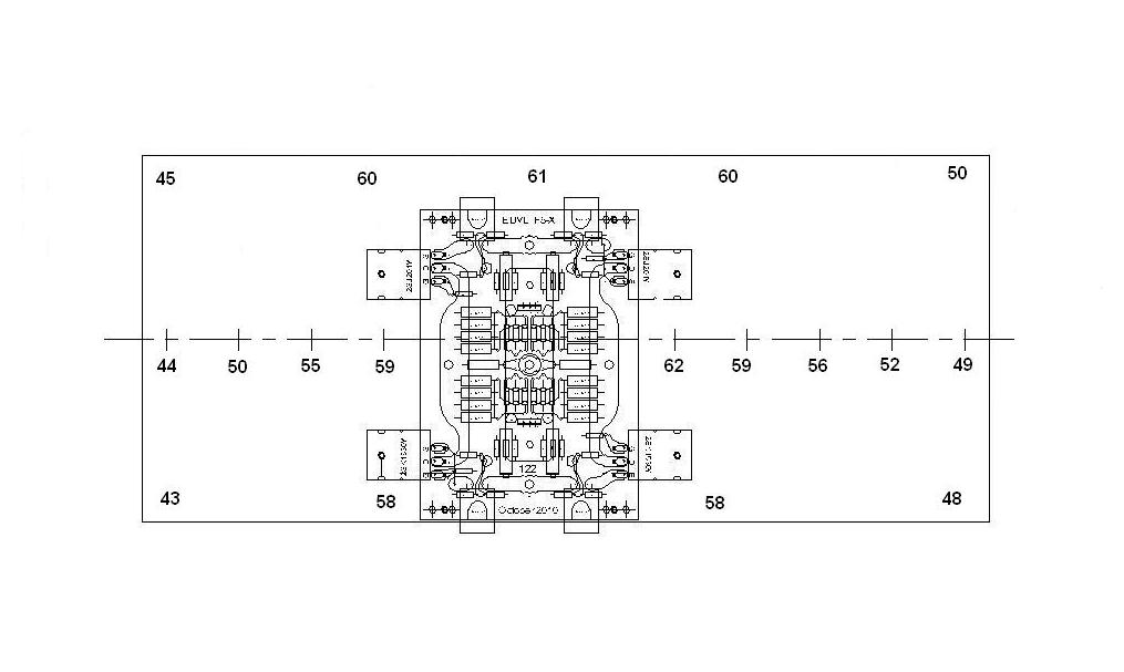

Heat Sink Temperature Distribution
Somehow we have not heard from Melon Head all these days.
And I was still hoping for a temperature distribution measurement.
Luckily our prototype is functional today, and Mark has kindly taken the time to do a measurement.
As you can see, my simulations were not too far off.
Measurements were taken 1 hour after power on, with +/-16V rails, 4A bias.
Patrick
Looks like the simulations were pretty close. The edges furthest away from the FETs aren't as warm as the simulation suggested, but that's probably due to the closer grouping of the parts toward the center of the sink.
I guess the most important part, are the temperatures around the FETs themselves, and those look to be close to what you were anticipating. 🙂
I said before that simulations are accurate to within 2°C.
Just people do not want to believe.
Actually due to additional heat sinking by the front & rear panels.
Patrick
If the model is good (= close to reality) and the simulation is good (= close to reality), then the prediction should be close to reality.
It's when the model is poor or the calculation method is poor that the prediction can be much worse than poor, or fluke upon a chance answer that is close to good.
The user has to determine the reliability of the simulation before the user can rely on the predictions. That is fundamental to all software used in engineering design. One must be able to check that the predictions are close to correct.
