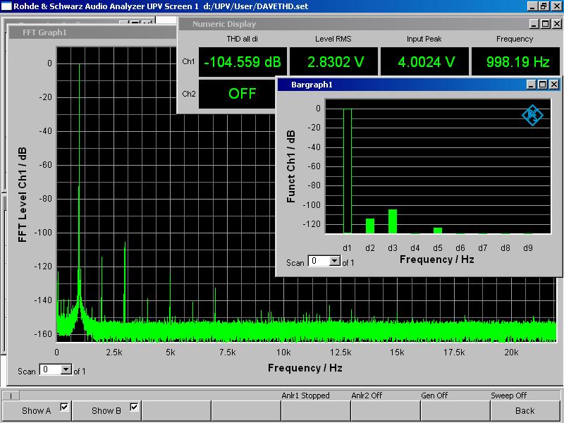

Thanks Patrick.
It is exciting to see them working. I'll start with a taste of the measured performance and promise to post many more in the upcoming build thread.
This is THD in the grounded X configuration, 1W into 8 ohms. After some additional testing I'll be switching to floating X.
The total harmonic distortion is around 0.0006%.
More to come!
Dave
More to come!
Dave
You can see the balanced circuit and the good matching at work here, as all even harmonics are almost 10dB smaller than the next odd.
Only when you see distortion spectrums like this do you realise why there is so much fuzz about matching, .. etc.
Patrick
Patrick
