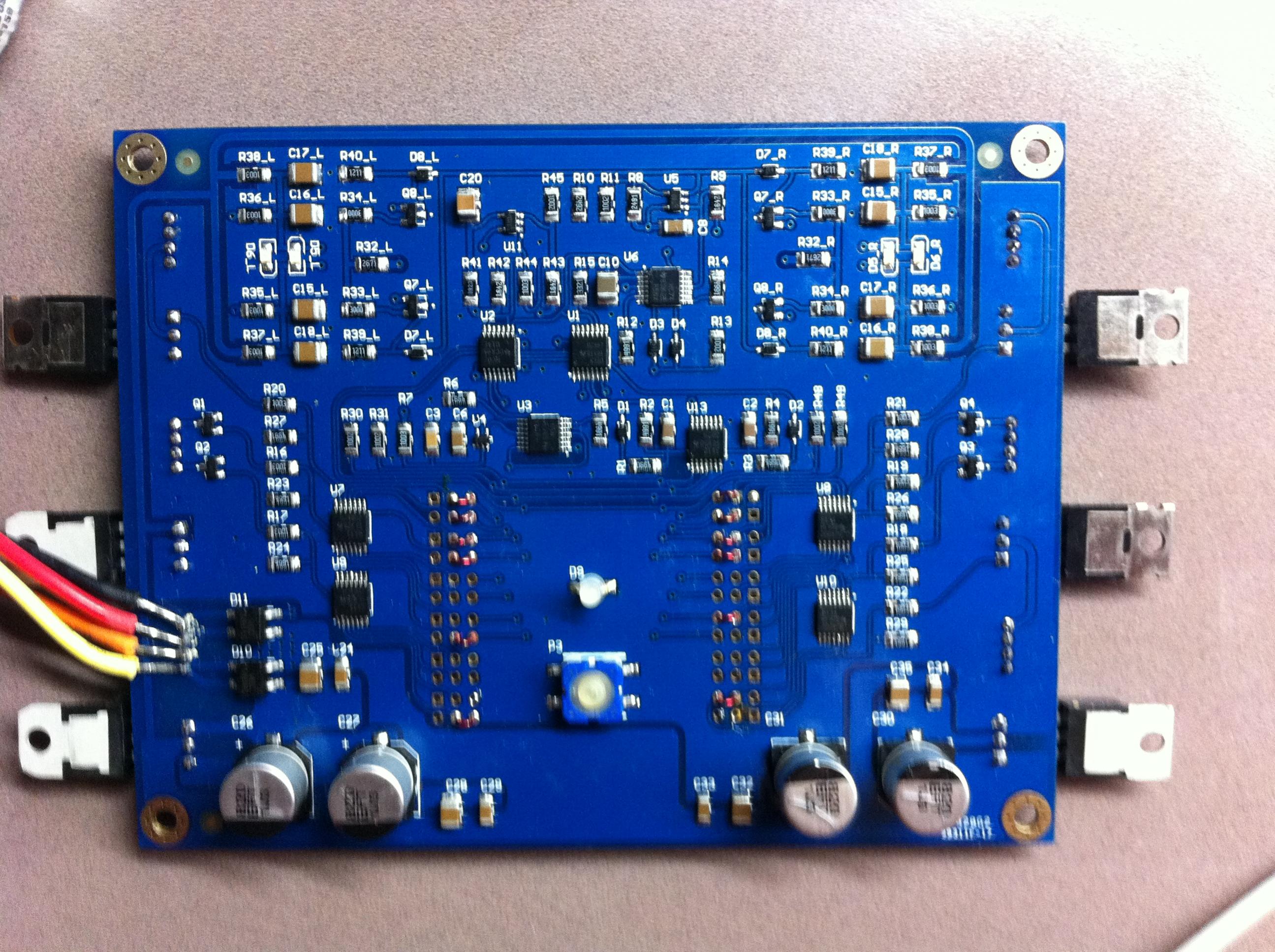

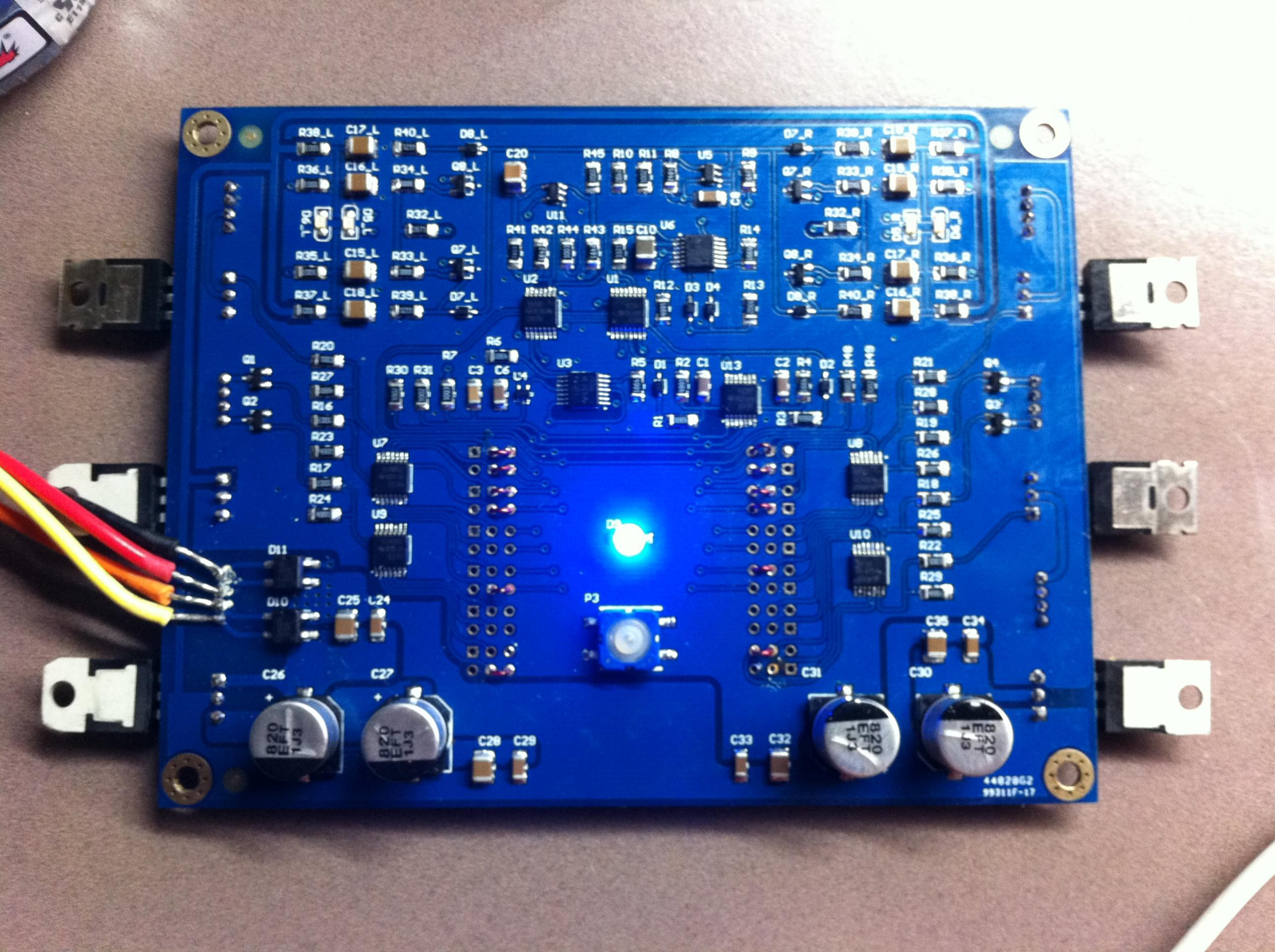

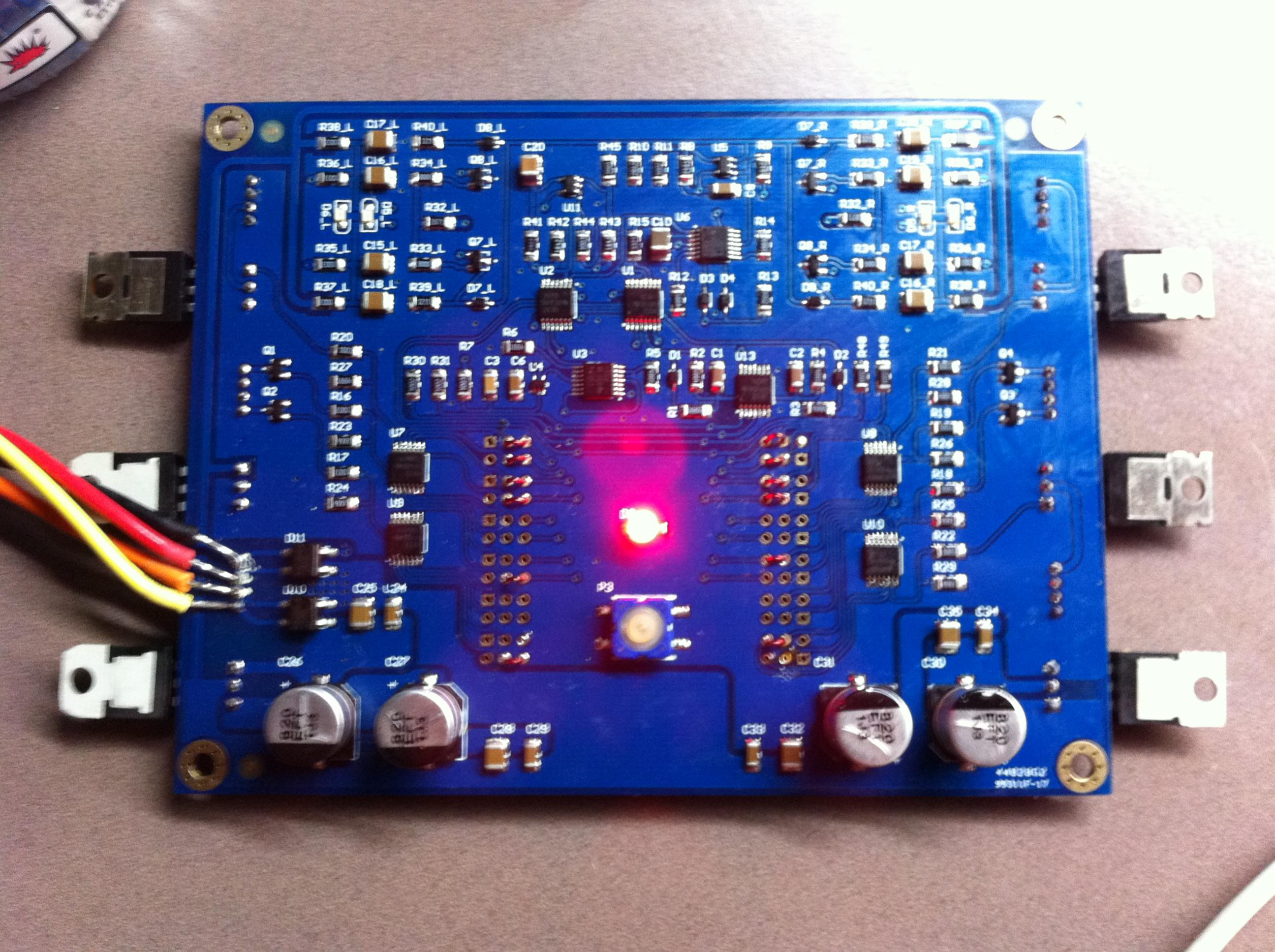

A further update.
The revised protection board has been fully tested, including thermal tests, without issues.
I'll let Alexis give you the details himself.
Give it a few more days, and we'll let you know about GB for the PCBs.
Component GB you need to organise yourselves, I am afraid.
Schematics and BoM of the protection will follow tomorrow (from me).
Patrick
Patrick
Thanks patrick, Yes it all works as expected, here are some photos to do you guys over until the BOM and schematics are published tomorrow.
I look forward to posting details on a component GB soon if people are interested, also those who have already paid for a component kit, PM me, and I will arrange shipping with you.
Thankyou everyone for this amazing opportunity to serve this amazing community.
Alexis
