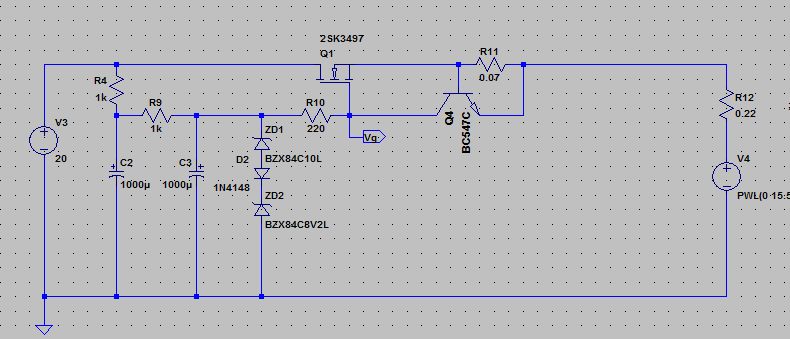

Here are my two pennies, a futher option for rearranging the F5X protection concept that I would like to throw into the game (Let´s mess up the original design a bit, that´s fun 😀) :
Let´s start with the design objectives:
1) The system shall provide speaker overvolt protection for the following error cases:
a) DC voltage provided by the line signal source or by connection error
b) Amplifier internal error, like defect devices and loose contacts and shorts
2) The system shall provide over-current protection for the following error case:
a) Overcurrent because of a short between amp and speaker
3) No relay contacts in the signal/power line
Although I did not made a thorough investigation of current depentend relay contact resistances I am pre-occupied enough now that I dicided that I would not like to have any relay contact in the signal path. In other words the best relays is no relays. Not even mercury wettet relays could beat that.
4) No current limiters on the amplifier board because the they become active very close to normal operation range ( >3A) and hence could give rise to signal distortion.
Now let´s assume for a moment the second 44,000 uF cap is out so we do not have a CRegC but just a CReg.
The first step of my proposed solution is to move the current limiter from the amplifier board to the regulator board and adjust it such that it limits the regulator output current to say 10A (see attachement). Since no energy is stored in the amp also the amp power devices are protected against overcurrent herewith.
Next I can insert a shunt relay in between the CReg and the amp. Since the shunt relay is shunting a voltage regulated but current limited source now shunting should be a save process without any damage risk for parts. I am even considering a solid state relay for shuning to get a clean shunt action instead of the nasty bouncing of mechanical relays.
Now the question is what to do with the C I have taken out for a moment.
Well there are serval options but I have to admit that I do not have a ready answer.
1) Maybe I could just leave it out here and add it to the first C -> CCReg.
This would be the easiest way but I am sure the designers had a good reason for this C. So I need to check the impact on SQ.
But if I would like to have the C back to the orignal position I need a current limiter for the C:
2) Connect a fast low current rated fuse link in series with the C. If I understand correcly the main purpose of the C is to help with a low output impedance for the CRegC but not for high current capability. And since during startup the C is loaded gently by the Reg softstart feature also during startup a low current fuse should work as well.
3) Are there any other options for a current limiter for the C ?
Patrick, I am almost sure you have one 🙂
Remarks and suggestions are appreciated.
Markus

All regulators becomes inductive at HF, that is why you always see C's after regulators.
So for me no solution with CReg-no_C.
Current limiting follower regulators are plentiful around. You just need to google.
http://www.pmeweb.co.uk/Audio/psu.pdf
But they will cause current clipping in case the dynamic impedance of your speakers goes low (say < 1ohm) in a transient.
So I most certainly do not want one in my supply line either.
If you do not want to use a shunt relay at the amp output, then just use a relay to cut the CregC completely from the amp.
You immediately discard all stored energy.
The relay contact will see constant bias of >= 4A all the time during normal operation, so it is not likely to have inconsistent contact resistance.
And any noise caused by the contact can be filtered by a 1.5µF MKP, as I suggested in #805.
So thus far no better solution as the two I already described (shunt output or after CregC).
And I shall continue to use shunt speaker relays, as I have been for the last 10 years.
