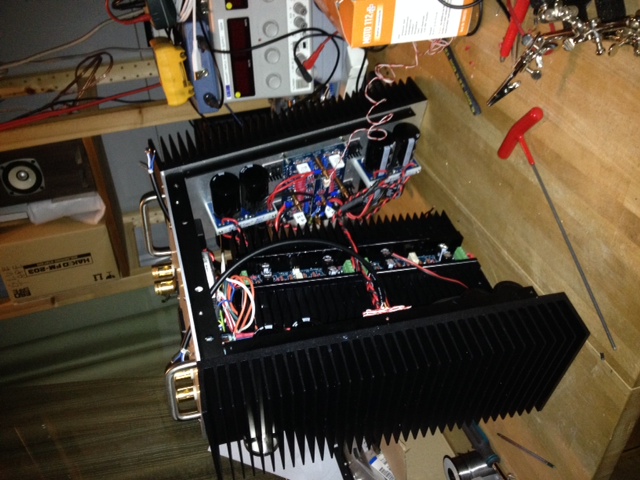

Dear All,
I am in trouble, everything is connected, but I cannot install the screws that attach the heatsinks to the rear and front panel. Any hint ? Please note that my cap pcb do not have screw contact so the bridge wire are soldered.

Davide,
Can you post a couple of pictures of the issue and current state of your build? The final assembly can be a bit tricky as everything is closely packed into the case.
Attached two pictures:
The problem is the following. I do not have screw contacts on the cap boards, as my caps were too big. So I had to hard wire the caps boards to the rectifier. This makes hard to extract the PSU from the rest. So I thought I could manage to wire everything and make the mechanical assembly later, but it does not seem possible.
Specifically, to attach the rear panel to the heatsinks there are three screws on each side. the central one is behind the relay. If you assemble the heatsinks and the rear and front panel, how are you going to connect the wires of the main for the transformers ?

Davide,
I understand your problem. With the transformer cradle in place there is not room enough to access front and back panel mounting screws (or any other mounting screws for that sake).
Therefore the cradle is the last to go in, and only when everything else is assembled/tested (see also Horio's excellent chassis mounting guide). This is actually a nice feature of the amp and the operation is made fairly easy by the screw terminals on the cap boards.... - which you don't have🙁
You should however also be able to disconnect the cap boards from the cradle using the screw terminals on the regulator PCB.🙄
It is likely that you will need to remove the cradle a few times to access amp and control boards so I would recommend that you keep this operation as simple as possible.

There are two connections that are hard wired between the cradle and the rest:
The main for the transformers
The bridge to first cap connection.
So I guess the only way out for me is to figure out some connectors to attach to the cables to try to overcome the lack of the screw contact on the cap boards.
Nic, the rear panel has the central screw that is covered by the relay. How did you install relay-screw=wire etc ?

Davide,
You can try to assembly the whole case first without any electronics and the Back Panel.
Then install the aux. PS, power switch etc. on the Back plate. Then you can install the caps on the 2 sides.....
The last to install is the cradle assembly after fully test.
