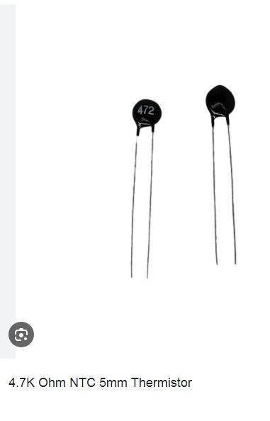

Just ordered 10Pc 4.7k thermistors marked 472.
My problem they all measure only 3.3 to 3.5 K Ohms with my DMM.
Can I use those or must order from other source?
It is so annoying to order a couple Dollar value parts and pay 4-5 X as much for the shipping cost and who knows second times they measure the same!
Please guys let me know.
Thank you!
If someone has at home some extra I would like to buy it and send it in an envelope.
Big companies does not ship in envelope, right now I do not need other parts.
