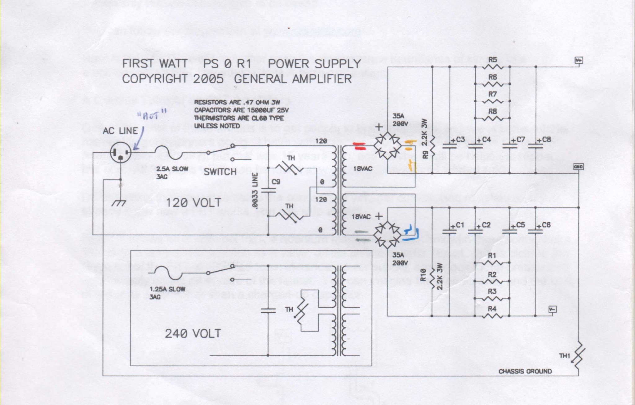

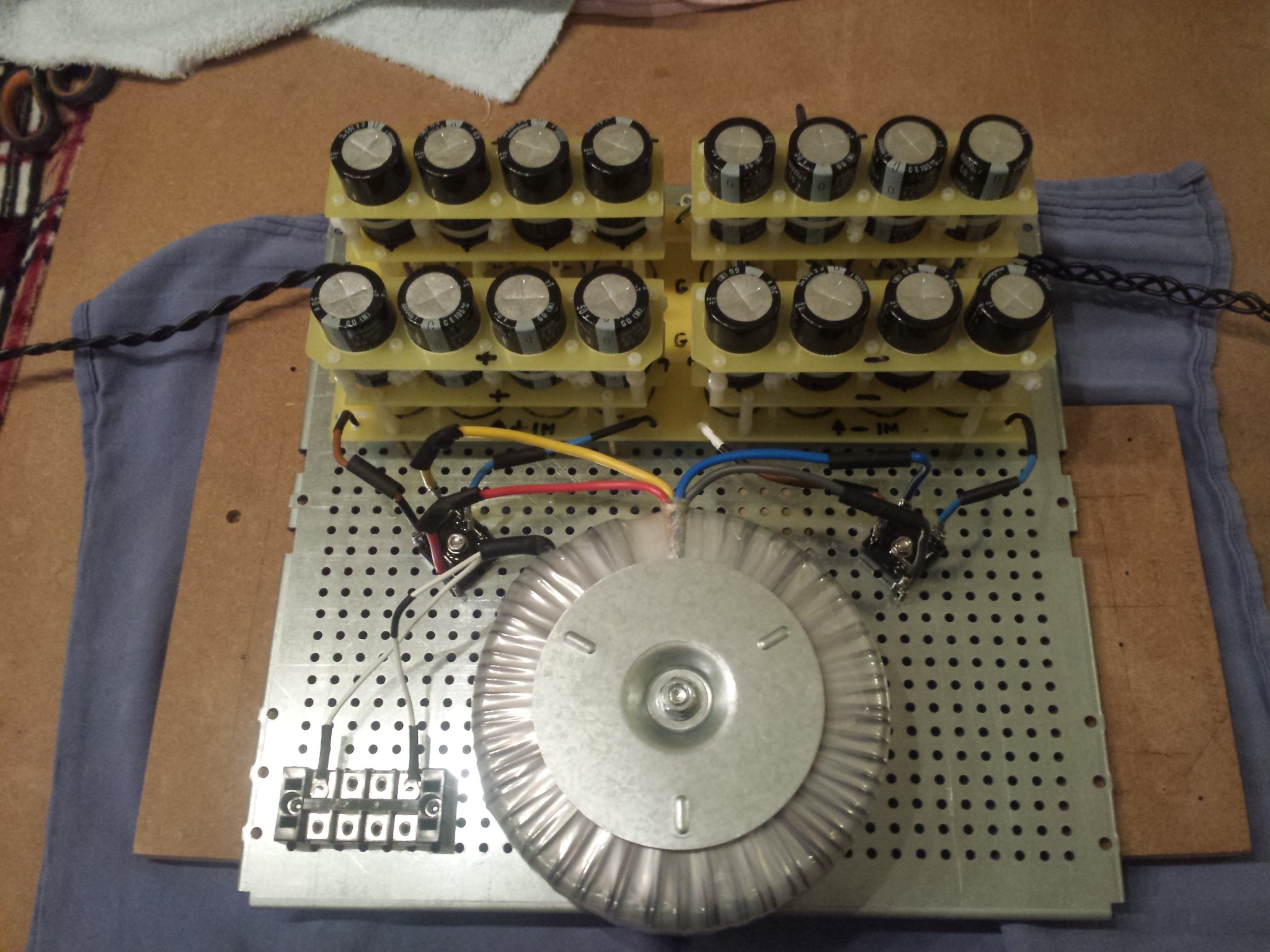

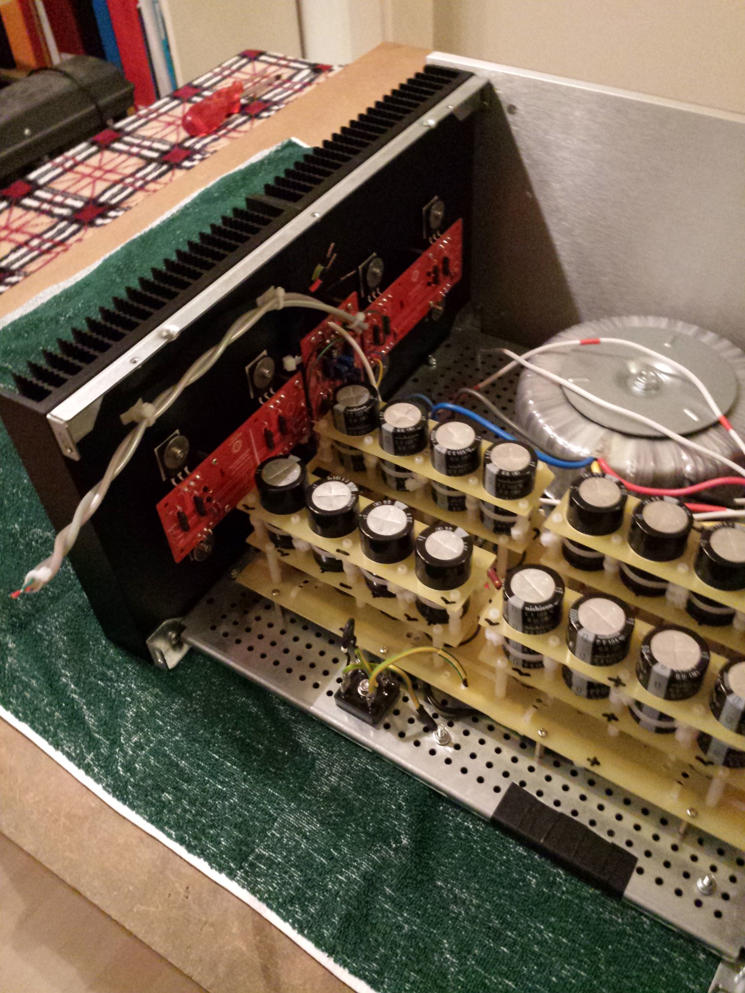

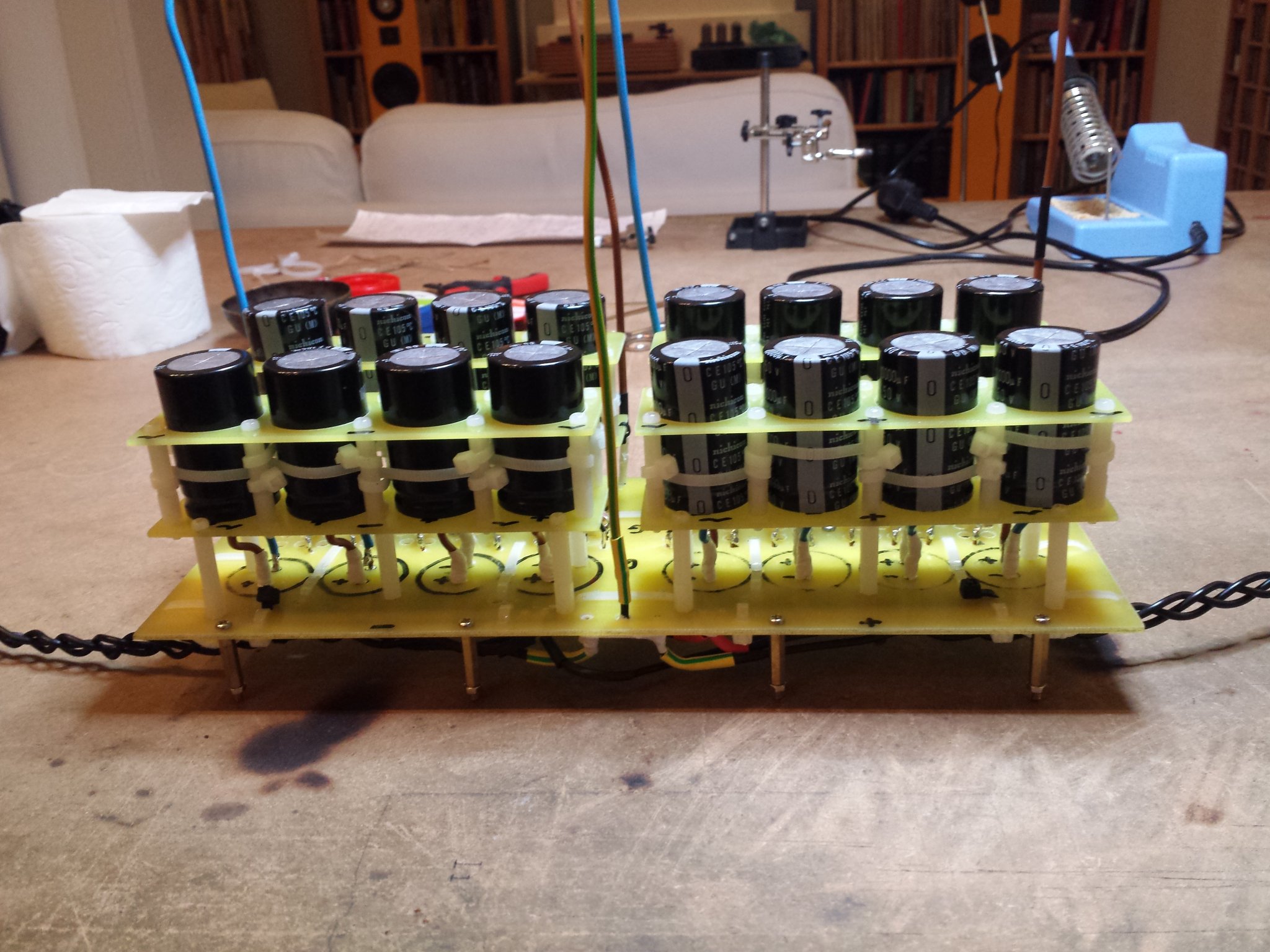

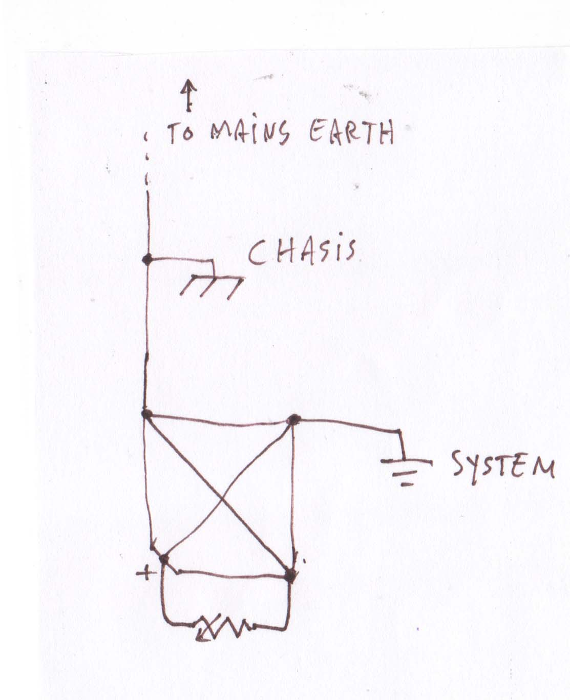

I finally finished my F5T v2 build, but now I hear a soft 100 Hz 'clicking' (ripple?) noise from both speakers, independent of the volume setting on my pre amp. It is only present with a source connected. With nothing connected to the inputs and with the inputs shorted: no noise. I build a PSU to my own design, according to de FW PSU schemetic in the picture. I also made a bridge rectifier 'ground lift' wired as in the drawing. I also included some build pictures. Does anyone have an idea what could be wrong? I myself haven't got a clue...

I used to have exactly the same problem: F5T with very similar PSU. Humming when both inputs are connected. Dead quiet with no input connected, but also dead quiet if only one input is connected. Might want to check if the hum goes away when you disconnect one input. In my case, this was caused by a ground loop in the chassis. I connected a ground line from PSU to amp board, but also had the input at the RCA conector connected to ground. The ground loop was from PSU to F5T pcb, over pcb to input gnd line, by cable shield to RCA mantle connection, and from there again to ground. I just disconnected the GND line between PSU and F5T pcb. I noticed that Nelson Pass does the same in all interiors of First Watt amps. I carefully studied the wiring on internet photos of FW amps, and in most cases only saw +/- PSU voltage, no ground wire. Each amp board only has one connection to system ground. That took away all hum from my amps.
Reactions: SRMcGee
every FW amp I know of, having bipolar supply, is having GND wire taken from PSU and leading/connected to channel pcb
then, from same point on channel pcb, GND wire leading/connected to speaker post
Hot and GND thin wires then going from channel pcb to input RCA, isolated from chassis
