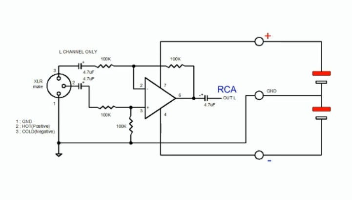

I have implemented the input (FE) board with an additional board to convert the input signal from balanced to unbalanced, I used a schematic I found on youtube, as an op-amp for the realignment of the inverted signal I used the Ti LM741 (one per channel), attached is the circuit diagram,
(requires dual +- 9V or +- 12V power supply)

Tricksters, that is a nice input circuit! A differential amplifier. Question: the PCB has a few caps more, and a semiconductor device on a heat sink, which do not seem to be in the schematics. What are those? I am especially curious about the semiconductor device. Is that an output buffer, like an emitter follower?

Why not try Nelson's front end circuit. https://www.diyaudio.com/community/threads/diy-front-end-2022.394339/
Thanks Eslheadphone! Forgot about that one. The schematics are easy to read: a long tailed pair and a class A second stage. Beautiful! And probably much less noisy than the staple 741 opamp. Will order a set from the store and build it. I might go for a 0 dB gain, because my F5T already has enough gain: I just want to add the option of having balanced inputs. Or I might replace the 100 k feedback resistors with an Alps potmeter, and then have variable gain.
