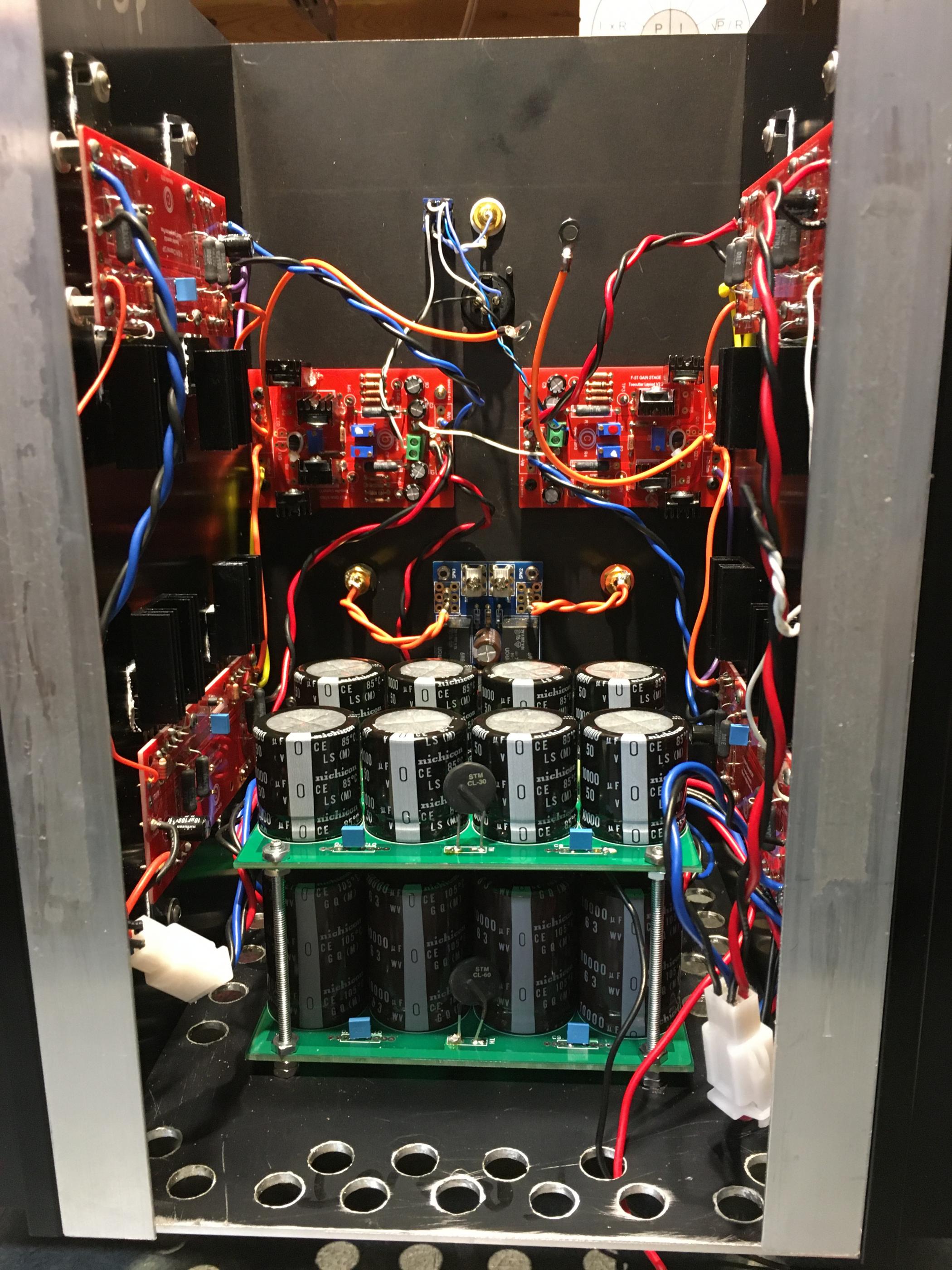

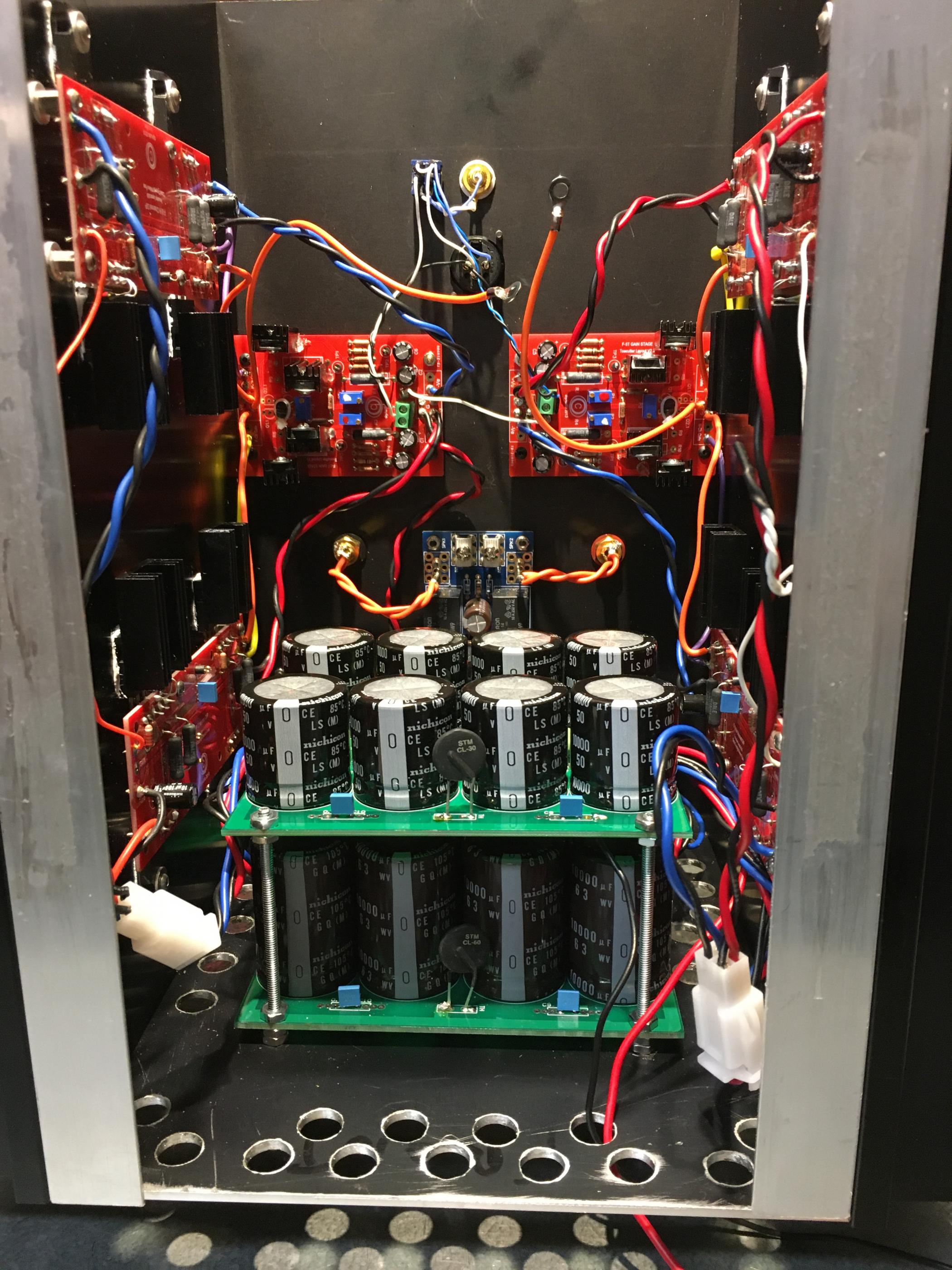

I forgot to add, these are Balanced F5t v3, the 2 FE boards are connected together using the "link", white wire.
I am in need of advise, I'm currently attempting to adjust bias and DC offset on my Mono block F5t v3. I have separate power supplies for each channel, my first attempt resulted in a very burnt Q3 where the Gate pin dissolved off the MOSFET.
I have 51vdc on the rails under no load, when I was adjusting bias the first time, the rail voltage was a very steady 48.1vdc with 200 mV of bias. My heat sinks are 10" wide X 14" tall with a 10mm base and 2" fins.
Each channel has two FE boards, 2 P channel boards, and 2 N channel boards. I have tested both mono blocks using the dim bulb tester and everything is good even with the output boards connected.
How do I measure DC offset? My first attempt, I had the DVM connected to each (+) & (-) output leads to the speaker terminals. No matter what adjustment I made, no noticeable difference was noted on the DVM for DC offset.
My other channel mono block is ready for adjustments and I am VERY unsure as to how to continue.
Should I measure DC offset for (+) to ground and adjust that FE boards P1 & P2?
Then do I measure (-) to ground and adjust the other FE board P1 & P2?
Here is a photo: Orange wires are OP, Red V+, Blue V-, Black is ground, Yellow is P channel gate and Purple is N channel gate.

Yes, 1 FE board for single ended mono blocks, I'm building Balanced mono blocks which use 2 FE boards. After typing before, I think I should treat the (+) and (-) as 2 separate channels. One FE board with one P channel and one N channel and measure between output and ground for each. Just not sure if the "link" should be connected or disconnected during the adjustments.
Measuring DC offset between output and ground made a difference. I was able to adjust bias with P1 and DC offset adjustment with P2, finally able to make a difference with DC offset.
Now my problem is P channel has almost twice the bias as N channel. I had 320mV on the P channel and only 180 - 190mV on N channel.
When I measure resistance between TP2 and TP3, I measured 0.9 ohms on N channel and 0.5 ohms on P channel. All the output boards have 1.0 ohm DALE RW79U resistors.

Correction: offset should be measured towards gnd, what beats me is why your speaker neg is not connected to a place where offset can be zeroed.

I had no problem adjusting DC offset to zero. My concern is the difference in bias from P channel to N channel,

Hi Dennis -
I was adjusting OUT -, for once I was able to make an adjustment and have the DVM for DC offset respond. I was able to adjust to zero after every small bias adjust.
I'm going to set OUT- to around 275mV with DC offset s close to zero, then adjust OUT+ to 250 - 275mV and then let it cook for an hour and see.
I hope that after getting both phases close and I measure relative offset, I'm close to under 50mV.
