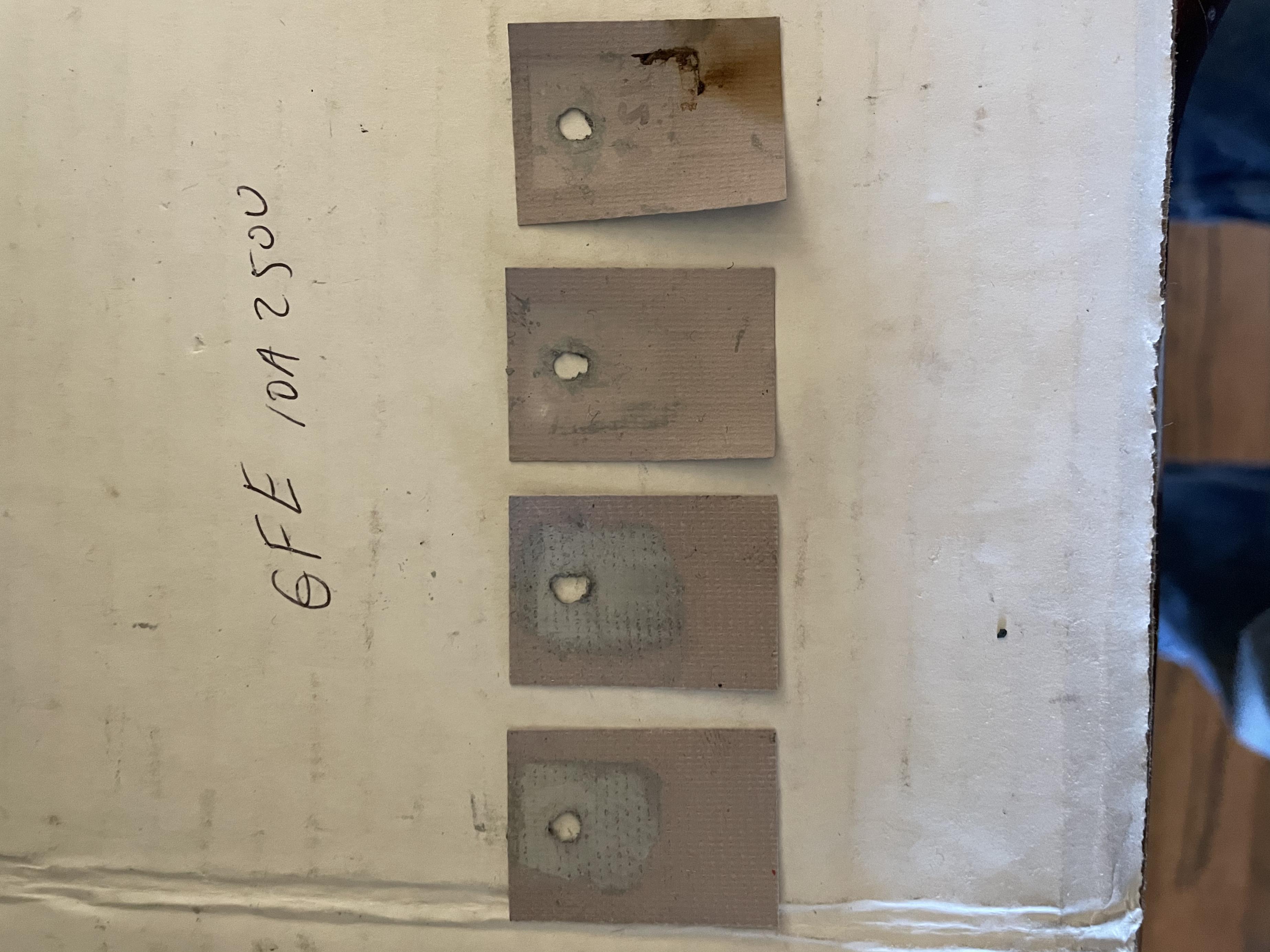

So Sundays have just became a day of expressing. Expressing you may ask? Expressing how beyond pissed off i am at my F5T. The left channel, the one that blew up last week after all of the new mosfets were installed was in my opinion the more stable of the (2) channels. The bias pretty much held steady since it was fired up yesterday. After it warmed up, I tweaked it slightly this morning and the offset was -5mv holding pretty much all day. Before I’d connect any speakers to it, I was going to run a sign wave with an 8 ohm dummy load and my scope on the output to see what things looked like. Everything is connected up and I turned the power switch. Instantly smoke, fire and more blown output fets. Not sure what to do. The only thing that changed from it running idle all day with the input shorted was now the input wasn’t shorted and there is an 8 ohm dummy load on the output. Any thoughts?

The only thing I can think of is if your dummy load was shorted to GND and somehow shorted the outputs, but I am a man of limited imagination and skills.

Looks like shorted Mosfet to heatsink (to much torque on the mounting screw) or too much heat ( too high bias?). Or something really driftet away.

Patrick and Dirk, originally I thought the same about the load being shorted out. Not the case at all, I checked and it’s fine. Then I thought the signal generator or something with the scope, that’s totally fine at least when I run them independently. As for the torque, I tightened the MOSFETS but gosh, not that tight. Basically snug with lock washers on them. I have not plugged or unplugged anything with the amp on. The only thing is the amp was fine for about 10 minutes while I connected everything up. Unfortunately I disconnected all of my meter leads so I don’t know if the bias took off at start up like it did this morning. The signal generator was powered up and I didn’t realize it was giving a 5V sine wave output voltage at 1khz when I turned on the amp. As for too much bias, it was running at 345mv’s all day and the sinks were not excessively hot at all. Could the high input signal at startup have caused this but why only the left channel again and not the right?
Elwood, I’m using the ones that come in the kit from the store SDUR60P60DT/SSG18441

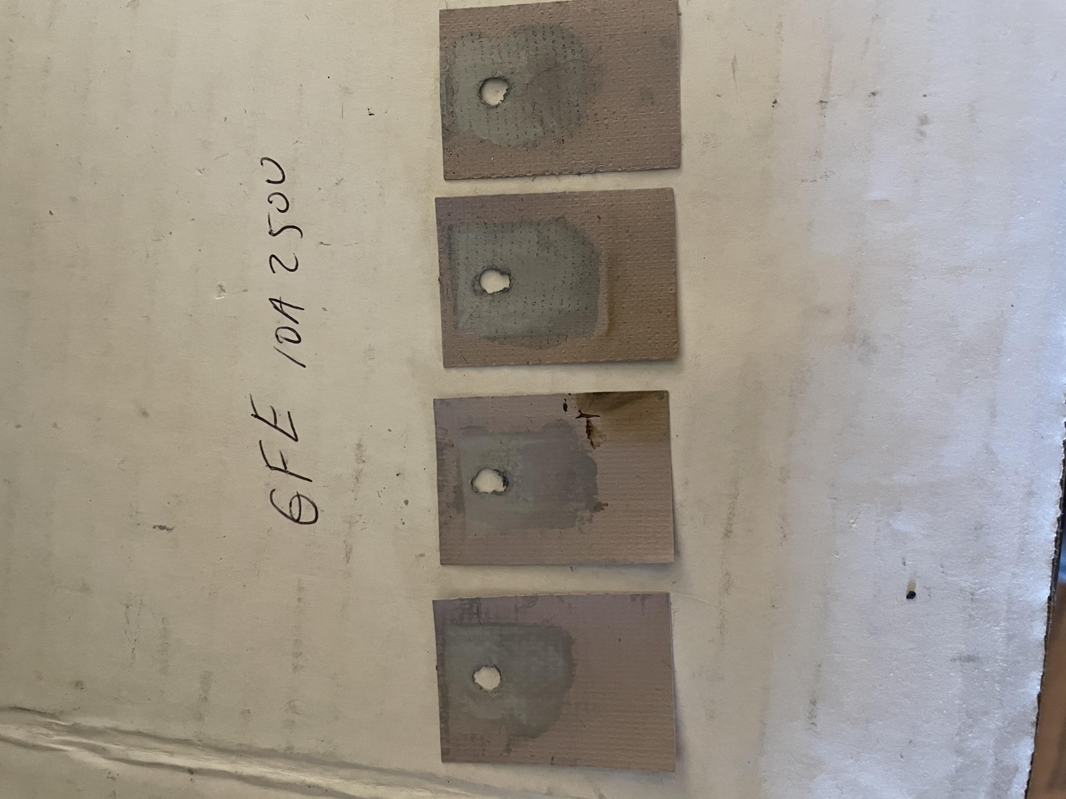

You can measure resistance between the center pin of the fets and the sink to provide som insight. It should be in the thousands of ohms range. If not, do not proceed until solved. If there was damage to the sink after the first blow up, be sure to make the surface even again. Use a magnifying glass, small bits of metal can cause such shorts, protruding from the metal and piercing the thermal pad and gaining contact with the fet.
Maybe a silly question: but did you reuse any of the thermal pads after the first blow up? Was there any damage to the sink?

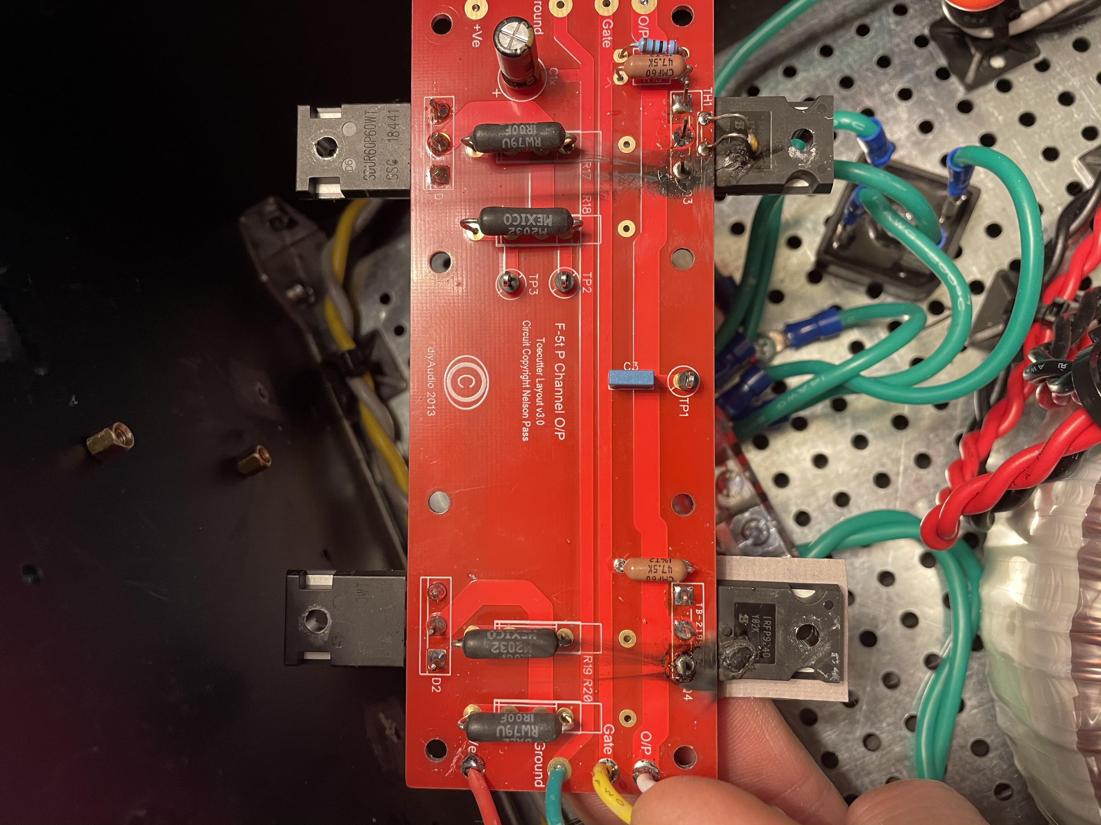

Missed your pics.. sorry.
I think Dirk is referring to the black burn mark on one of your Keratherms. Looks like a short, yea.

A question wrt when what was done: at what point did you solder the new fets? Before or after tightening it to the sink, and dis you wait until the output boards where fastened with bolts? It looks like the burnt trace indicates a crooked fet.
I usually tighten the fet first, then the board, then solder.

Andy, I had the fets mounted to the sink but not tightened down. Just in place for correct placement then soldered to the boards.
Ok. That might explain it, but impossible to say for certain. Good luck! And remember, you solved many issues this last week, and probably learned a lot! That will come to use forever in the future. And you are brave, taking on this moody lady. Kudos!

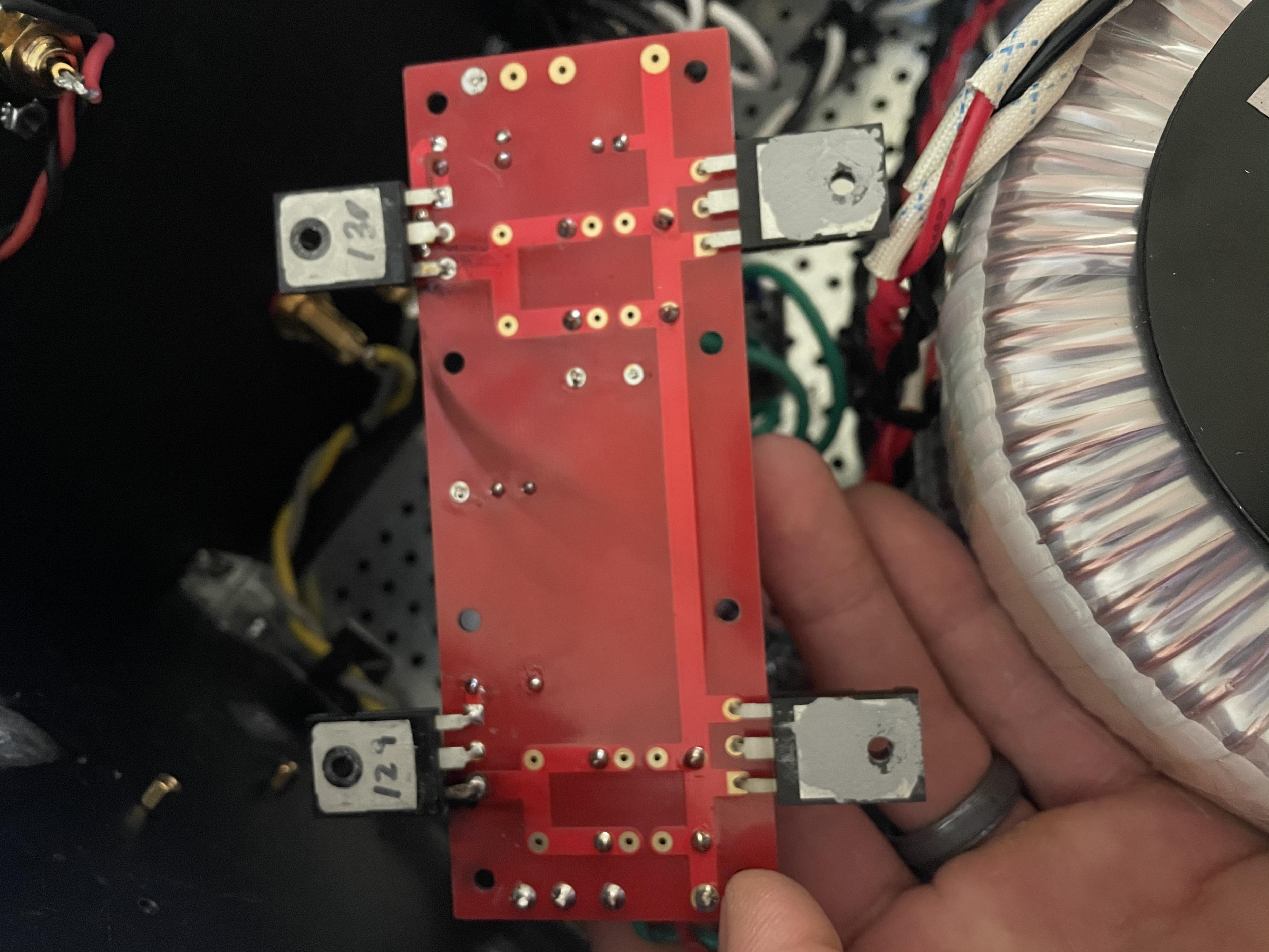

The picture of the reverse side of the board shows the thermal pad stuck to the back of the diodes, heat for a long period of time, relative to the MOSFETS. Considering you melted the metal pin off the MOSFET, localize excessive marks on the thermal pad I would expect. Very hot, very fast.
Remove the other board and see if those diodes have the thermal pad stuck to the back.

Unless anything else obvious rears its head. I'd say that's at least a chunk of the contributing cause. However, I don't know how it would behave at 2+ times the clipping voltage while the bias is stabilizing. Others will need to verify or please let me know if that's way off the mark.
