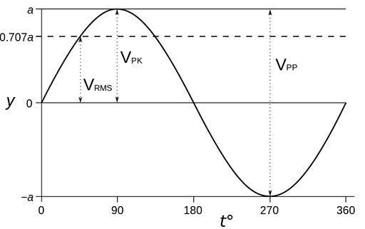

Gain is the ratio of Vout/Vin. So you measure Vout and Vin and do the division.
If you want gain in dB, gain in dB = 20 log (Vout/Vin)
When a voltmeter measures AC voltage, it usually gives it in Vrms. Vrms = 0.707 x Vpeak.
What you see on your oscilloscope is Vpeak.
So to calculate gain, you need to make sure you are consistent in either using Vpeak or Vrms for both Vin and Vout.
To determine maximum power, input a signal and monitor the output voltage on your oscilloscope until you see the sine wave start to flatten or clip. That voltage is the clipping output voltage. The rms output power is calculated using the measured clipping voltage and the amplifier load resistance (the test load resistance).
P (Watts) = (Vrms x Vrms) / R where R = load resistance in Ohms and Vrms = Vclipping x 0.707

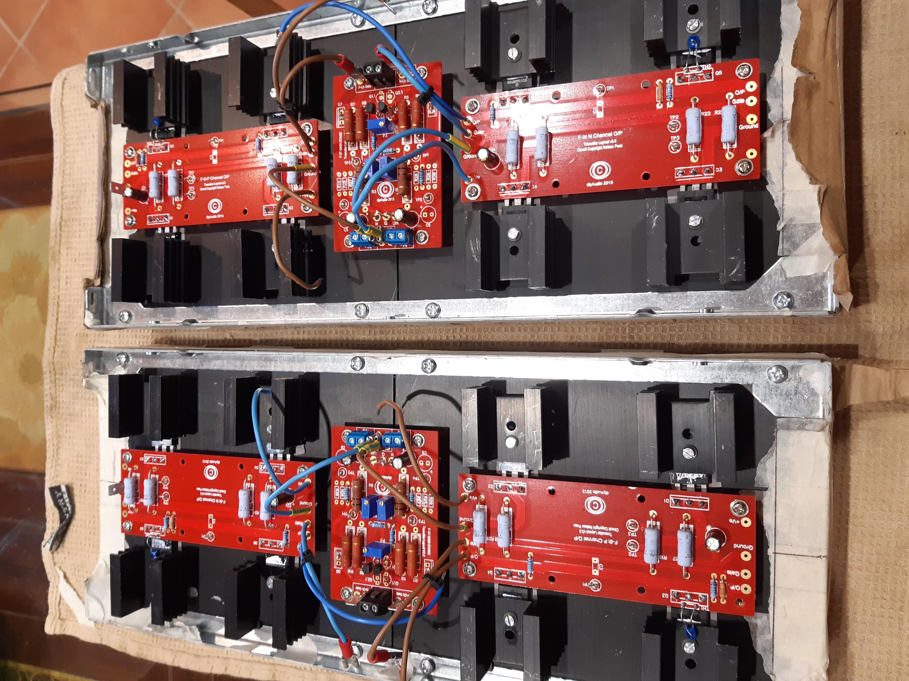

Good morning.
I'm writing from Italy.
I'm bulding F5 turbo2
I'm using 4U HiFi2000 case. To increase dissipation I installed other front heatsink. Is it to much?
Furthermore 350mV is correct bias value?
Thank You
nicola
What Dirk said (easy to agree with someone that is always right and smarter than me).
«Correct» bias on the F5T depends on a number of factors. It is different from build to build. When you have solved the thermistor issue, I recommend you read the last 5-8 pages of this thread. Combination of too high bias and small errors/mistakes, can lead to blown parts. Watch your eyes.
Also, if you reread Nelsons article on this amp, he explains how the diodes can start to conduct (=imminent blow up risk) both from too high bias (400mv drop over source resistors), but also from too high temperature. The temperature vs conductance graphs should tell you what temps not to cross.
Temp is again dependant on dissipation vs heatsink. Dissipation depends on rail voltage and bias current (measured indirectly as voltage drop). So your «correct» bias could be lower or higher than 350mv. Probably lower. Correct in the sense that risk of blow-up is low.
Depending on your rail voltage, I would start far lower than 350mv drop. Maybe 280, and let it cook and see how the temps turn out.
But as mentioned, I recommend you read as much if this thread as possible, and Nelsons article on bias, and follow dirks advice. Much can go wrong.

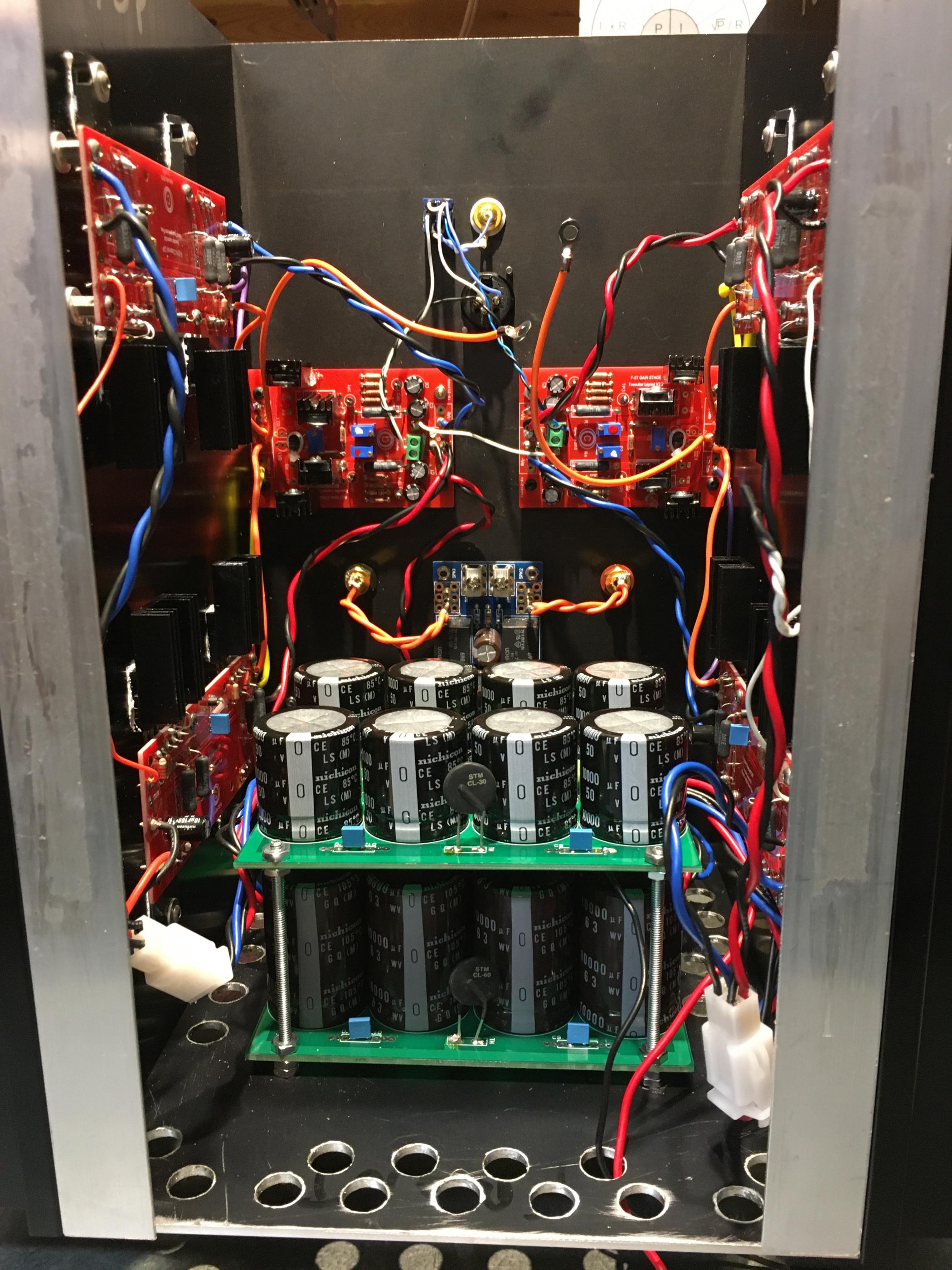

I am in need of advise, I'm currently attempting to adjust bias and DC offset on my Mono block F5t v3. I have separate power supplies for each channel, my first attempt resulted in a very burnt Q3 where the Gate pin dissolved off the MOSFET.
I have 51vdc on the rails under no load, when I was adjusting bias the first time, the rail voltage was a very steady 48.1vdc with 200 mV of bias. My heat sinks are 10" wide X 14" tall with a 10mm base and 2" fins.
Each channel has two FE boards, 2 P channel boards, and 2 N channel boards. I have tested both mono blocks using the dim bulb tester and everything is good even with the output boards connected.
How do I measure DC offset? My first attempt, I had the DVM connected to each (+) & (-) output leads to the speaker terminals. No matter what adjustment I made, no noticeable difference was noted on the DVM for DC offset.
My other channel mono block is ready for adjustments and I am VERY unsure as to how to continue.
Should I measure DC offset for (+) to ground and adjust that FE boards P1 & P2?
Then do I measure (-) to ground and adjust the other FE board P1 & P2?
Here is a photo: Orange wires are OP, Red V+, Blue V-, Black is ground, Yellow is P channel gate and Purple is N channel gate.
