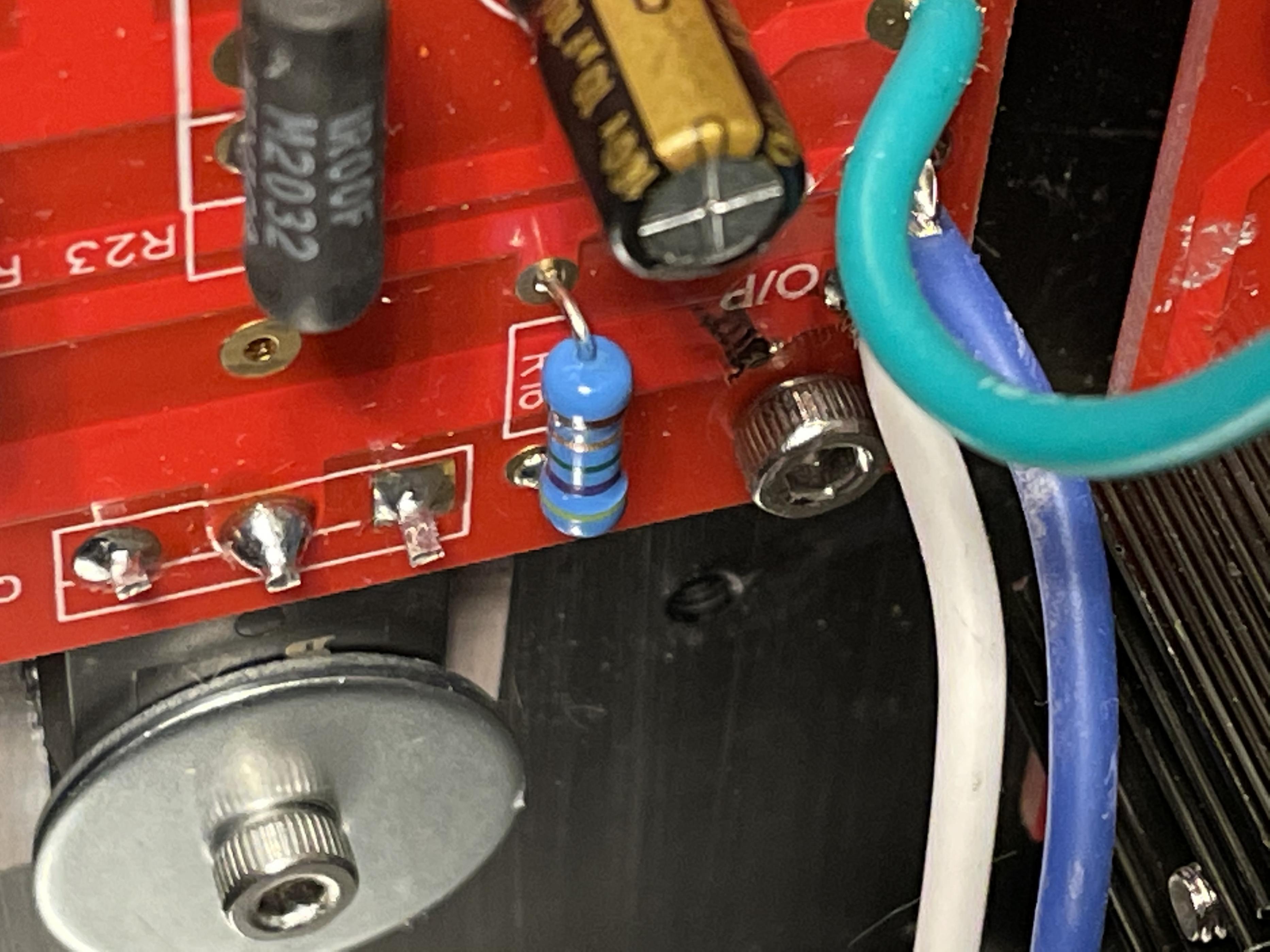

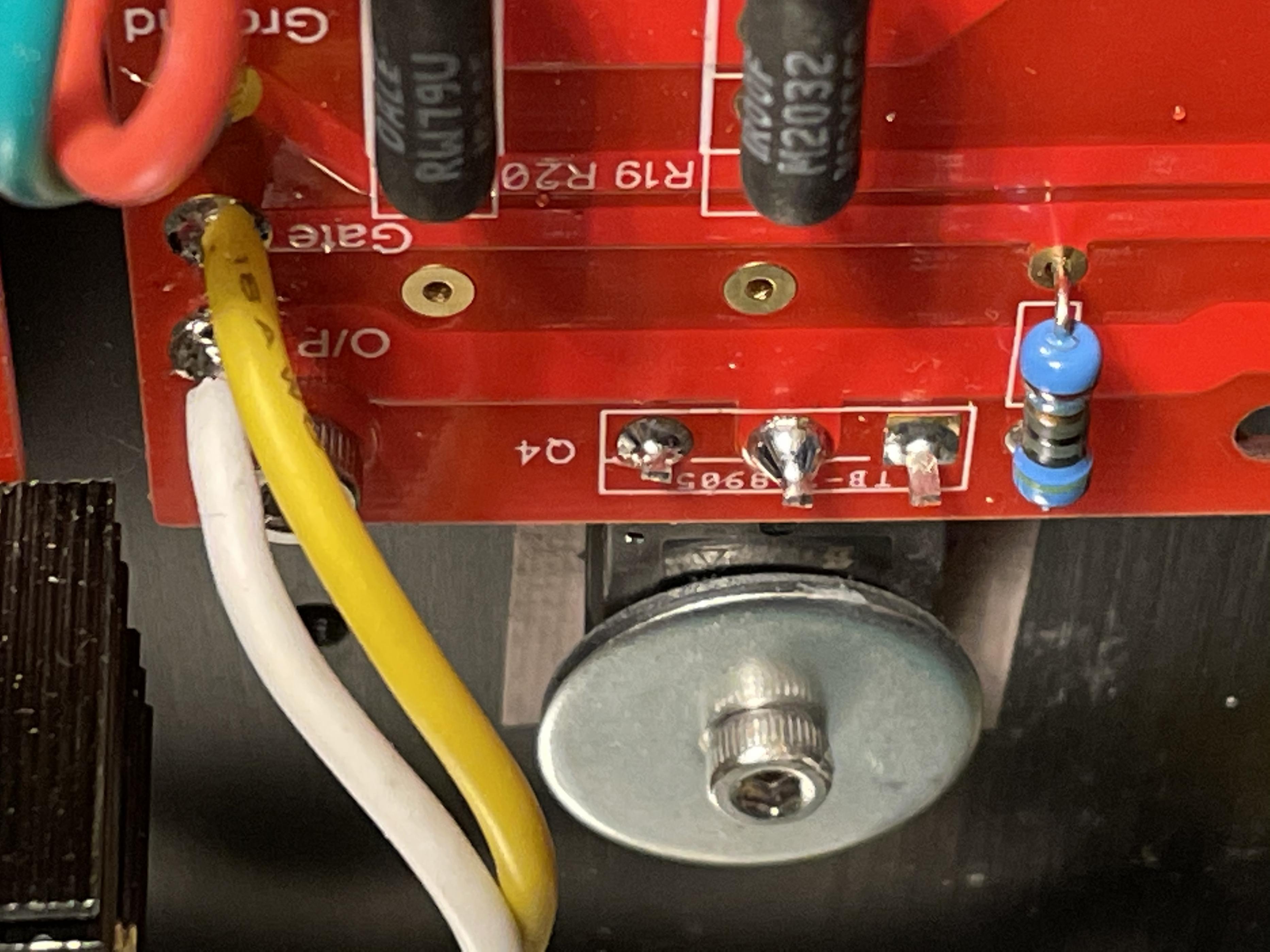

“For the output boards, it is important to simulate a zero bias condition, achieved by shorting out the relevant pads. It appears to me that those pads are the gate (yellow and blue wire, far as I can tell, but don't hold me to it) and the power supply for the relevant board (red and black, in your case).
What is meant by “shorting out the relevant pads”? Do I not give this board power to test it? Do I short the gate to the power supply? I’m not following.
How is this done and what should this voltage be or how would I arrive at knowing what this voltage should be?
You would test the voltage between the JFET drain pad and ground (the JFETs are not populated at this time). The voltage should be close to the ratio of the cascode resistors.
Are you confirming the bias pots work here?
Yup. And that they're properly connected/oriented, and that you are able to get the correct biasing voltage on the output MOSFETs (about 5.5V is the maximum needed). This also helps to check the actual JFET current, which is handy to figure out whether they're in a safe operating zone.
1. Run a wire from the gate pad to the power supply pad for that board (for the P-ch board that would be positive supply for this amp).
2. Connect a 12V power supply between the PSU input (still with the P-ch board, this would be the +ve supply) and the output pad. Use a 10 ohm resistor in series with the power supply, not more than 1/2W. If everything is okay the resistor will survive, if not, you'll need to get back and check the board. When there is no bias (shorted G-S junction) the output board should draw zero current. If there's a problem, you only lose one small resistor.

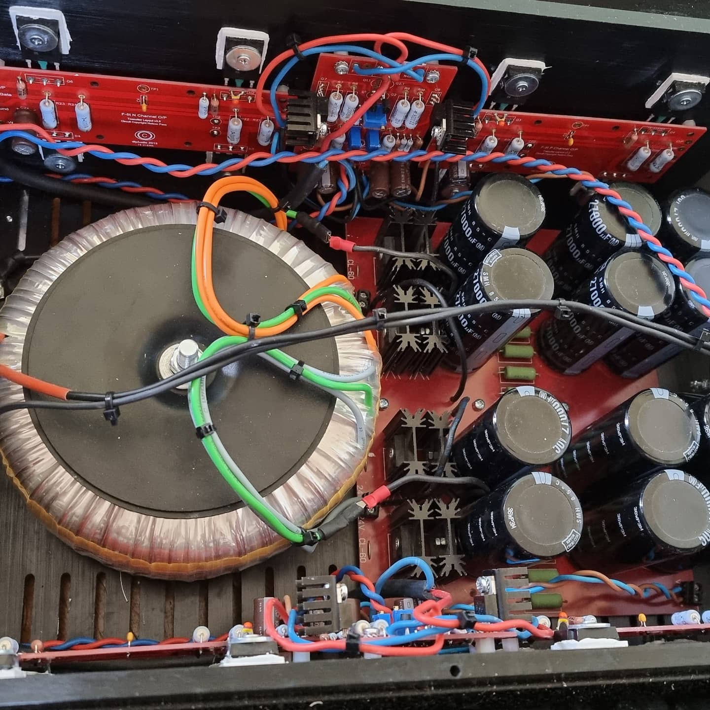

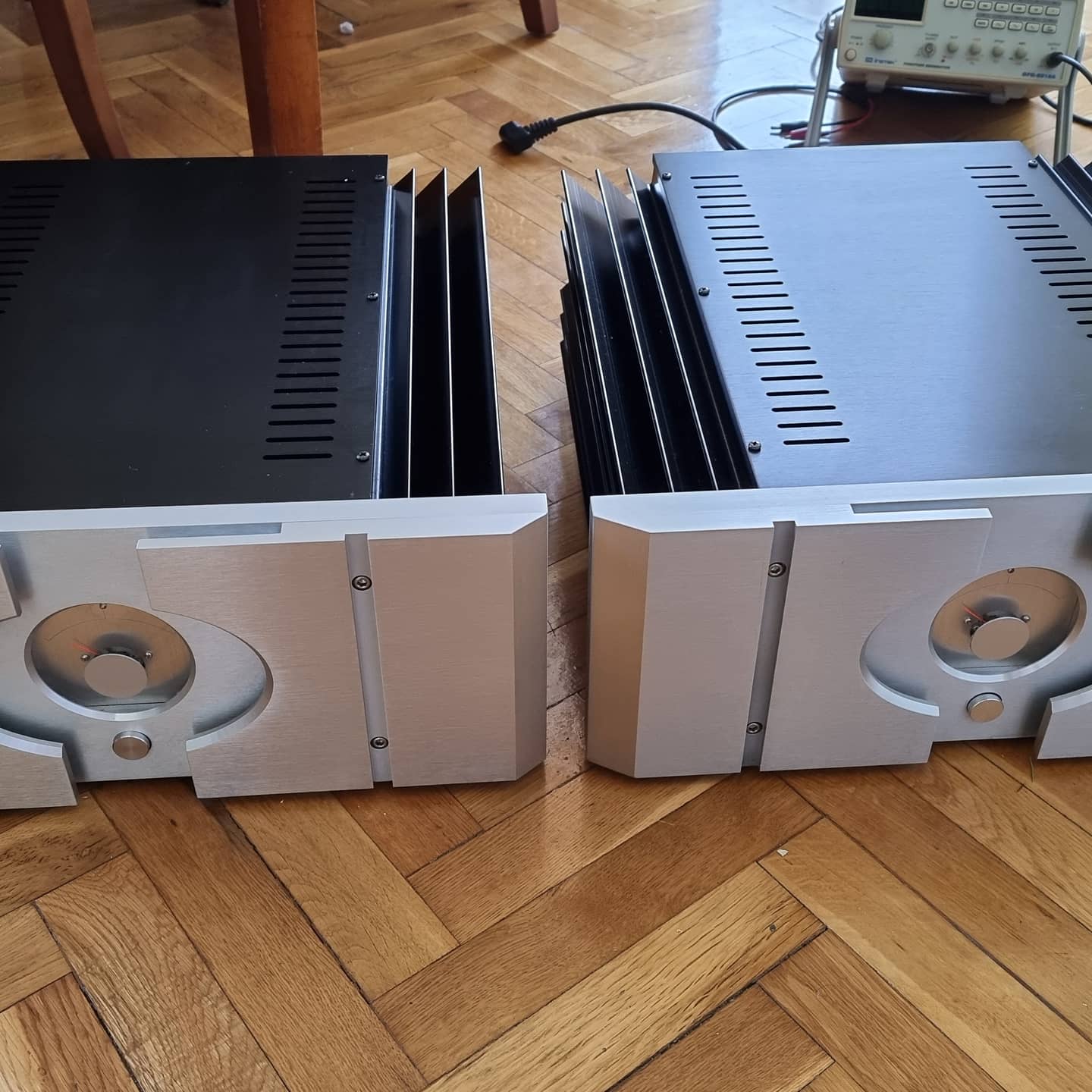

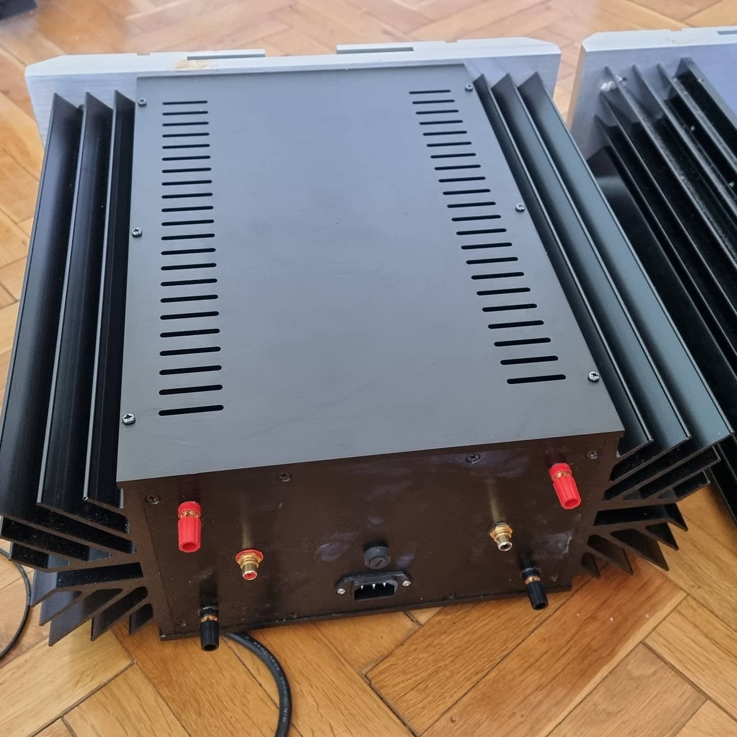

Here are the two amps. Very pleased with the sound, big thanks to both Nelson Pass and also to diyaudio 🙂
The PSU boards are own design as the ones from the store got stuck with US mail (arrived in Jan 2021, however). I didn`t add the optional stability caps recommended by 6L6 but at least at 1Khz the square wave response was almost perfect with very very tiny overshoot (was so low I decided not to add the caps).
Yesterday at 25C ambient the amp got to 53C so I saved some money from my gas bill 🙂)
