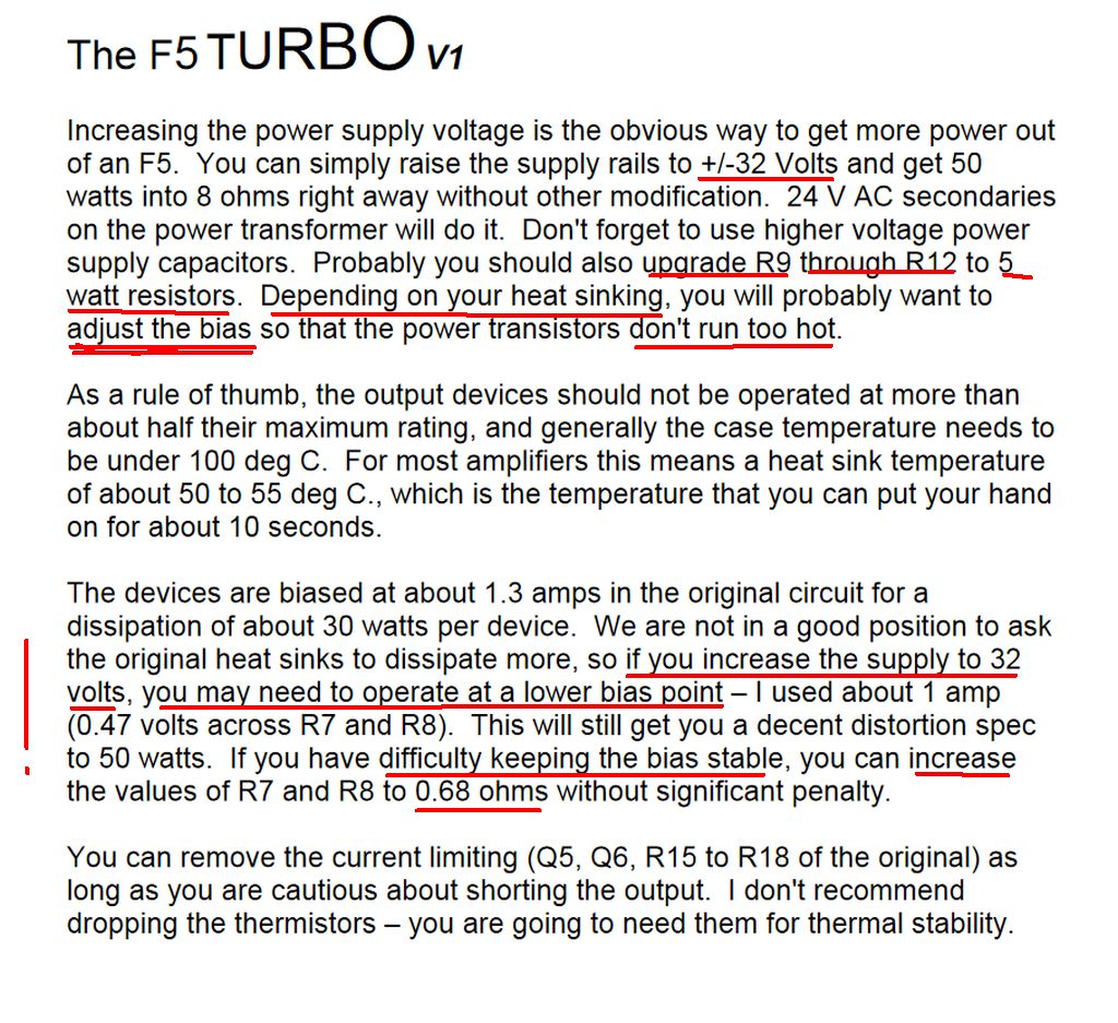

to all F5T-builders
Hello F5T builders,
if you increase your rail-voltages (especially if you go very high):
- you shouldn't go over the maximum dissipation those Mosfets can handle!
normally you have to decrease your bias
(example: my F5T runs on +-42,4 V rails, Case/heatsinks are 500mm deep / 210mm high for 2 n-channel boards = 4 Mosfets+4 Diodes; the same heatsinks
for 2 p-channel boards - Monoblocks!
I can't bias higher than 330mV per Mosfet and I have around 52° C at my
heatsinks).
So if you run railvoltages of +-51V you will reach the maximum heat those Mosfets can handle at a lower bias-point.😉
I made a screenshot of a part of Nelson Pass article about the F5T.
See pic.
I am assuming, that some of you want to 'barbecue' their Mosfets?
Greets
Dirk 😀
Hello F5T builders,
heatsinks).
See pic.
Greets
Dirk 😀
