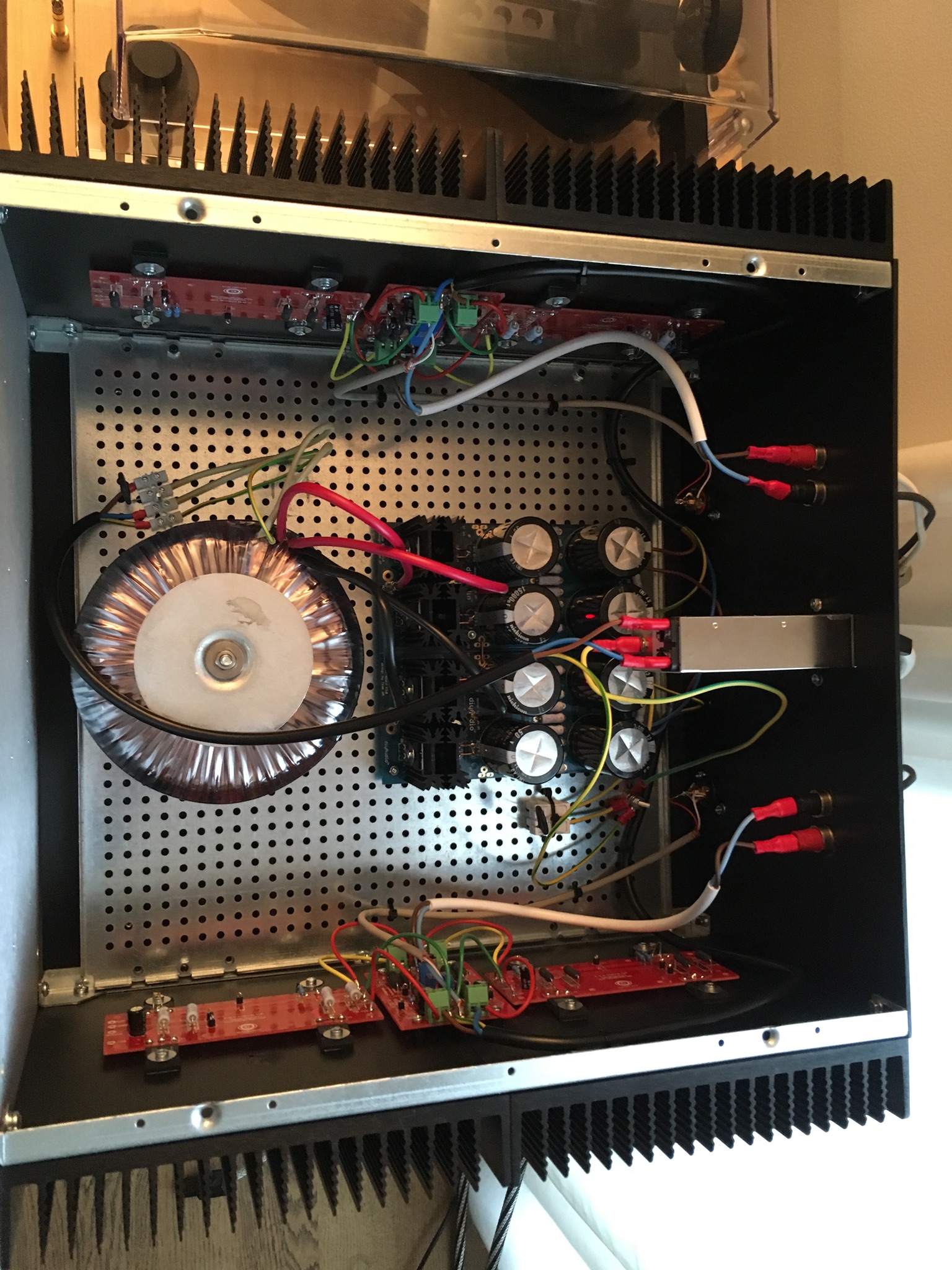

I've built a F5 turbo V2 and absolutely love it! I thought my VTA - ST70 tube amp was really great, but the F5 turbo is noticeably better. Even the wife heard the difference!
A special thanks to 6L6 and his great build guide and email support!
I used a 800va toroid, the V3 boards, the 5u Deluxe chassis. It fired up without any issues. Initial bias setting is about 375mv with 47 degrees centigrade temperature at the heatsink.

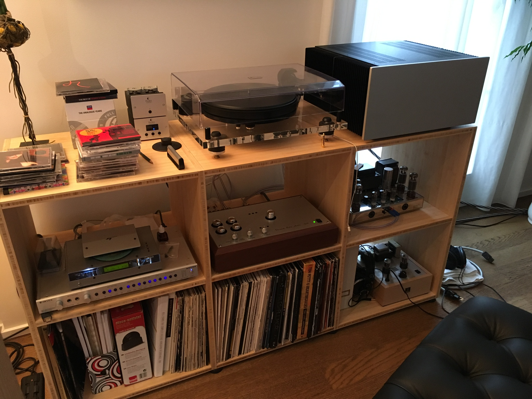

Some pictures attached (it is the big box on the top right of the rig :D ).
More on my blog: https://zimmer64.wordpress.com/2016/10/23/pass-f5-turbo-v2/
Cheers
Michael

I had set up a workbench in her atelier for this project. I installed my open baffle speakers there. The sound of those is addictive and one is surrounded by all the artwork.

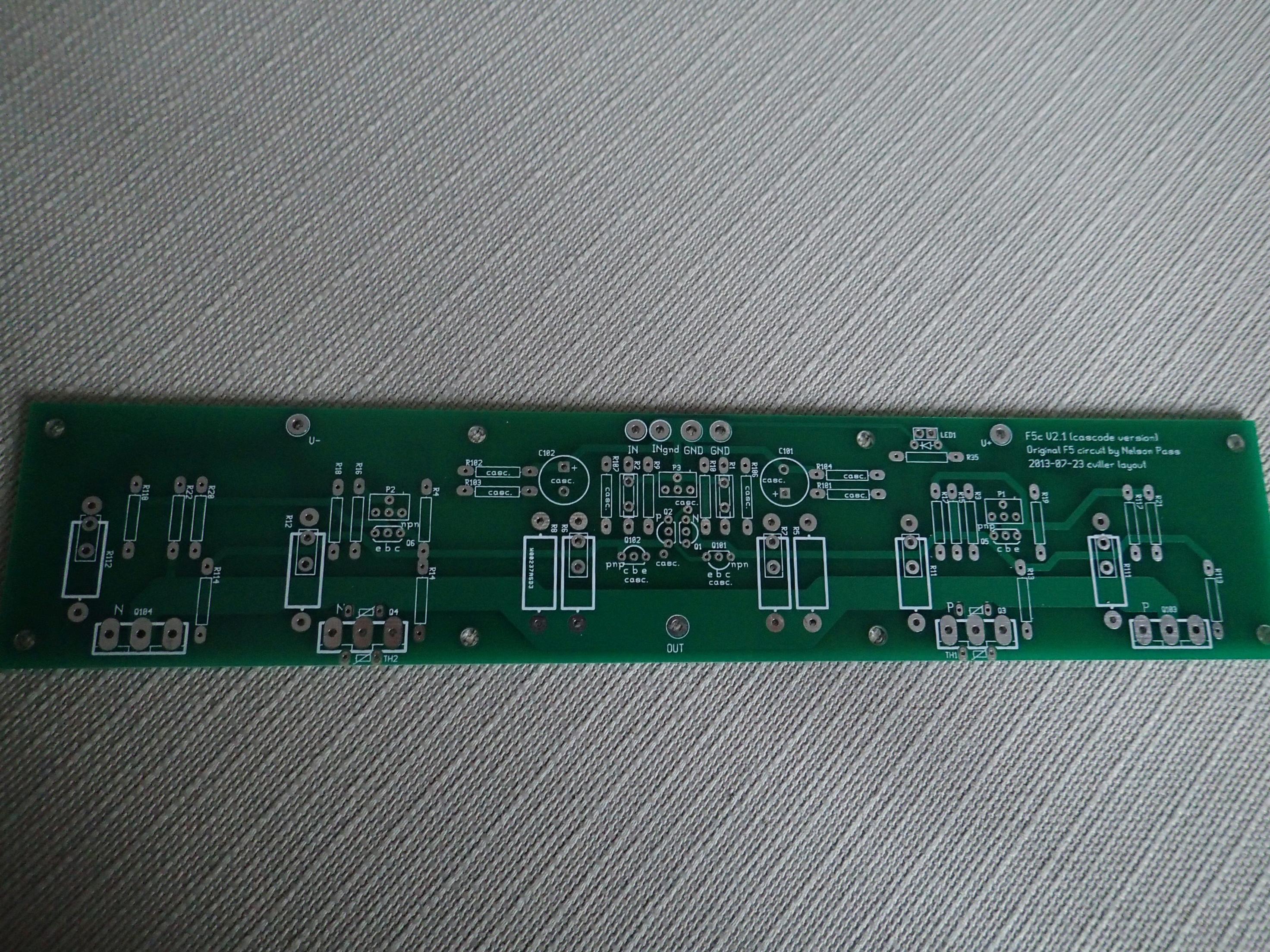

I have built more than twenty F5V2 steroset, but never run into a problem like this. PCB is cvillers(see photo).
Setting bias give this results on sourceresistors: Q4(NPN) 254 mV but on Q 104(second NPN) 11.4 mV. Q3(PNP) 240mV but on Q 103(second PNP) 28.5 mV. Offset is no promlem to adjust(1-2 mV).
I have other NPN and PNP taken from the same bat. so to find two of each to match will be easy(but not matching NPN and PNP). As long as I can adjust offset close to zero, I find this kind of matching fair.
Any good advices??
