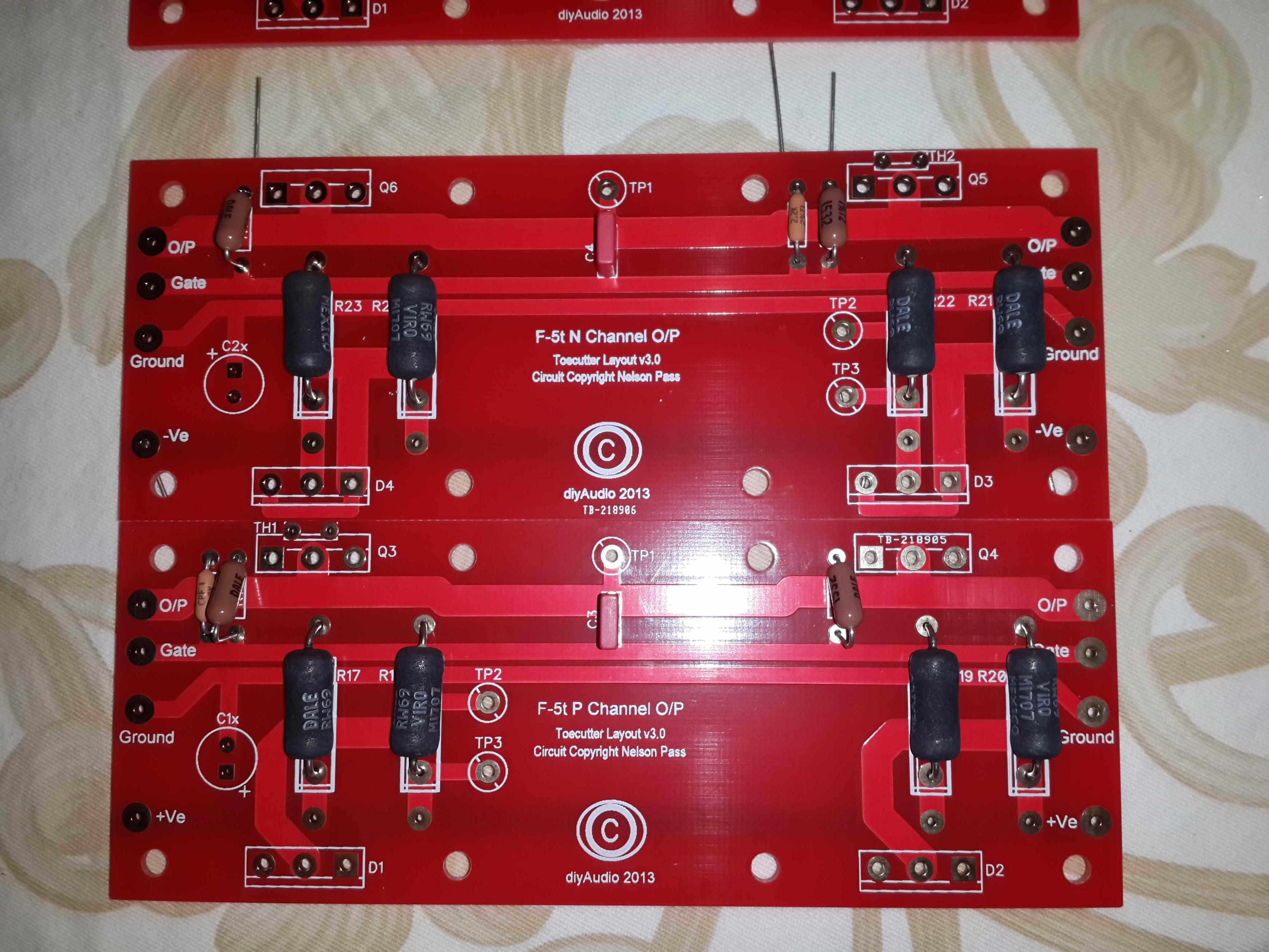

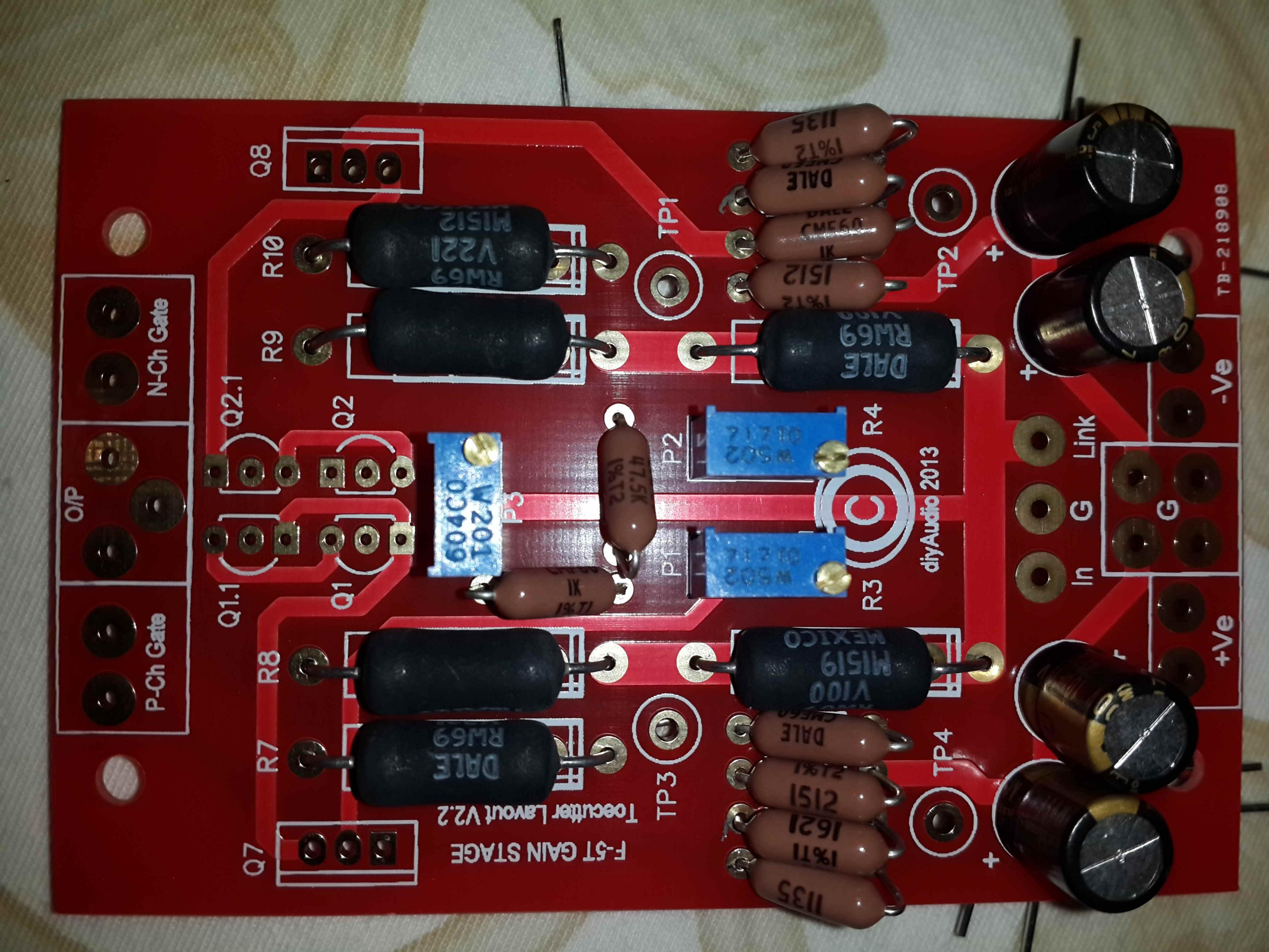

hi guys,
I stuffed FE boards in my spare time following 6L6's perfect build guide.
I could not set P3 trimmers to exact value (which is 100 ohm), one of them set as 101.2 ohm and the other is 108.2 ohm (from leg 1 to 2 and 2 to 3)
is it okey?
and another question is that
I also stuffed but not soldered n channel and p channel boards, I have some missing items which are C1x and C2x, I need 4 10uF electrolytic cap, but I have 2.
They are strictly necessary or should I leave them empty?
because according to 6L6's built guide, they seem empty on some photos.
Please see the attached pics.

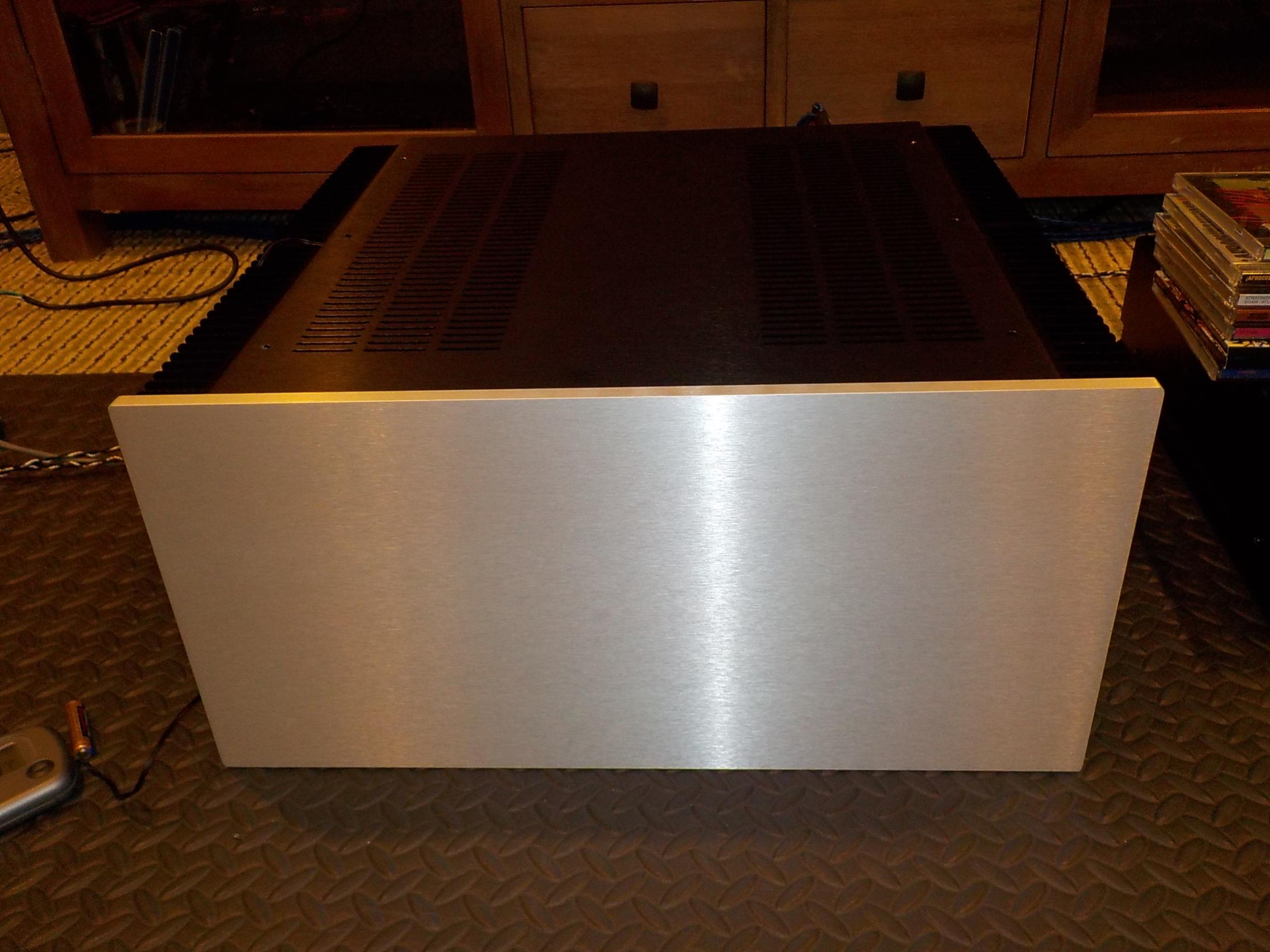

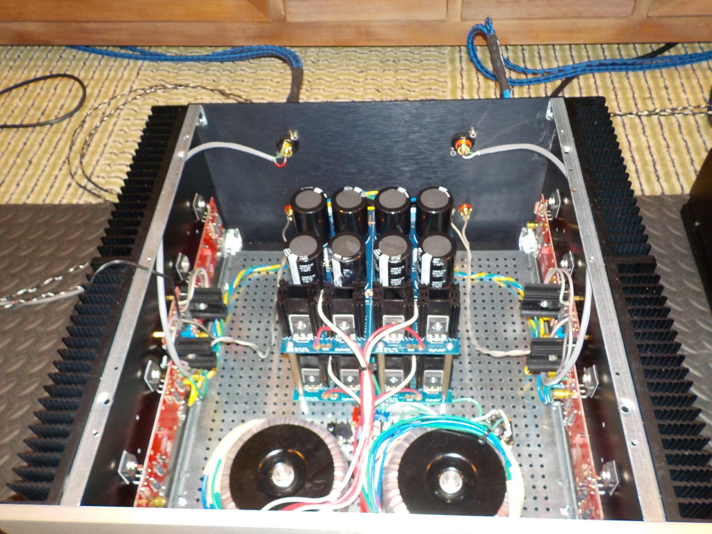

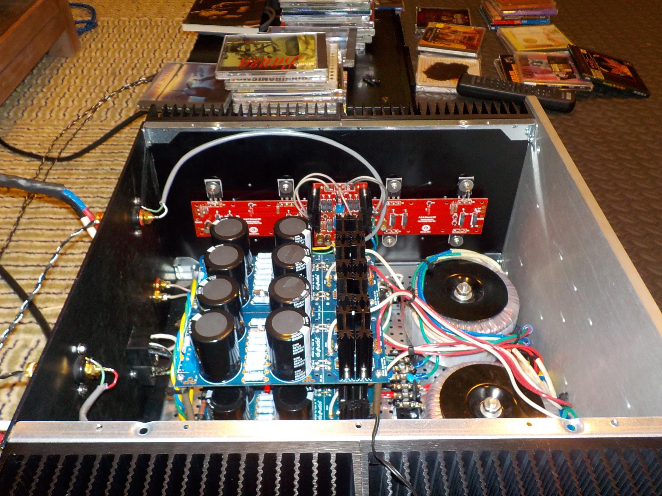

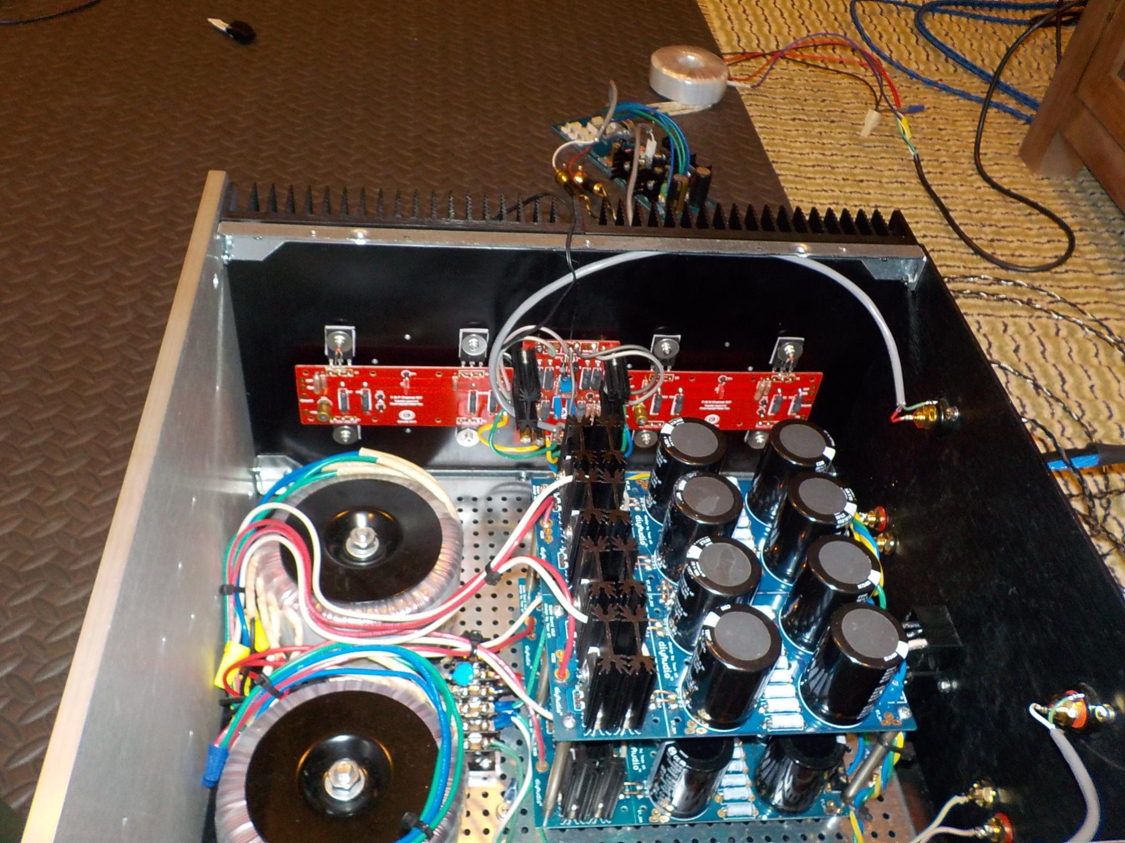

F5T V2 running, have a fewe of q's to finish settings.
Hello all. Thank you for all the resources I am happy to report that I have completed building the amplifier, I'm new to the forum and this is my first day project. I wasn't hesitant to do it until a fellow member decided to sell an incomplete kit.
Build when fairly well. Lots of time spent, learned a lot. Thank you for all the insight and advice find in the board.
Here are the q's.
.I'm using the 5u deluxe chassis, dual transformers at 300VA each, dual power supplies each channel gets its own+/-, rails are at +/- 40 volts using the PS3 boards and 60,000 uF of filtering per power supply side for a total of 240,000 uF. Bias set at 350 mV and 360 mV across source resistor. Output dissipation estimated just below 30 Watts per device. Differential temperature between room and heatsinks is 25 degrees Celsius. Room at 17 degrees, heatsink at 42 degrees.
1. How close am I to the limit of the chassis dissipation capability?
2. How to figure case temperature of the output devices? In have infrared thermometer?
3. How do I figure the maximal output, I have 8r dummy resistor 500w available and a function generator?
4. How important to balance gain between channels?
5. Practical way to adjust p3 if audio analyzer is not available?

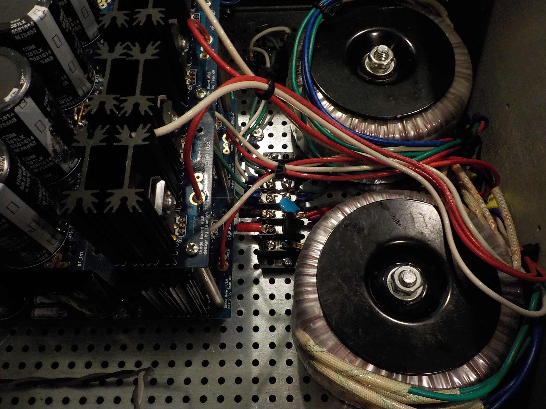

6. Unrelated. I'm feeding the amp with a mesmerized B1 buffer without chassis ground is floating. I get a ground loop when connected, amp is dead quiet so it's the buffer. What is the proper way to ground the B1 beard?
Thank you again for everything.

If your summer temperature went up to 30degrees C (no air con), then your sink would be @ 55degrees C. This is OK.Hello all. Thank you for all the resources I am happy to report that I have completed building the amplifier, I'm new to the forum and this is my first day project. I wasn't hesitant to do it until a fellow member decided to sell an incomplete kit.
Here are the q's.
You are getting close to chassis/sink limit if your max Ta is around 30degreesC.1. How close am I to the limit of the chassis dissipation capability?
If you predict rather than measure the impossible, you will get closer. For an Rth c-s of 1C/W and 30W passing across the insulator, then Tc=Ts+1C/W*30C2. How to figure case temperature of the output devices? In have infrared thermometer?
If you use a much more thermally conductive insulator say 0.3C/W, then Tc = Ts + 0.3C/W*30C
This better insulator allows the devices to operate 21C degrees cooler.
Don't figure it out. Measure it.3. How do I figure the maximal output, I have 8r dummy resistor 500w available and a function generator?
You need a scope to monitor the highest available output voltage without any sign of clipping of that signal when the load is connected. You need a fairly clean signal source <0.5% sine distortion is probably good enough.
You need an AC voltmeter that reads to better than +-1%.
You need some form of switching arrangement to prevent overheating while you take the measurements and monitor the non clipping, while driving enormous current into your dummy load.
Pmax = Vac^2 / Rload
Not important. +-5% resistors (gold stripe) give a worst case error of +10% and -10% between the channels and that accounts for only 1.7dB between the channels. You can check your resistors with your ohms function on your DMM and get channel matching to much better than +-1%, giving <<0.5dB between channels.4. How important to balance gain between channels?
Don't adjust p3. Set it exactly to electrical middle. And leave it there. Don't try to fiddle by ear. Ears+brain are terrible at measuring.5. Practical way to adjust p3 if audio analyzer is not available?
It's probably not the Buffer.6. Unrelated. I'm feeding the amp with a mesmerized B1 buffer without chassis ground is floating. I get a ground loop when connected, amp is dead quiet so it's the buffer. What is the proper way to ground the B1 beard?

F5T V2 ground loop
Read D.Joffe and install HBRR+HBRL[/QUOTE]
Andrew, I found it: Ground Loop again
Post # 22.
Thanks.
Post # 22.
Thanks.
