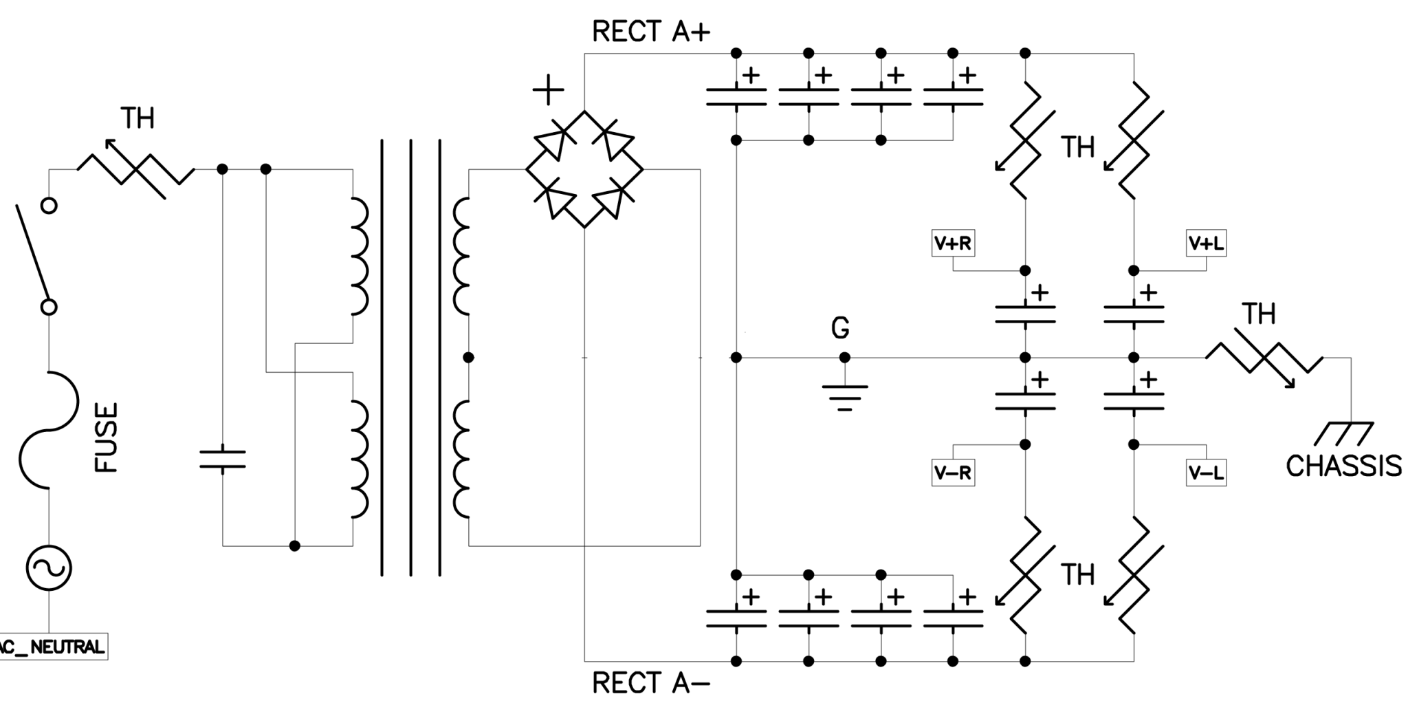

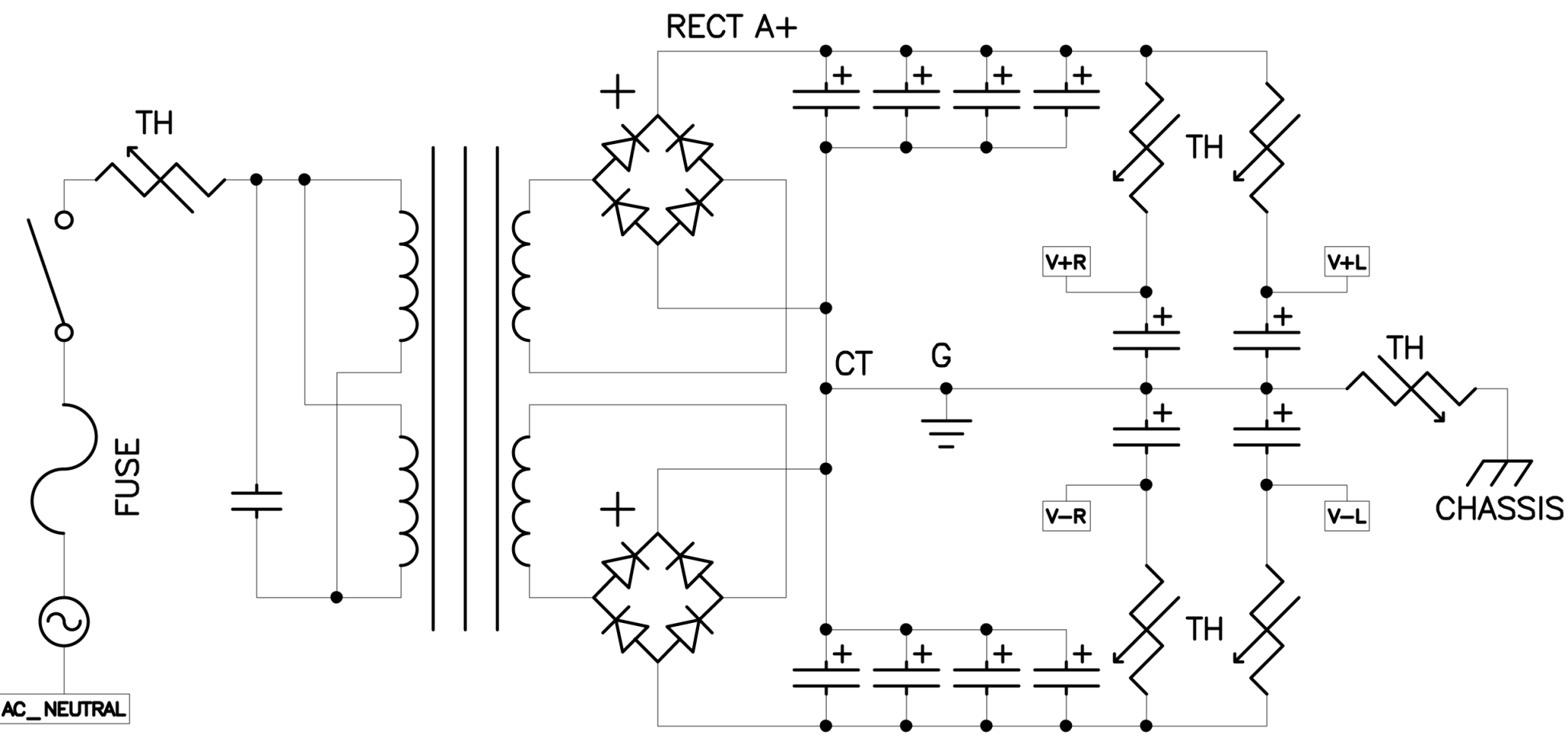

In the diagram below, I have removed the connection between the center tap of the secondary and the midpoint ground of the filter bank (I don't know what else to call it). The midpoint ground is now floating, and would serve as circuit ground, but it is still connected to chassis and earth ground via a thermistor. Would there be a potential difference between this floating midpoint ground and earth ground? Is this even kosher?
(I am trying to use a transformer secondary that lacks a center tap.)
To clarify, I feel like doing so is analogous to the "floating ground" in the configuration below:
no go
you need to have properly established GND potential and this is not
you can search for Quad 606 way of doing it, but be aware of fact that being possible only for amps which load both rails in very symmetric way
F5 can qualify as that but - if you stop just for a moment and think of actual commercial worth of amp you're going to make, money spent on proper Donut is not so big deal

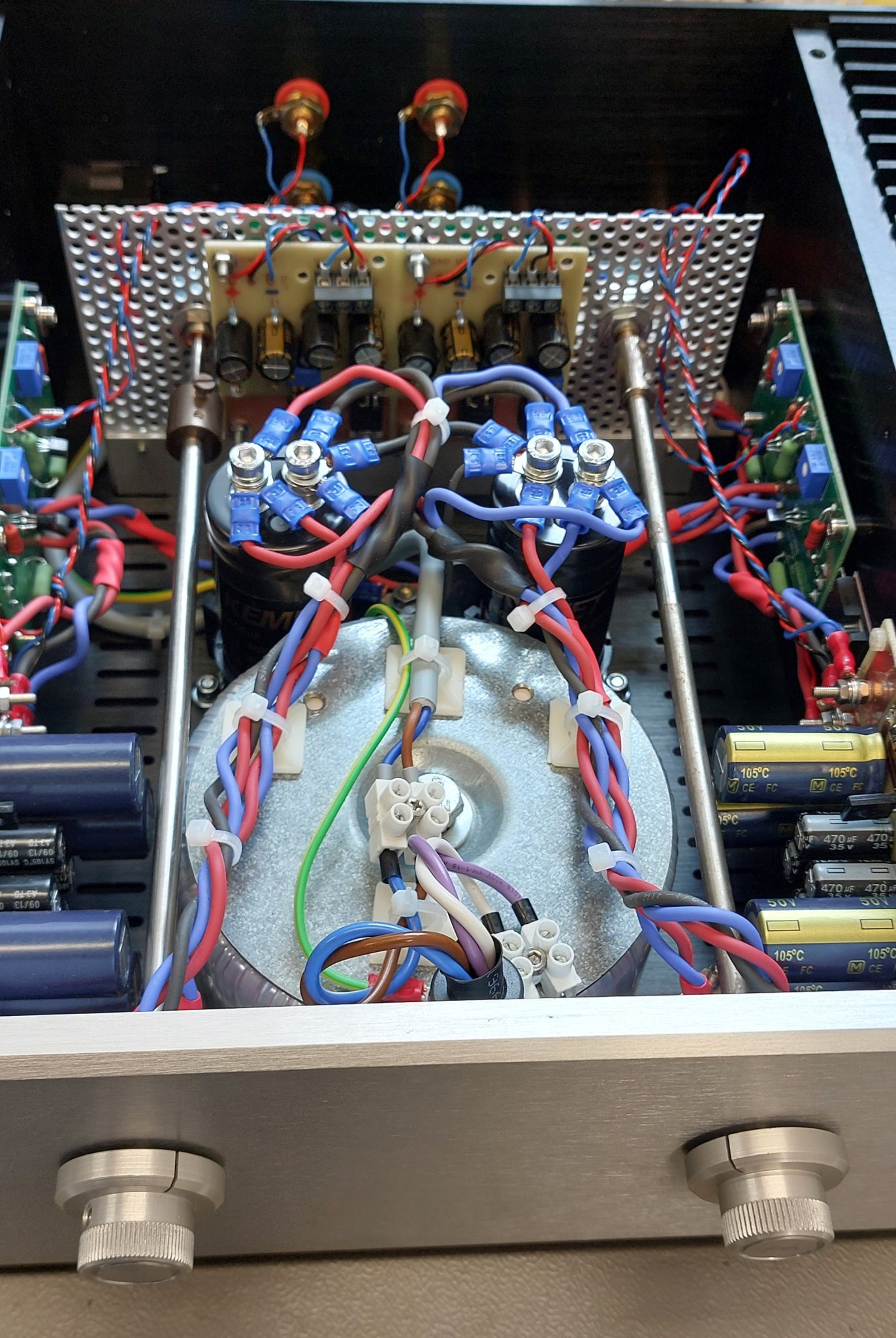

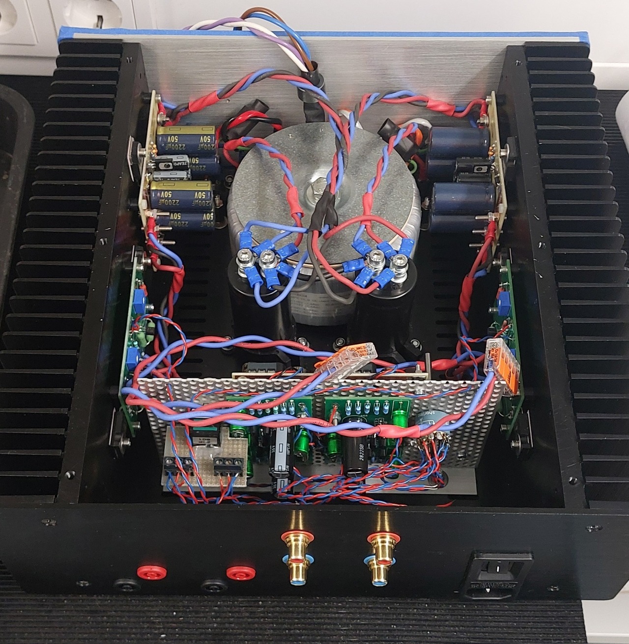

I made an integrated out of it:
rotary switch -> DIY Frontend (gain set to 2x) -> TKD volume pot -> F5m
I’m using my own PSU:
2x 36mF -> capacitance multiplier -> F5m
-> LM317/337 -> Frontend
I did this, because I had a 2x24V/AC trafo left, that I wanted to use, so I had a couple of volts to waste.
The idle current is set to 1,29A but I’m still going to reduce it a bit. The housing is rather compact and it is getting a bit too hot for my taste.
Anyway, it sounds just sweet…
Cheers, Boris
PS: I'm still going to change the knobs, I used them because I had them. But I want bigger ones...

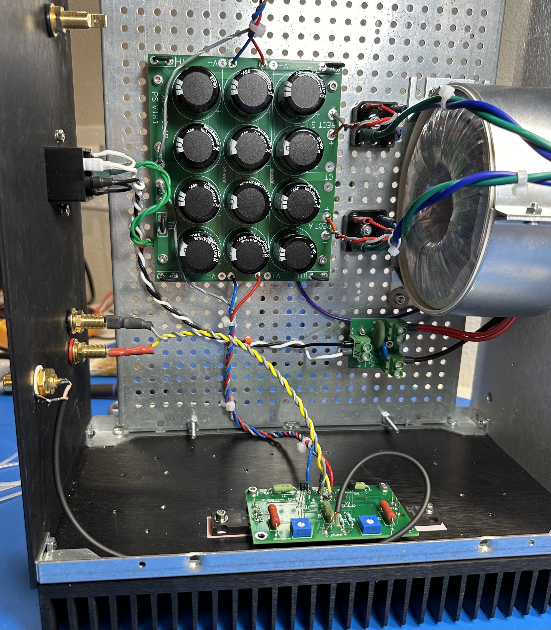

Well, did first power up of primaries, showing just under 18v on 124v input with Antek 4218, no smoke. Next step is final wiring of PSU and boards and biasing up. A little confused on where to attach chassis ground to PS board, assuming where indicated on pic
Reactions: ekobi and birdbox
Can't see all the traces, and I've got the earlier boards, but one of the traces from the mounting holes might run to one of the thermistors. If you connect properly / securely with the mounting hardware in the kit or a metal standoff - that's your chassis GND.
Edited to add - Sheesh - yes, I just saw you had a picture attached and enlarged it. That's the one.
