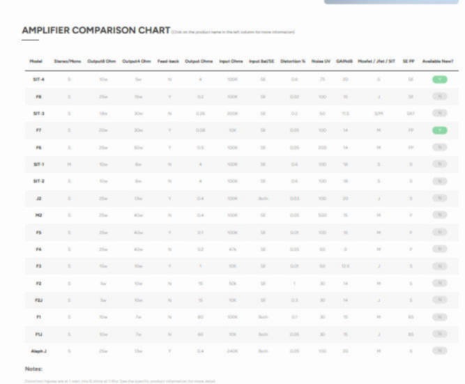

F5m kit
Have a look at the First Watt product table over on firstwatt.com .
_
