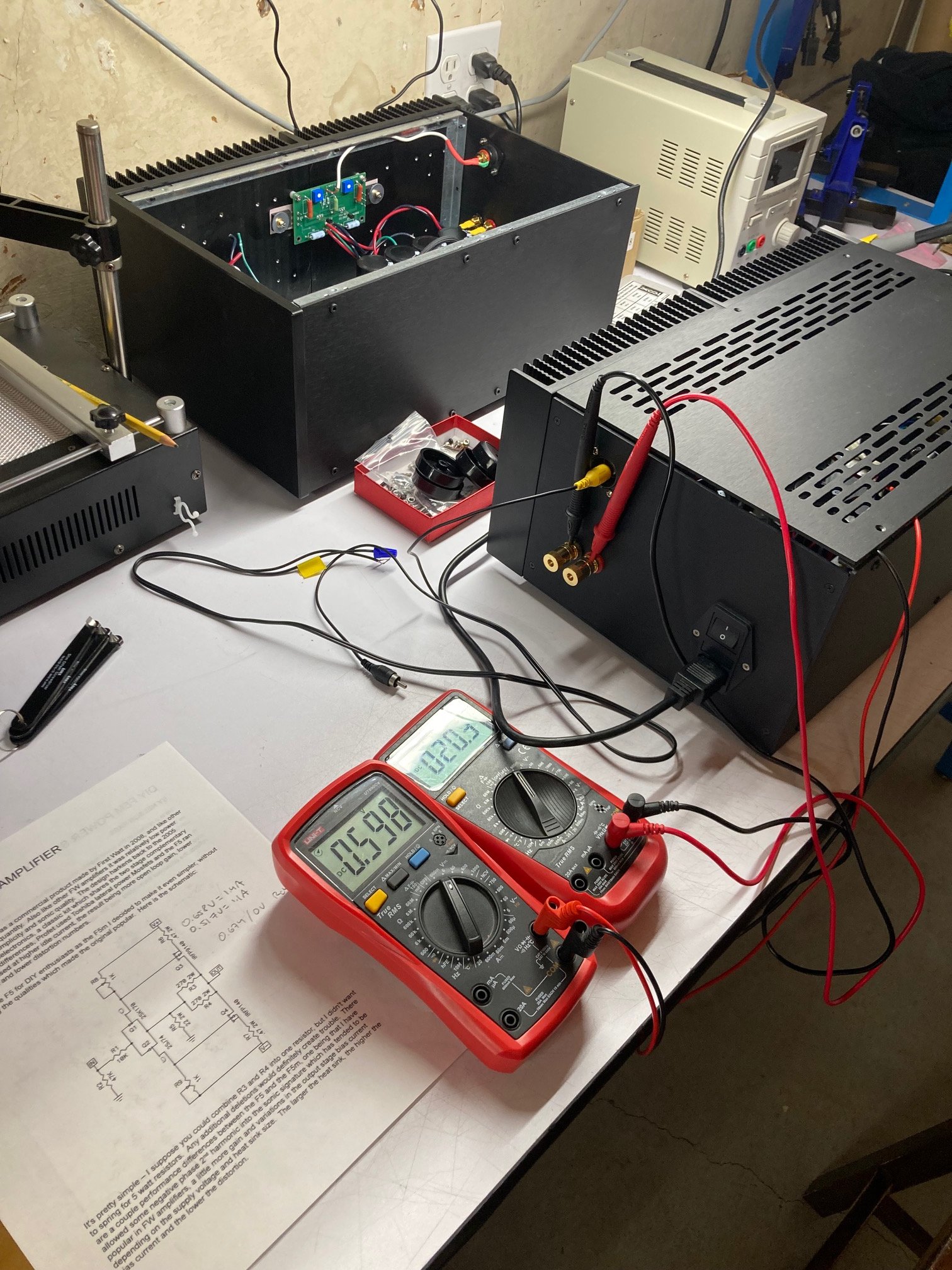

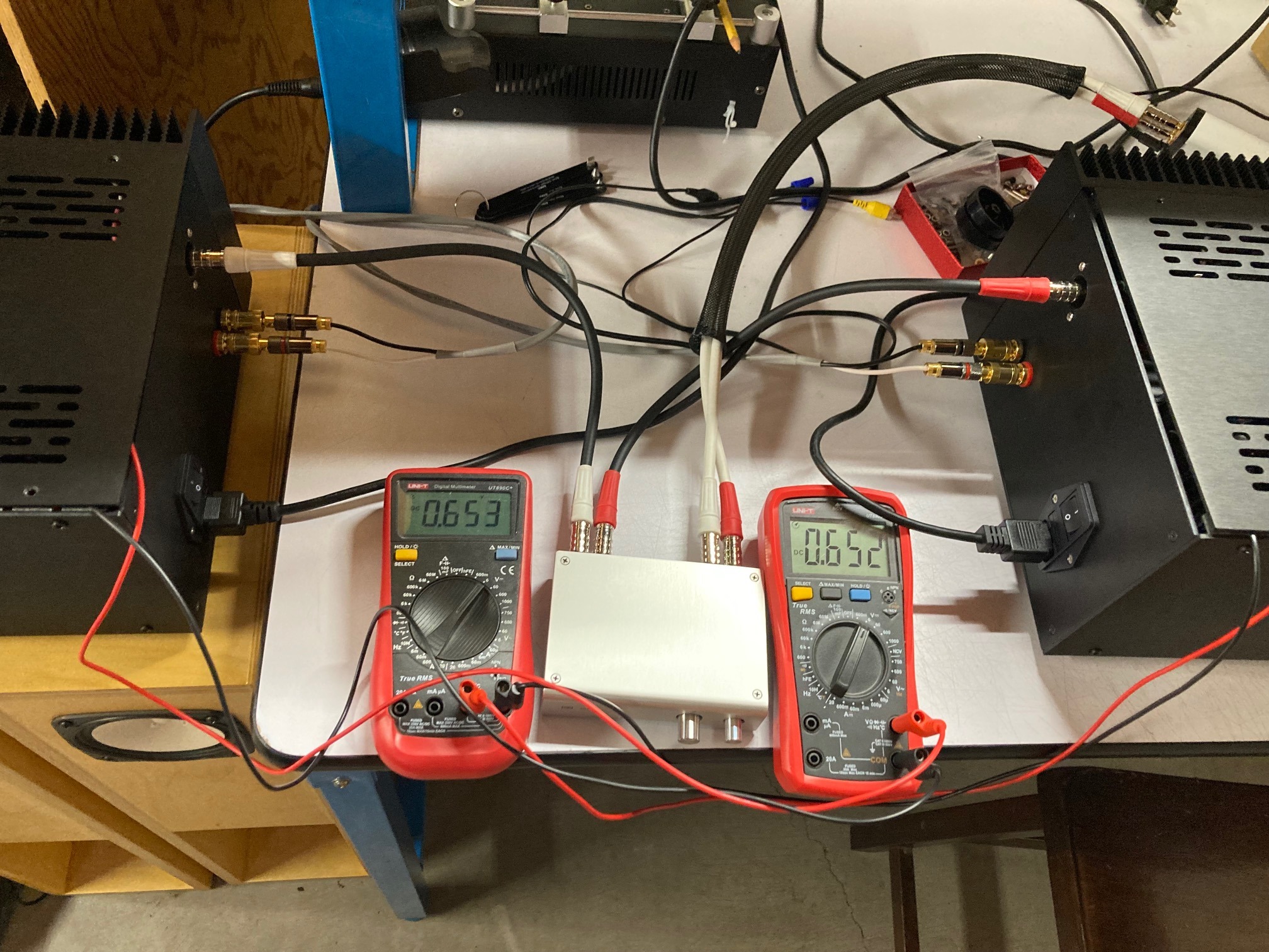

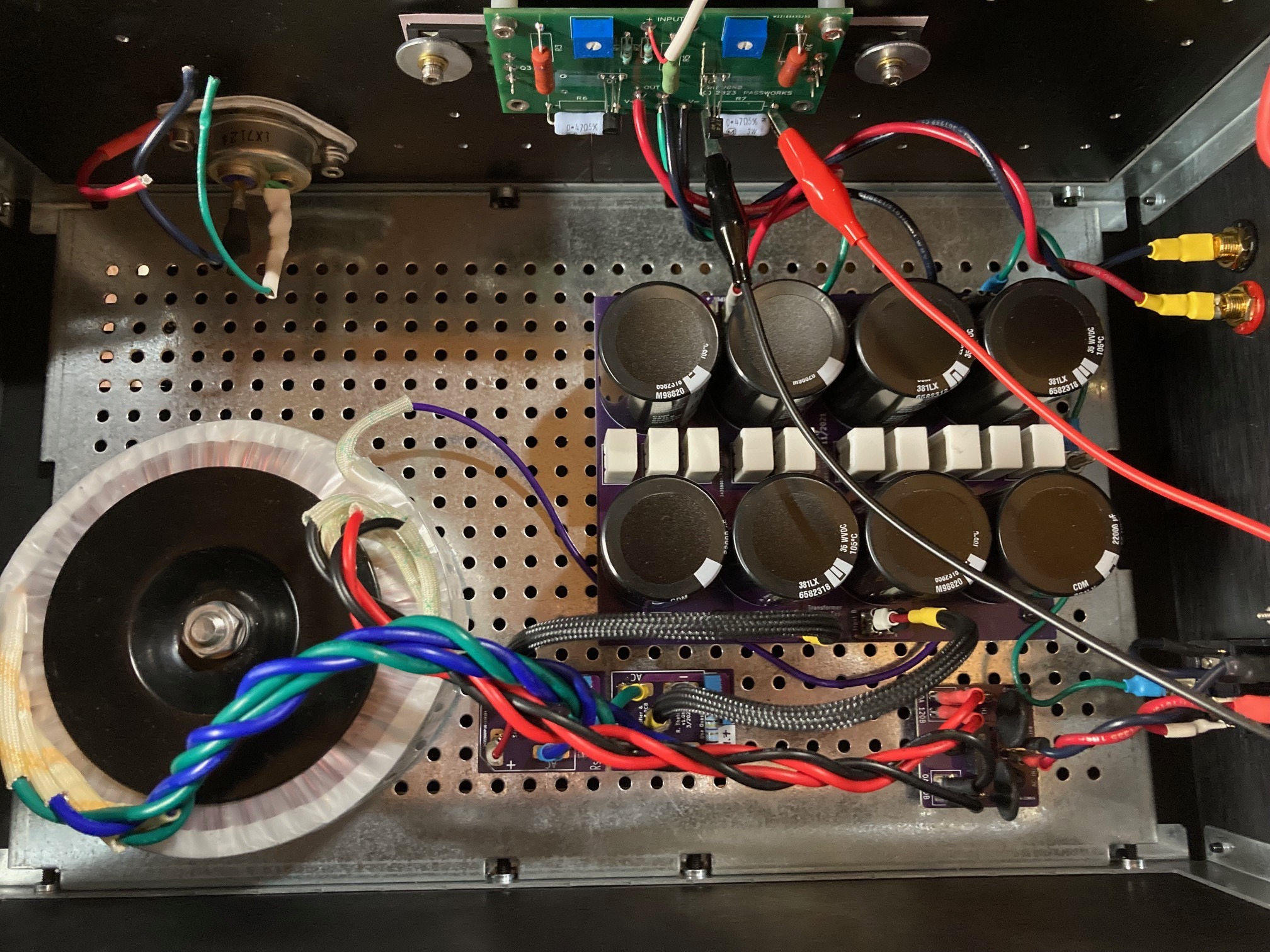

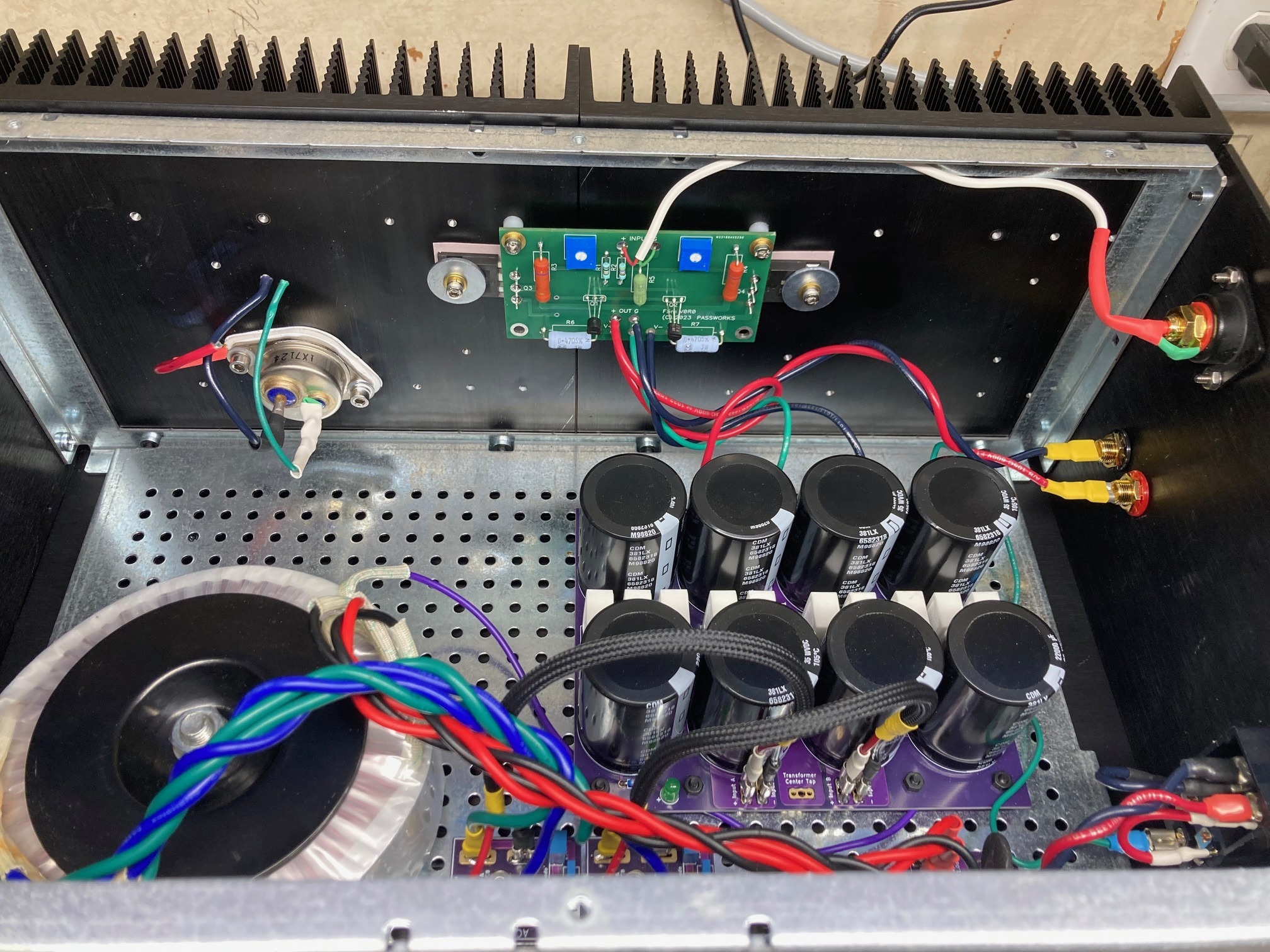

Dial "M" for monoblocks
This was mostly done out of expediency. Two monoblock chassis each with an Antek AS-2218 and Randy Thatcher's "V8 CRCRC" dual rail PSUs with all the trimmins were within specs and ready for a quick amp swap. Would the F5m boards hold bias? would they thump or run away without their thermistors? I didn't know.
Turns out they bias up just fine and gentle and seem to hold that bias at a smidge under 1.4A for quite a while. The heat sinks are warm but not evenly so, there is sinking to spare. No turn-on or turn off thumps, neither.
I don't recall hearing quite so much bass or detail or bass detail out of the garage speakers before. These will be fun to hear in the main system for sure.
