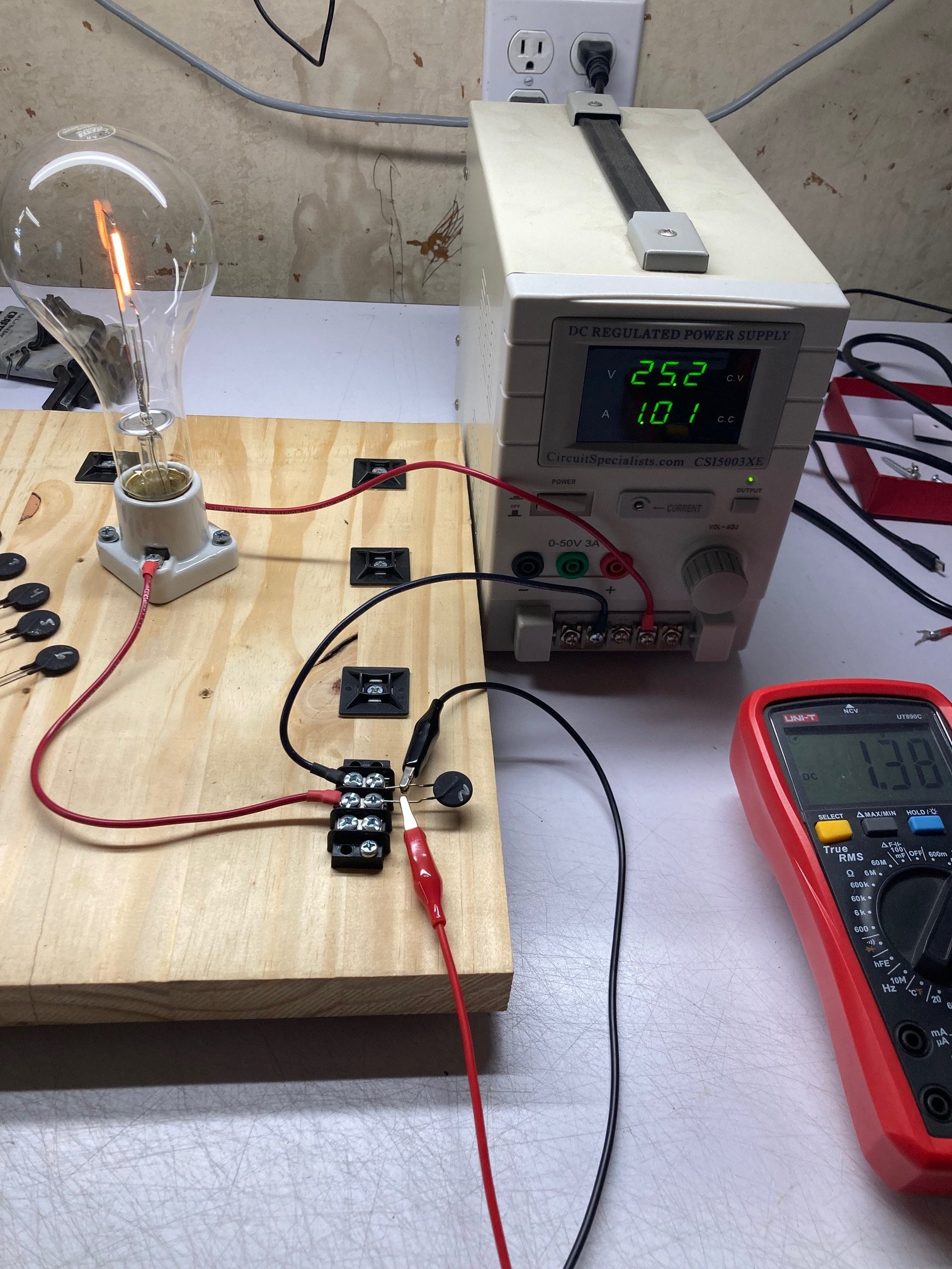

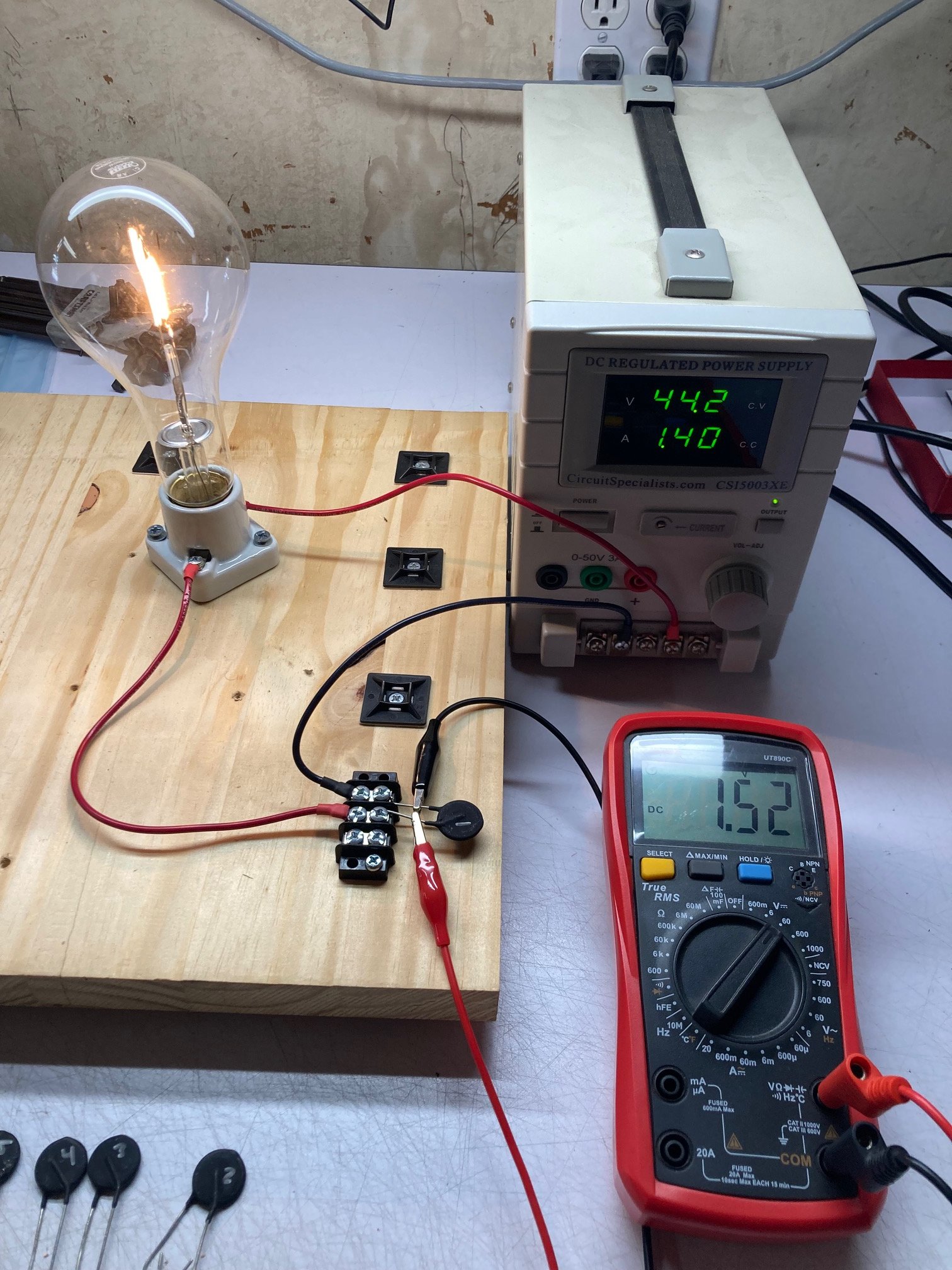

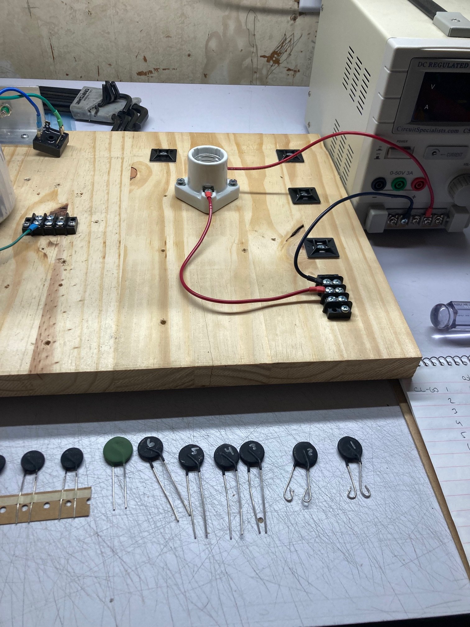

Lol okay, so I went & did it.
A 300W incandescent bulb in series with a 10 Ohm thermistor is just about perfect to draw 1A with 25V DC applied. To draw 1.4A takes 44V.
Readings at steady state where the voltage drop across the thermistor is more or less stable* were pretty tight across six Amphenol CL-60 devices. At 1A the drop varied from 1.53V to 1.60V (same in Ohms), at 1.4A it varied from 1.41V to 1.51V (hot resistance of 1.007 Ohms to 1.078 Ohms). There are two clear matched pairs among this group of six, and two outliers.
Three EPCOS NTC 10s were 1.36V, 1.37V, and 1.30V at 1A, and 1.25V, 1.26V, and 1.20V at 1.4A (hot resistance of 0.892, 0.900, and 0.857 Ohms, respectively).
A single green SCK 108 was 1.7V at 1A, and 1.54V at 1.4A (1.1 Ohms hot).
*drifting periodically both up and down by ~10mV, which is about the limit of resolution for this apparattus & this operator.
I'm probably going to pick 4 of the best hot-matched CL-60s to use in the rails of my F5m. Since I care about DC offsets, I'm planning to closely match the thermistors positive rail to negative rail for each channel, with matching across rails a lower priority. My rails will probably be 200mV lower than they would otherwise be with the EPCOS NTC 10s.

I was hoping there'd be a tell with the resistance at cold for those of us without ready access to 300W incandescent globes, but from your notes it seems to be unrelated. Were they all from the same strip, or just a random collection?
I think I'll just make do with the lucky dip approach and trust that it'll be fine. Not like my ears are a matched pair. 😅
4 of the CL-60s were bought together in a loose bag but who knows what their production relationship was. The NTC 10's were on the same strip.
This would be a painful way to try and make a buck. Honestly this was just satisfying curiosity for me.
